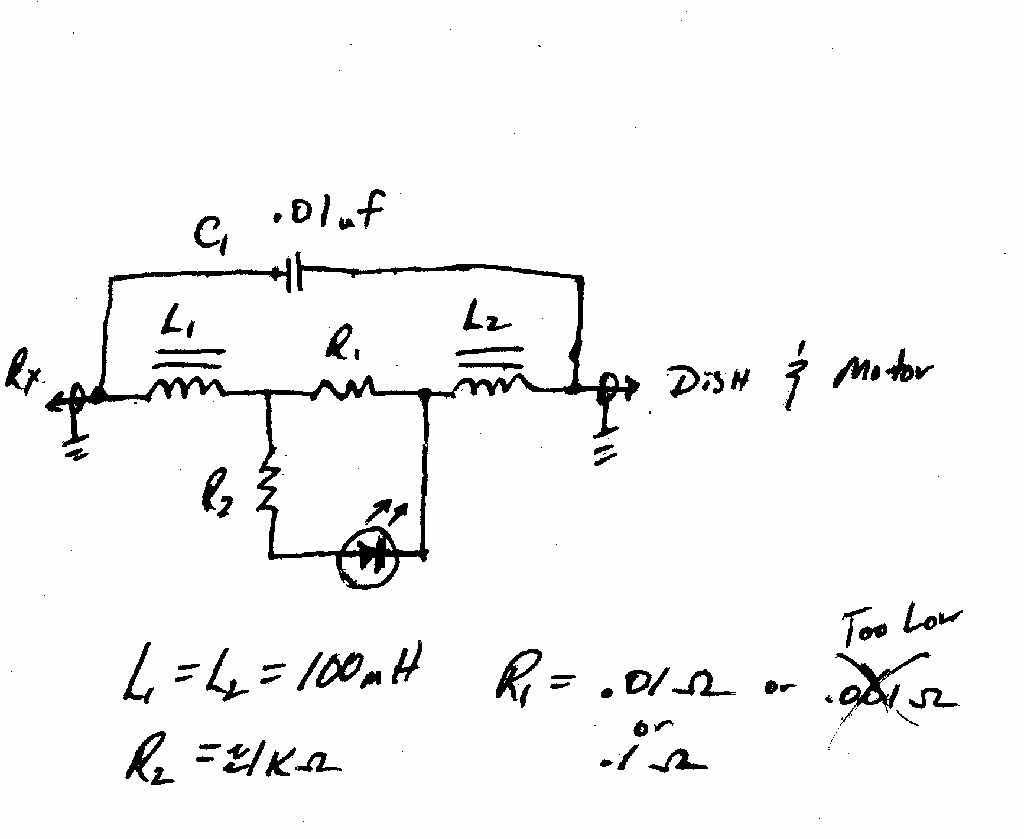

The circuit below should work.
C1 is a bypass capacitor for the RF. L1 and L2 and inductors that will pass the DC but block the RF. R1 is a very low resistance resistor and R2 is a current-limiter to the LED.
As the current increases in the coax, the voltage drop across R1 will increase and cause the LED to emit. You will need to adjust the values of R1 and R2 to get a decent burn, but this should work ok.
You will also be inducing a bit of loss in the line, but if you keep your leads short and build it small enough, I doubt you'll ever notice it.

I don't know if i'm right but : V=RI, so 0.1ohm * 500mA = 0.05V and it takes 1.5V to light a Led, I believe.
Maybe I'm wrong, those theory are far away in my mind, let me know.
You are right, which is why you need to take that small voltage and amplify it. If you detect the change in voltage acoss R1 between motor off and on and then turn the LED on above a predetermined threshold voltage you will have a motor moving indicator.
Correct, that is why you will need to try different values for R1, but don't get too high a value or your motor may not operate properly. Besides, I am betting the motor may pull more than 500 mils, but I'm not sure. I was thinking more in the range of an one amp or more.
I may scratch one together just for kicks and see what values to use, but I have a different motor than you do.
Also you want to choose L1 and L2 with the current capacity of at least thee times the total circuit current to be sure they don't go up in smoke.
NOTE: I just looked at my motor's specs and it only pulls in the range of 150 mils!
In this case, you may have to add a transistor to turn on an LED supplied by the normal drive voltage. I'll re-draw the schematic tonight if I get time and upload that. I'd really like to build one forst to see if I could get it to work like this though....

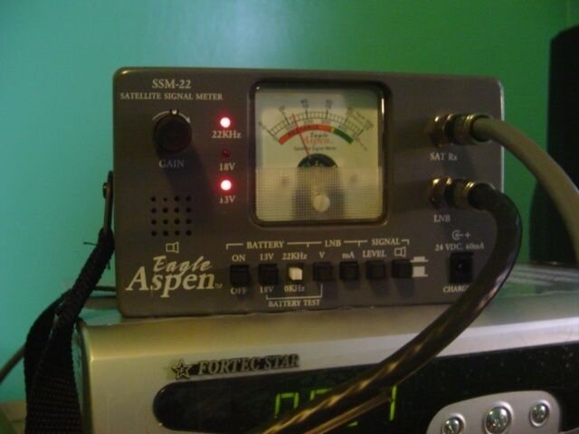

Why not just use a signal meter set to read LNB currrent?
When the motor moves the current goes up.....
Even my cheap-o Sat Buddy can read LNB current.
Cascade said:
Don't knock the SSM22! they're fantastic meters :)
Wasnt knocking it...
I was talking about another meter I have called a Sat Buddy. Its small and only really works right for DBS stuff. But they can take a beating like nothing else.
SSM22's are nice but drop them off a roof once or twice and they are all done :D
