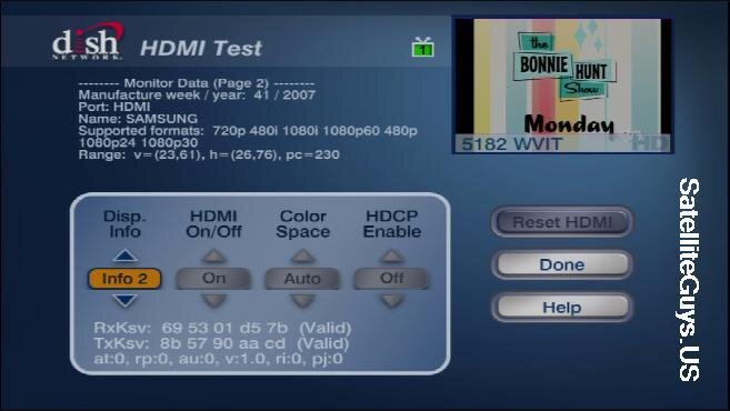

Here is the information from the HDMI test on the 722k.
Wow! They changed it to dsplay the all the supported formats ... Never knew that ... For what it is worth I display the same with my LG.
is it important that all supported formats be listed in this screen?
i have an XBR6 and would think 1080p be listed, but it is not.
thank you
bruce
If it isn't listed it likely isn't going to work. It is strange that all 3 1080p formats are listed for Scott's TV and it still doesn't work.
