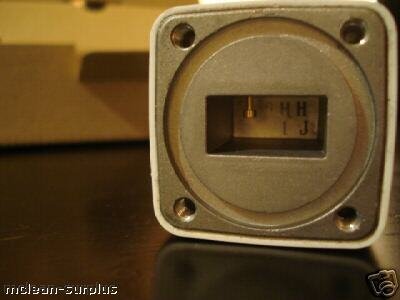

a picture
I found a photo of the inside of one but this is a JRC not Cal amp
could this be what he means whe he says switchable?? ?
that little pin sticking out inside is the probe
i've never tried to move one but i know your not supposed to touch it with you fingers cause your body oils will make it corrode.
i don't know if the probe is hard wired in or if it moves and has another slot / pin hole like mentioned.
