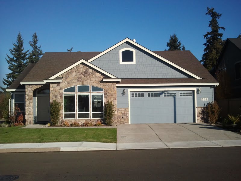

Attached is a picture of our house that we built within the last year (CC&Rs say no dish visible from the street).
SO the window above the garage (attic) is acrylic with dish behind it. Works great!:)
Bob
Pics or it didn't happen! lol
Either that house is on a turntable, or it's much larger than it looks, along with the window.
The window has a 1000.2 WA Dish Network dish - hitting 110, 119, 129. House faces almost due south, with our Longitude of 123W it works very well. I will see if I can get a picture of the dish - need lots of sun because it is in an unlit attic - with only the light through the darkened acrylic. Just for the doubting Thomases!
I have Three more dishes - 90 CM (97W) on back roof, 1.2 meter in back yard on motor and 1.2 meter fixed on 103W in fenced side yard - I will take pictures of all. Had architect lower the roof by 4 feet so the dishes could have LOS from back of house. I pulled in over 2,500 feet of coax and Cat 5 cable, with 4 coax jacks and 2 LAN jacks in each room. Plus the wifi for the Rokus.
