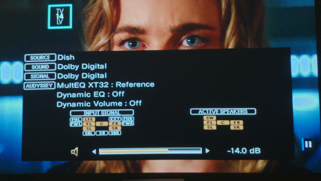

Can anyone confirm that KCRG 9.3 CW as of late is essentially only mixing the center channel, and the surround left channel?
And surround left appears to be a copy of the center channel.
It was working without issue, until sometime last week.
I can't imagine that this is something on my end.
It seems to only happen during the show itself.
When a commercial or a network promo is running, it seems to be fine.
It also doesn't seem to do it on any other channel that I've checked.
For example, SyFy works OK, and I get sound from the correct speakers, including the surround ones.
Using any other source, like Blu-Ray or PC also works OK.
Turning off Dolby on the Hopper3 doesn't seem to make any difference.
My A/V receiver indicates it's getting a 5.1 Dolby signal:
Does anyone else have this?

A number of shows on this channel have had this issue.
Currently I don't have OTA, it's Dish local.
I've had this happened on:

I had a similar problem on my CW in 2016. I emailed the chief engineer and two day later, the problem was fixed. The audio had been that way since the digital conversion in 2009. After seven years, there was finally something on the CW I actually wanted to watch, so I complained. Amazing that no one at the station had bothered to listen to their own air. Or maybe someone did and didn't care.
Reactions: charlesrshell
Seven years is impressive.
I've seen the occasional screw up on the local channels, like a window-boxed picture or things like that, but usually that is fixed within a few hours, or a day at most.
Is the CW a sub channel or a primary? If sub, it's possible someone is not regularly listening to it. It's also possible they're not listening to it in 5.1, but a mixdown. They should notice the VU meters though.
Reactions: Jimbo
It sounds like it just got fixed.
I'm watching Roswell, New Mexico, and the problem was initially there, but stopped after about a minute or two.
No, I do not have an antenna, I have the Dish "Local Channels" package.
KCRG 9.3 CW is on channel 020-00.
I don't think 9.2 is included.
Primary. A UHF running at 1000KW. It sounded like it was out of phase somehow. The center channel was mixing into the other channels making the dialogue hard to hear. Also, this was only happening on CW programming. Maybe they only checked it during off network hours.
