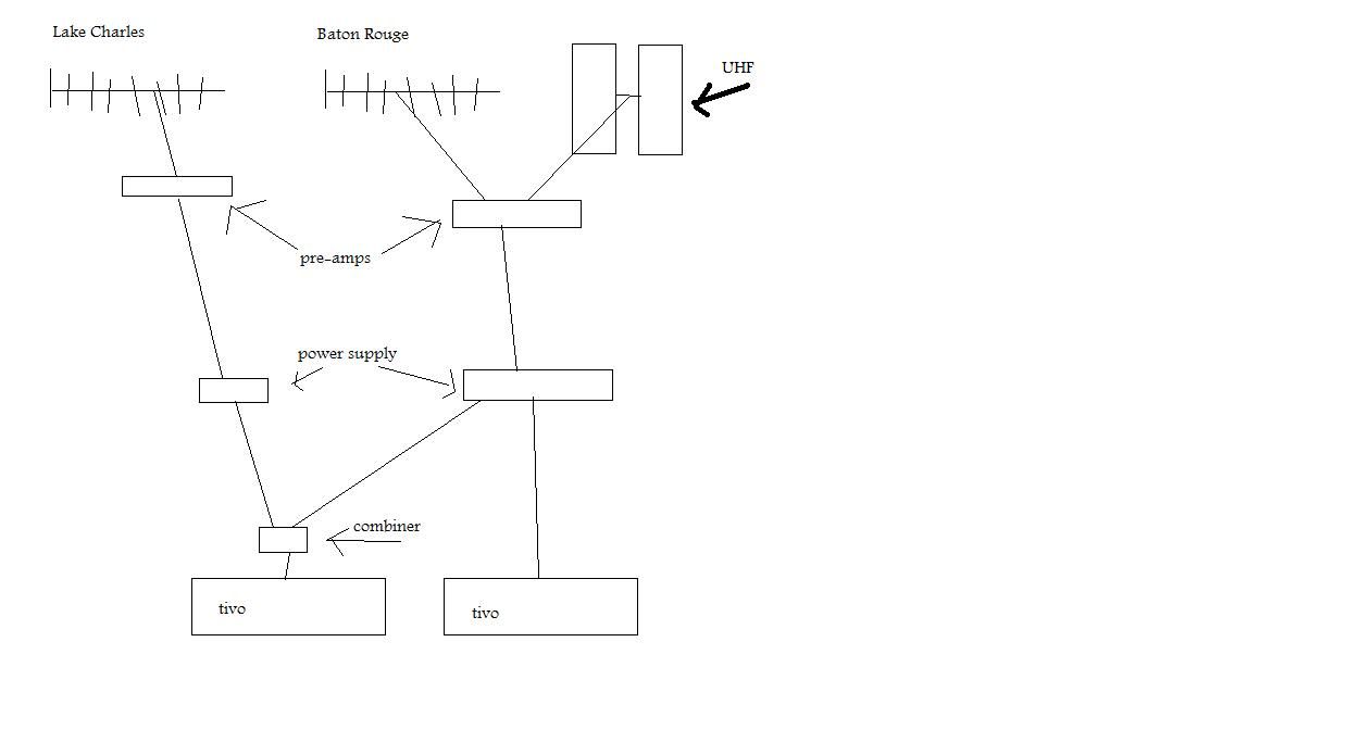

you might have to help me with this but I guess what your saying I could get a smaller vhf antenna or two point both in different directions and connect them together into the pre amp....
in theory (and depending on how complex you want it to get) you can set up multiple band antennas in multiple directions and combine them how you want. Thinking on what you can pick up (and reading your posts) me personally (again this is my opinion...and I have the equipment available already) would set up a VHF only at Lake Charles (KPLC), a VHF at Baton Rouge (the 2 VHF's there) and your existing UHF for the locals and whatever else you can get from BR. Now depending on what you watch more on VHF (the BR stations or KPLC) I would combine that antenna and the UHF into the combiner you have. The other VHF would have its own booster setup. I don't know what you have to record the channels (if anything) but I have 2 Tivo's. So using my equipment as you can see form the (very crude) picture attached one Tivo would get KPLC & the "locals" off UHF. The other Tivo gets Baton Rouge and the "locals" also.
If you only have one recording option you can always put the other antenna directly into the TV or use an A/B switch. Again there is a multitude of options. If you wish to discuss it further, I suggest a new thread (not to derail this one about Justice Network)
