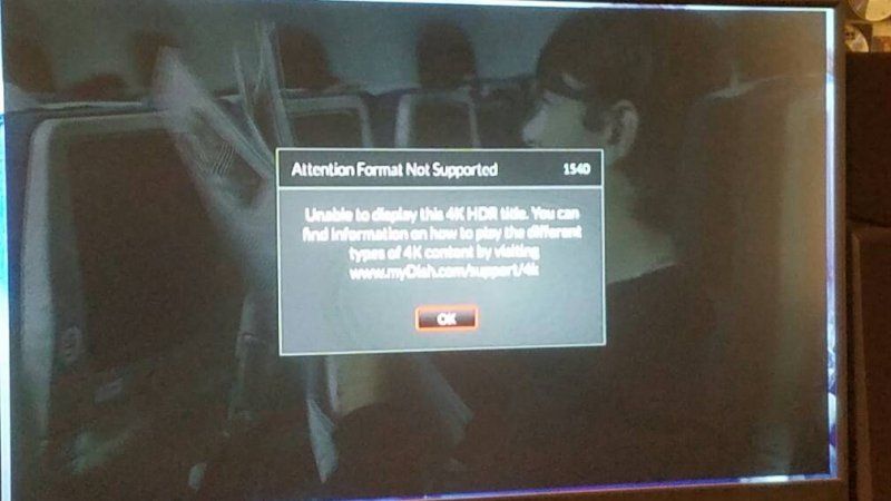

All these 4kHDR H3/J4k error issues are artifically created by Dish software.
I have H3 connected to 1080 tv.
I was able to create a timer for 4kHDR olympic program.
The 4k HDR program shows in dvr.
The program plays from dvr, down-converted on 1080 tv.
Dish superimposed grey window with error message box on top of playing video.
