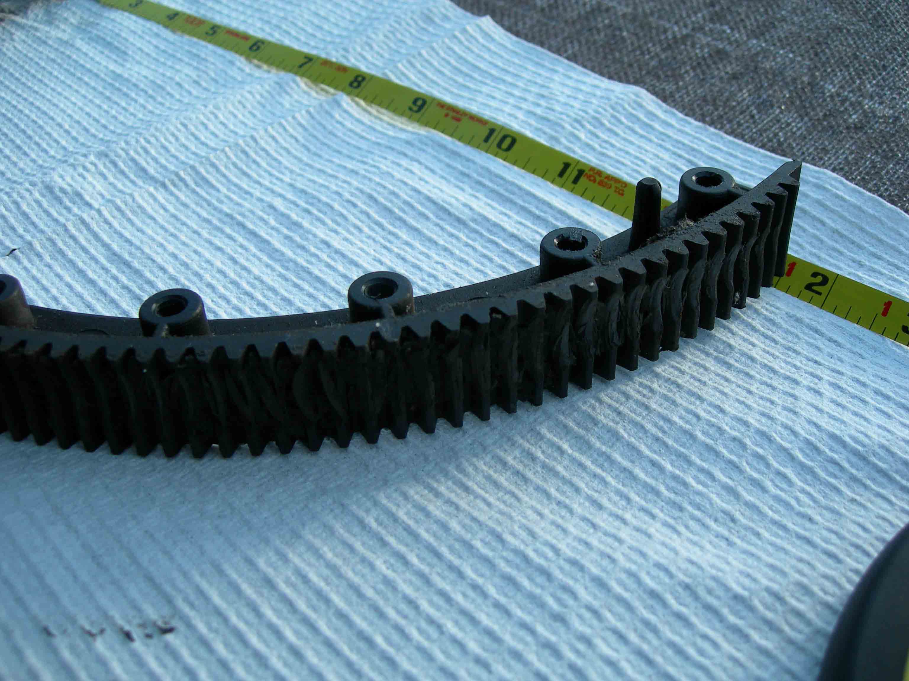

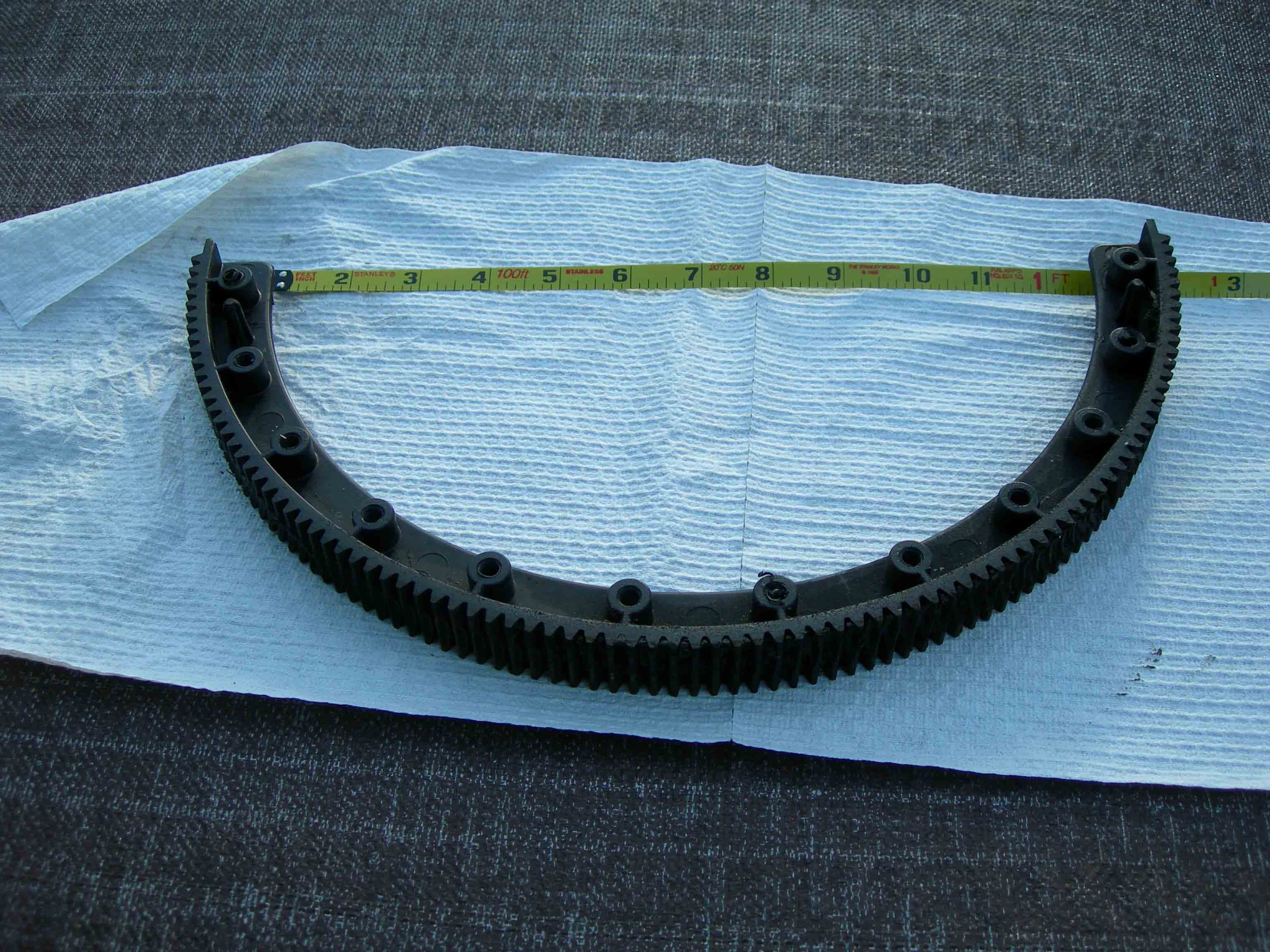

I have a 10' mesh Janeil Dark Star and the spur gear stripped and I have not been able to locate one any where. I took it to a local foundry and they could make one out of aluminum for $1200.00. I couldn't belive it either. If anyone has a lead on the spur gear it would be greatly appreciated.

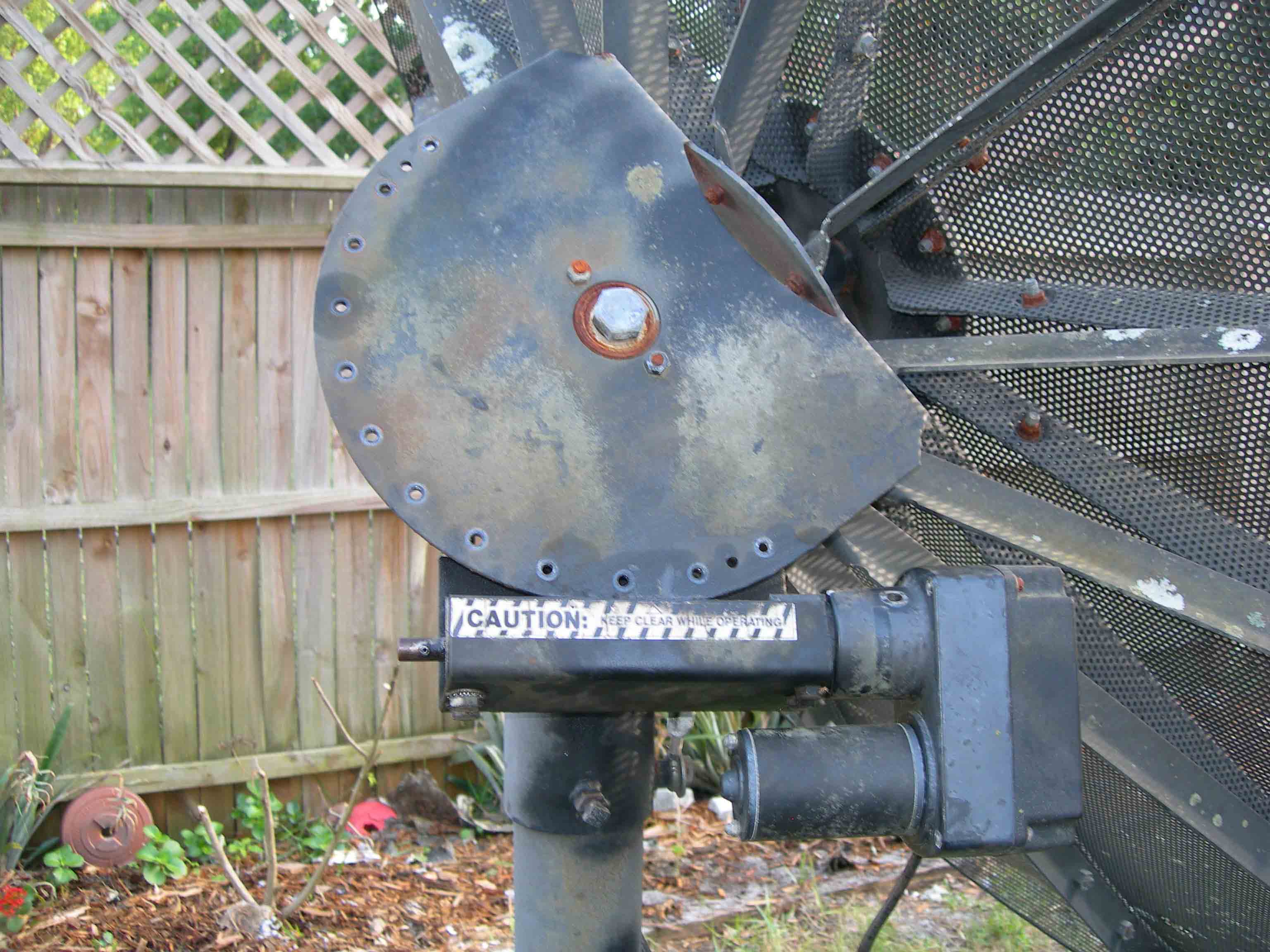

Spur Gear
I hope the photos are ok.

well i think finding parts is going to be tough have you thought about options, maybe taking a flywheel and cutting it in half and bolting the two pieces together.

if the one you have is worn badly a aluminum one won't last very long.

The one with the stripped gears is a black plastic or carbon fiber. I'm not sure but it did last 15 years. I've have not seen anything in my search that I could use to repair it. Thanks, Freddie101

one thing you can consider is a adjustment so the worm drive will hit closer to the sides ( one or the other where the gear teeth are whole) this could probably be done with spacers or washers.
another thing to consider is you might want to check and grease the pivot points of the dish and check the bearings/ bushings. this would allow the dish to move freely. after 15 years a worn bushing might have contributed to the wear of the gear
I have already removed bearings (pivot and worm gear) cleaned and lubricated them. They were not tight and I tried adjusting the worm gear closer. When it nears G1 it slips and the dish hits the ground. That is not a good scene.

I have a Radio Shack Dish that is the exact same mount as pictured. I too had the problem with the spur gear wearing out. There are two things that I was able to do, one I flipped the gear over and cut some spacers for the screw holes to act as stand-offs. This way I was able to use the unworn portion of the gear, I'm able to go from 83w to 137w. I also found a fellow in California who had a few of these dishes, and ordered a spare gear (used) from him. I'll try to remember to check on his name, address and phone number tonight and post it tomorrow.
Freddie, contact Brent at Brent's Technical Services, 133 E. Line St, Bishop CA 93514. Phone 760-873-3688
