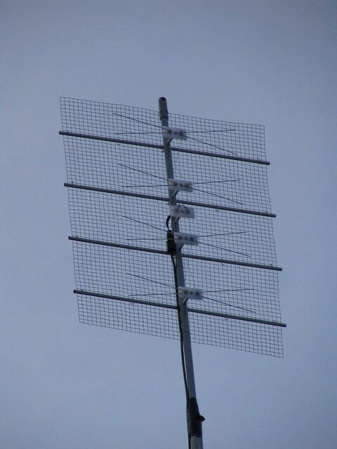

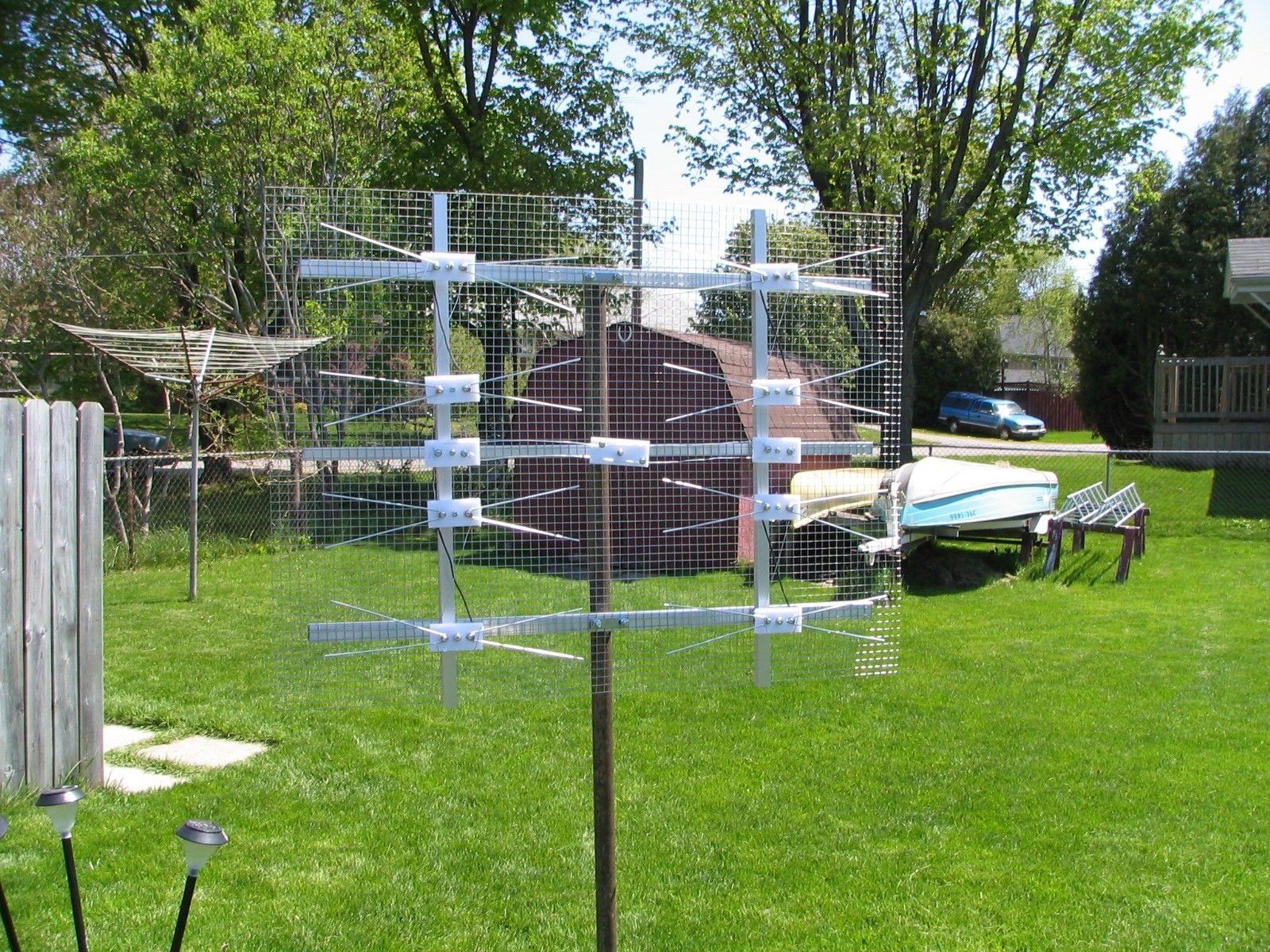

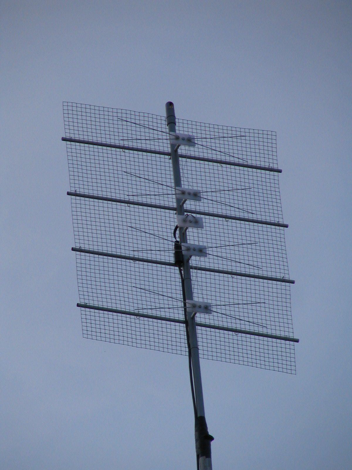

A good project is to make your own antenna. Here is two that I am currently using. The four bay bowtie and eight bay bowtie get about the same signal strength. Theoretically, the eight bay should get 3 db stronger signal. With the eight bay bowtie, I am periodically getting the tube from about 120mi, and RTN11 consistently from about 70mi. I am using a CM7775 pre-amp and it is on the top of a 30' tower with a 10' mast. It still is not above the trees in my area.

Next time someone gets the urge to build their own dish . . .
I'm going to point them to these pictures ! :cool:
You go, Larry ! - :up
