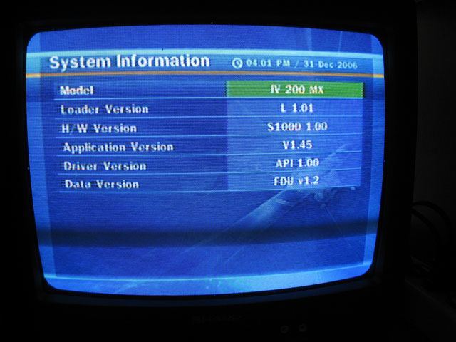

We've updated the firmware using the directions and file found in this thread. I've attached a screen shot. I'm assuming our equipment is now squared away?
We rescanned for all FTA channels and found 143, pretty close to what we had before.
yep looks good
If your husband has ran coax for OTA, then he can do FTA with no problem. Just use good RG6 coax with compression connectors for best results. Lots of wiring info here - http://www.satelliteguys.us/fta-mpeg2-faqs/134124-switch-setups-simplified.html
The Visionsat is a great receiver. The PVR feature works great too. I just use a 16 gig thumb drive for the little bit of recording I do. And as Iceberg said, those signal readings are about right too.

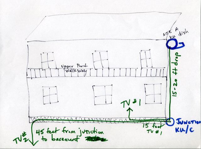

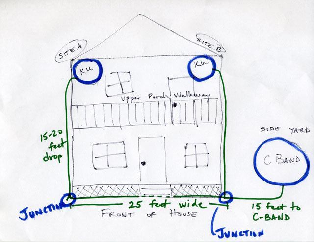

The wiring will have to run outside, under the front and side porch, and must be flexible enough to add a 7 foot C-band dish that's sitting in pieces in our garage. I twisted my husband's arm to pick it up for free late last summer. Knowing nothing about satellite systems yet wanting a happy wife, he said he was more comfortable starting with a Ku size dish on our small suburban lot before tackling the seven footer. Hence the Glorystar maiden voyage of the past week.
I admit venturing into satellite TV is way more important to me right now than it is to him. Frankly, he thinks I've lost my mind.
To keep him happy so the project moves forward, he needs a logical, expandable wiring system that will give a good signal considering how long the wire runs will be as well as eventually powering both the C-band and Ku with motors. We also plan on having a receiver at each TV site.
It is more important to my husband to do it right the first time with correct parts, rather than ripping out and making due as we go along.
The rough sketch diagrams show a C-band dish eventually on the right side of our lot. The Ku dish will be on the second floor. We haven't decided yet on Site A or Site B for its location. Site A has better LOS for satellites falling below 82W and Site B has much easier maintenance access, both upstairs and where we could put a junction box below.
We are hoping we can combine the signals from the Ku and C-band dishes at some sort of junction area before running the RG6 to each TV location.
As I said, we are just starting out on the wiring phase so any suggestions or links to good wiring info are appreciated.

With those distances, you should have no problems with cabling. In most of the PNW one dish with two dual output lnbs on the KU dish will be OK. Not too much wind and good signal path. As the addiction --eerr - HOBBY gets stronger, you will use both A and B as well as ----- OK I have 6 KU dishes set up to run but I do have wind problems. Plan on using switches. Run the cables as if you were going to hook them up. Then buy only the switches you need to use to start. To get started you 'might' want to use one receiver for 2 tvs, but if you want to easiest run, I would go with two receivers, getting the setup going with one, then continuing with the second box.
I can not go to the switches simplified page, but there is a fabulous switch discussion there. Four cables from the KU dish to the Jbox site. Figure on using the switch that comes with the Glorystar setup, maybe get a second one if you need it, or go ahead and get the multi-switch now so you can just add the cabling for receivers 3 thru 8 later. I can not remember how they call out the switches, so I say 4 lnb outputs to 8 receiver inputs. Is that a 4X8 or 8X4 -- I can not remember! 'Nuf for now.
