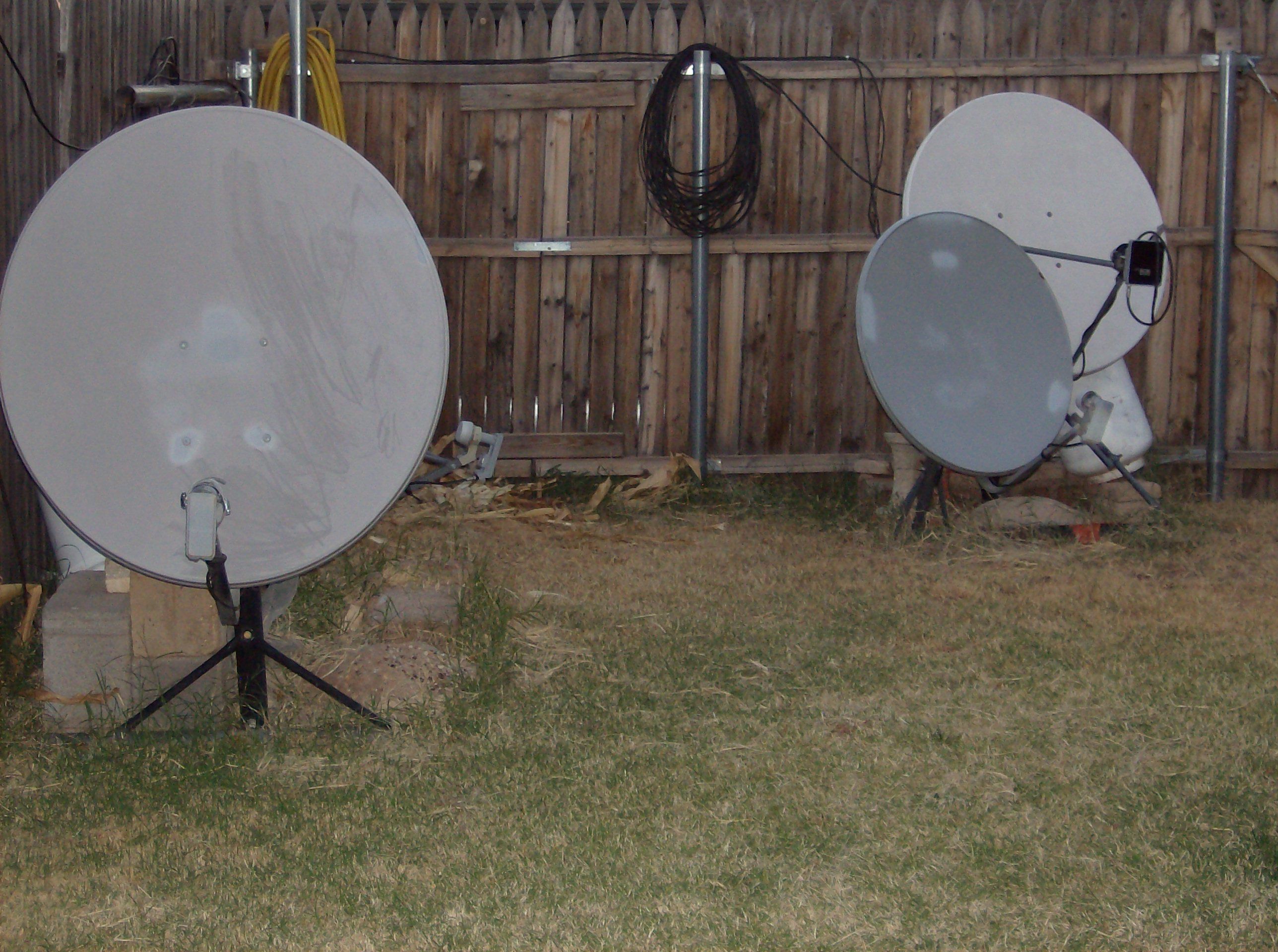

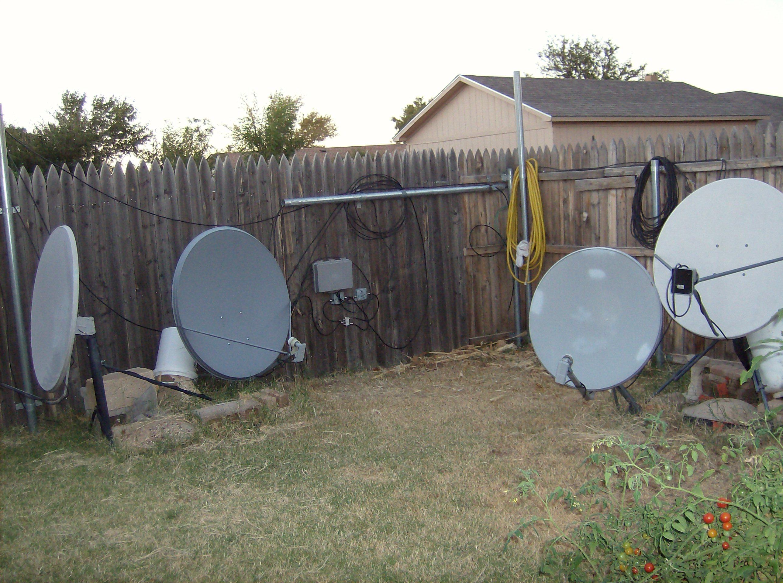

I understand what you are saying, but that is nothing like the system I have. I have a system that is custom built by me. I have 4 dishes that are .9M 61.5, .7M for 110, .9M for 119 (now w/ the 118.7 2 sat. FSS LNB) and .9M on 129. For my system it will be best for me to have the 118.7 split and go into 2 DP-21's. Then those 2 outputs go to the DVR inputs. Here are pictures of my system previous to clamping the 118.7 FSS/119 DBS combo LNB in place on the .9M dish. Tomorrow I will take pictures of the present set up.

Here is the dish set up I have. I have included a couple pictures I just took. I put the 2nd DP-21 in today, but still having error issues. I either have a bad diplexer, wire, or will need the HFS-2. It may be that the 4 way LNB split is the problem and I will need to order the HFS-2. 4 Dish setup w. 118.7-119 LNB 001.JPG4 Dish setup w. 118.7-119 LNB 002.JPG

Here is the dish set up I have. I have included a couple pictures I just took. I put the 2nd DP-21 in today, but still having error issues. I either have a bad diplexer, wire, or will need the HFS-2. It may be that the 4 way LNB split is the problem and I will need to order the HFS-2.View attachment 91604View attachment 91605
Where is that left cable of the left DP21 coming from? Hard to tell from the pic. Also, don't see any connection from the left DP21's receiver output to anything?
