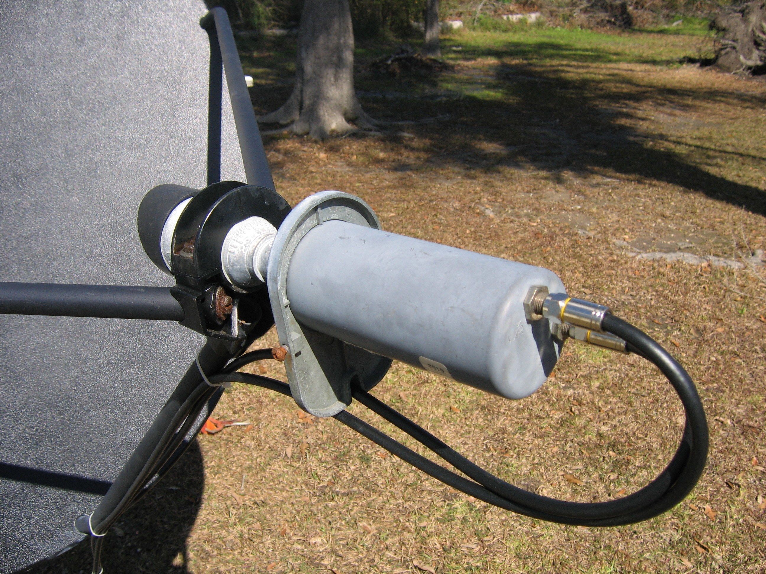

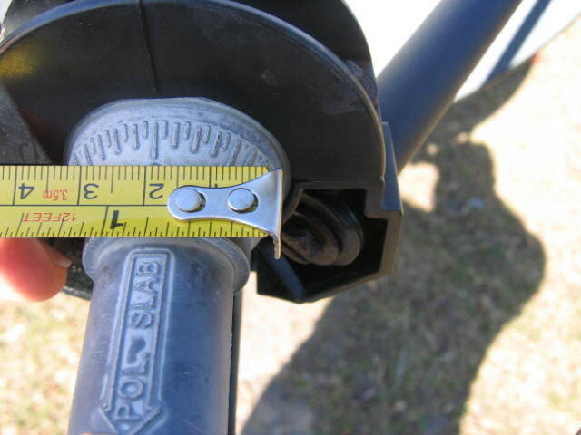

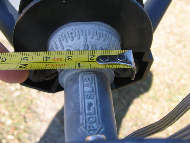

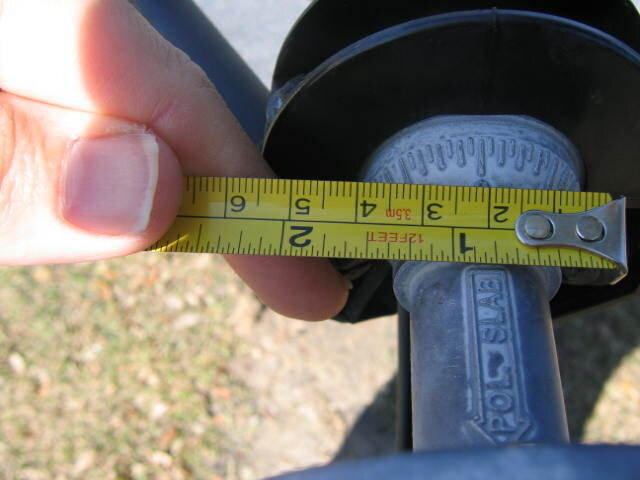

Will the Invacom Quad LNB fit my P* 1m dish? Best I can figure out it has a 40mm neck, my P* dish does too, I was just wondering if it had enough fore/aft adjustment for focal length.:confused:
I want to be able to do CP/LP on one dish easily and from what I've read on here that's the way to do it. :)
I thought the Primestar dish was a 25mm neck. I know to add a LNB to the Primestar, I cracked the casing behind the eye of the LNB to fit in there perfectly
40mm, no?

I know on my Primestar (40x30" dish) where it says pol slab on your LNB is where the LNB would sit in the groove, which is 25mm.

I attached a pic...sorry for the size...
no problem about the size. I can blow it up :)
Where the LNB is right now in the picture is a 40mm so yes an Invacom will fit in there
yes it will fit perfectly (size wise)
now where i don't know if it is perfect at is the FD/ FL , i would like to test mine ( warmer weather) i have it pushed all the way (out) and think it could use a bit more but i get good signals just don't think they are peak signals.
it was discussed in another thread about using the QPF-031 and the feedhorn from the primstar 1 meter to get a peak performance. i would have to buy a QPF-031 to test the theory ..... but i haven't been able to test yet. but like i said the the QPH 031 gets a good signal.

The feedhorn for the (mostly) round dish is just that, round. My oval P*'s, however, have the goofy looking feedhorn that you speak of. I think if I were to get an Invacom for the oval dish I would get the one that mates to the P* feedhorn. I don't think the round dish has an odd shaped feedhorn, hell I could be wrong though seeing's how the dish isn't really round but egg-shaped.

Stogie, if you have the original feedhorn for that dish (which you do judging from the pics), I'd go with the QPF version of the Quad. Should be a perfect match :)

I have a 1 meter Primestar dish with a tripod lnb holder. My Invacom .3 LNB has a 40 mm neck that fits good! I pulled the LNB back from the dish until the eyehead ouches the lnb bracket.
