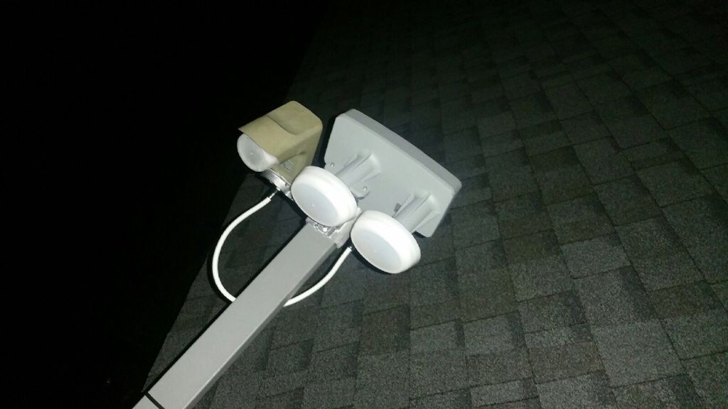

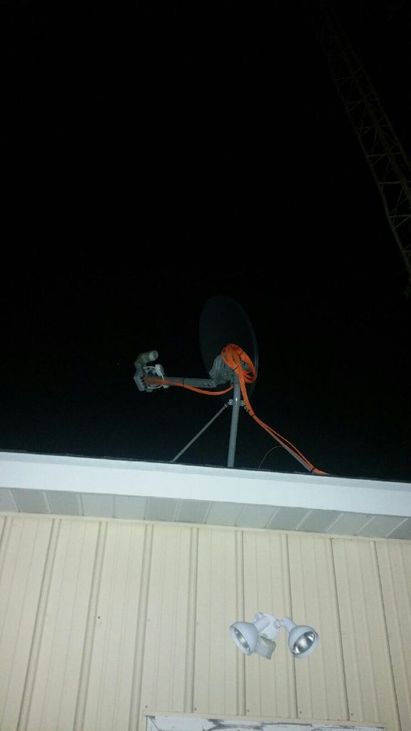

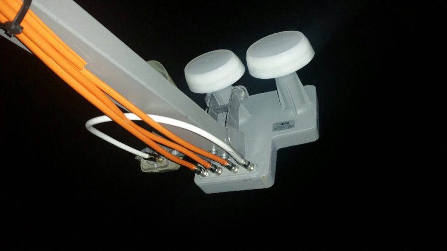

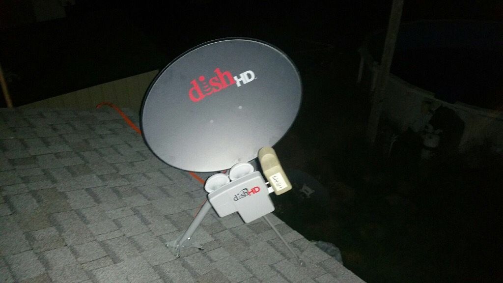

Here's what they installed. Would I be able to run the three cables from the dish to a DPP44 switch and use the 4th port on switch for 61.5 so I can get my locals back in HD?
Is that how the 1000+ is assembled these days? Rather messy looking if you ask me. And I disapprove of the bright orange cables, one of which seems to be cut. If you don't need 4 outputs, you don't need to fiddle with a DPP44.
Anyhow, it does not appear you are on EA any longer.
Those don't look like WA LNBs. Looks like a EA lnb with the 118.7, but hmm. Interesting. What satellites do you currently have??
That's gotta be the new 1000+ LNB arrangement with a combined 118/119 eye and also separate 110, with 129 being carried by that extra solo or dual (can't see a second output) on the white cable going to the input on the twin or whatever it's called. This can't be a 1000.2EA LNB because the EA LNB has no input at all.
Don't worry StarScan, all 4 satellites are available from any of those 3 outputs because of that internal switch. There is no need for a DPP44.
I'm wanting to add a DPP 44 so I can hopefully get 110, 118, 119, 129, and 61.5. My HD locals are on 61.5
You are having the same issue when I joined Dish in 2007. I too needed five birds to receive all channels I wanted but Dish did not have a switch to handle five inputs. So I had to run with a 1000+ dish with a side 500 dish and left 129 disconnected. Since then Dish rearranged channels so I can now get all the channels I want without the side dish.
You need a EA dish for 61.5 and 72 and a separate dish for 118, looks like the installer was trying to get away without putting up another dish, but if your HD locals are 61.5 only, he should have mounted another dish.

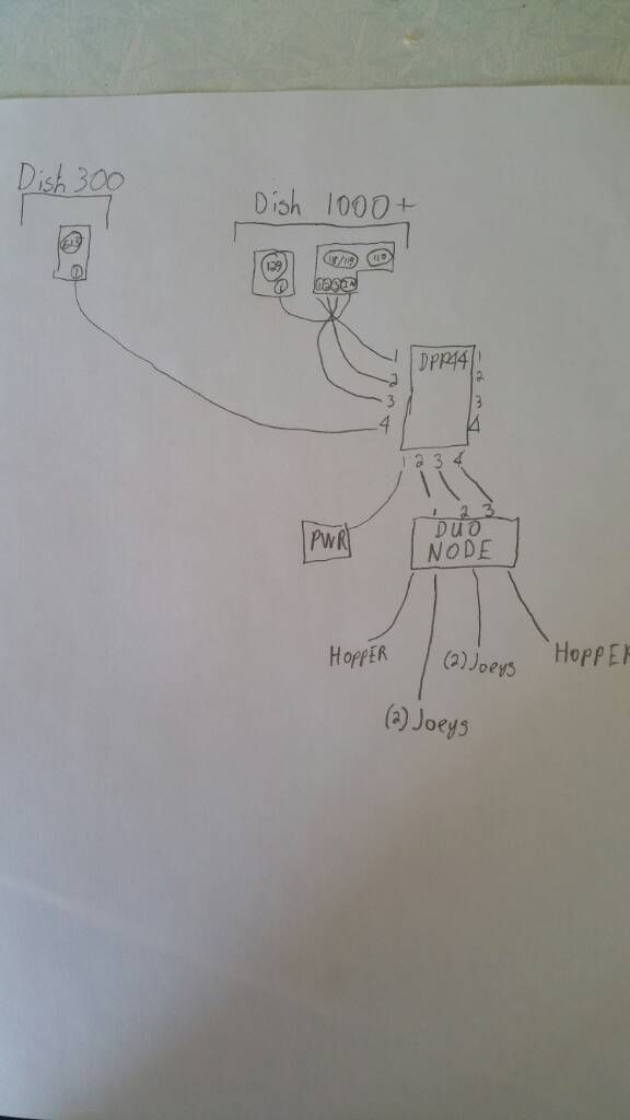

Could i do something like this?
No. You can't get 5 satellites through a DPP44. I have seen some crazy ways of getting 5 satellites, but I don't remember how that is done and I'm dubious that it will work as input for a node.
That may be, but it turns off the internal switch in that LNB that handles 110/119/118 and 129 via the white cable. You want to cable a 5th LNB on 61.5 into your DPP44. I'm pretty sure that, if you cable it up as per your drawing, you will not see 129 any more.
