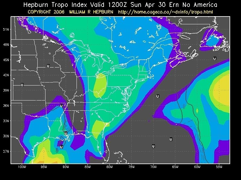

could be a combination of ducting (poor today there) and the moisture in the air from yesterday's rain.
ducting is going to be good here the next few days.

my guess is the ducting is minimal today and there is water vapour left in the air from yesterday ...will probably be better tonight and the ducting increases this week

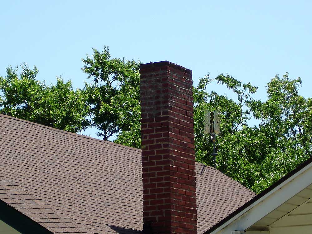

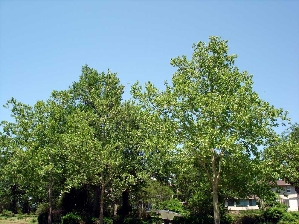

Here's some pix. The middle of the picture with the trees on it, shows exactly where the 91 XG shoots through. This probably is the biggest problem I have with my reception. The chimney shouldn't be that much of a problem, since the antenna is almost 3 feet higher up. I don't wanna get any higher, as the trees are still too tall. I would require a 80 feet tower to make a difference. So that means to me that equipment wise, it's probably as good as it gets.
