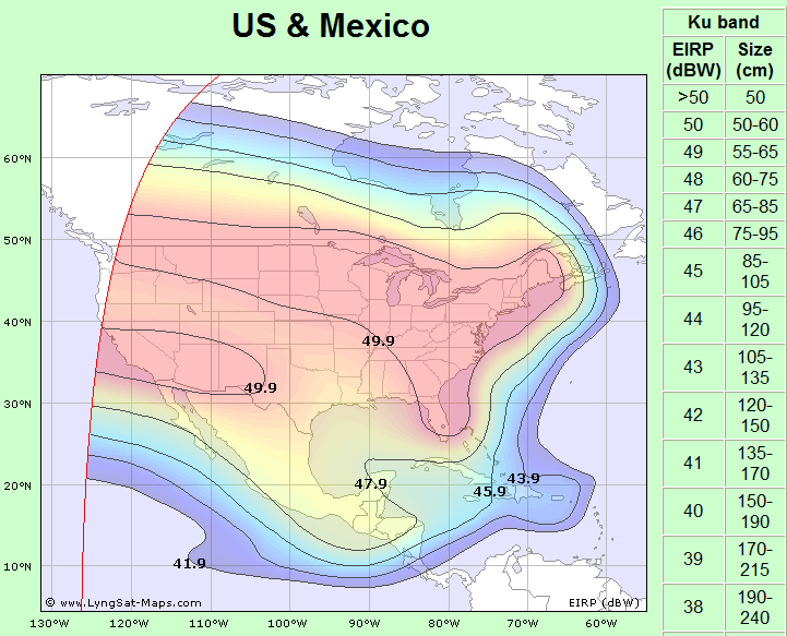

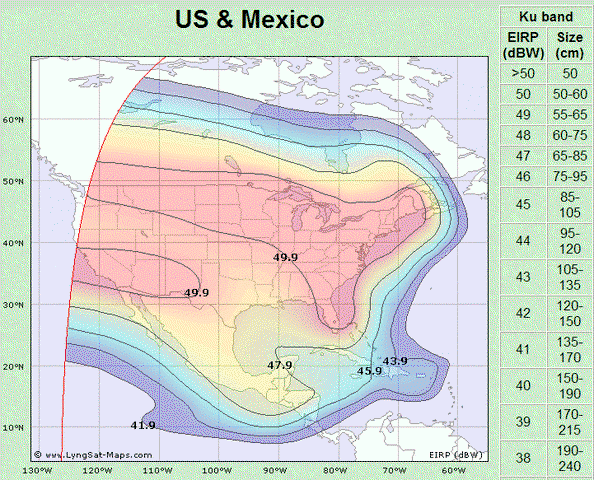

Iceberg,
See the attached map for the signal from 45.0W Intelsat 1R, Ku TP 11.629 H (Pueblovision Canal 36).
If a person can trust Lyngsat EIRP charts then I am near the 49.9 dBW contour where it crosses the NE/IA border so I should be able to detect it, but I don't have a universal LNBF and even if I try to fool the system, it won't pick up any signal.
