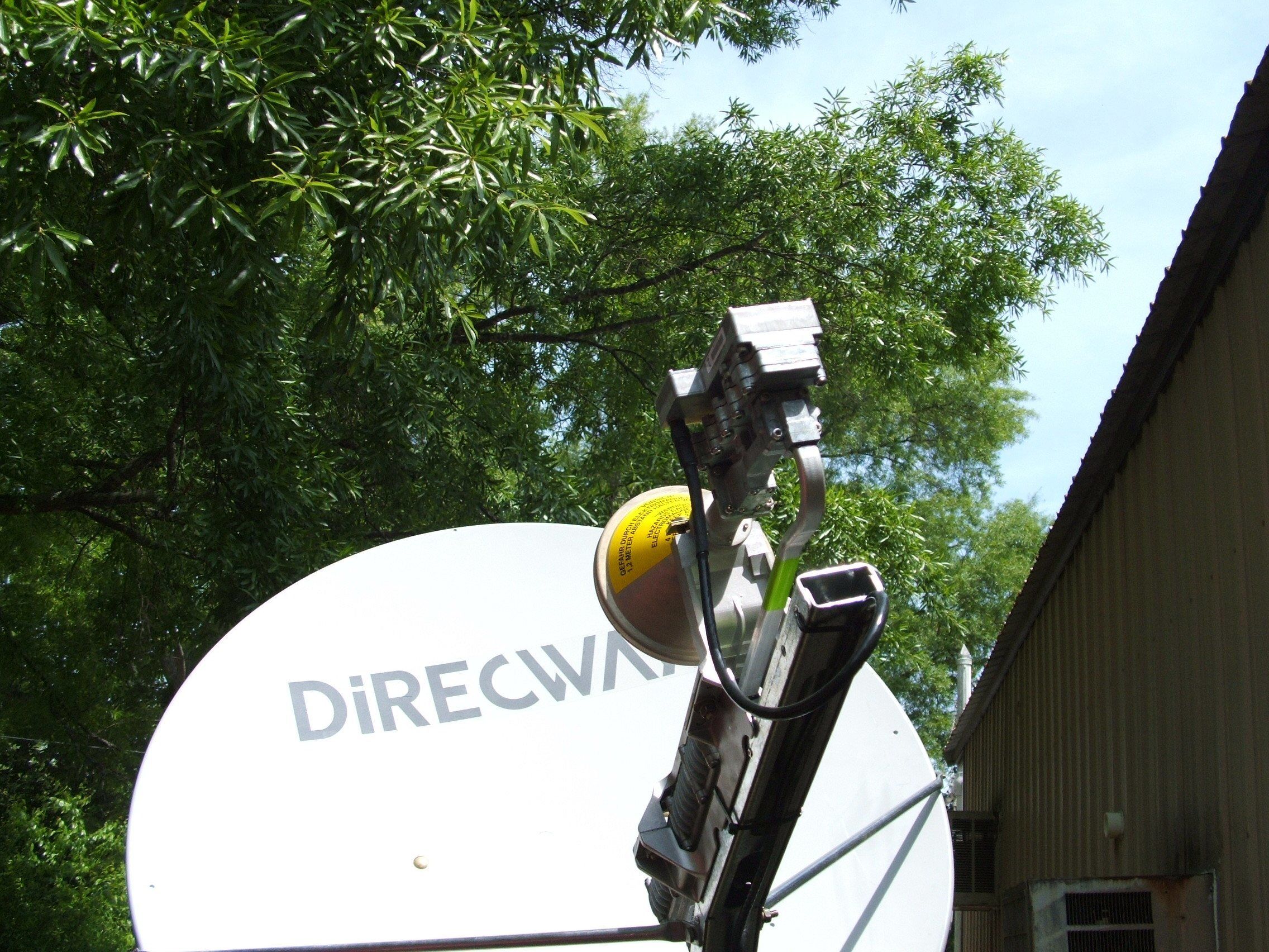

got rained out on wed... installed today...piece of cake....got an 80 rcv and a 75 cpol
very nice.
I love those .98 dishes but only get to do 1 or 2 a month.
Even with my Enterprise jobs for Cendent Corp. uses a .74 dish that is SP upgradable.
