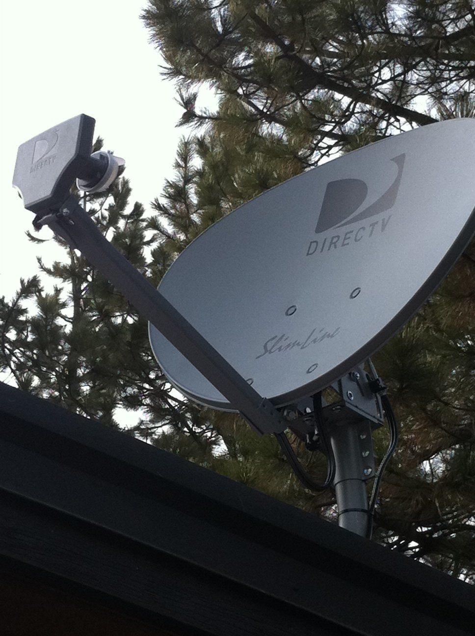

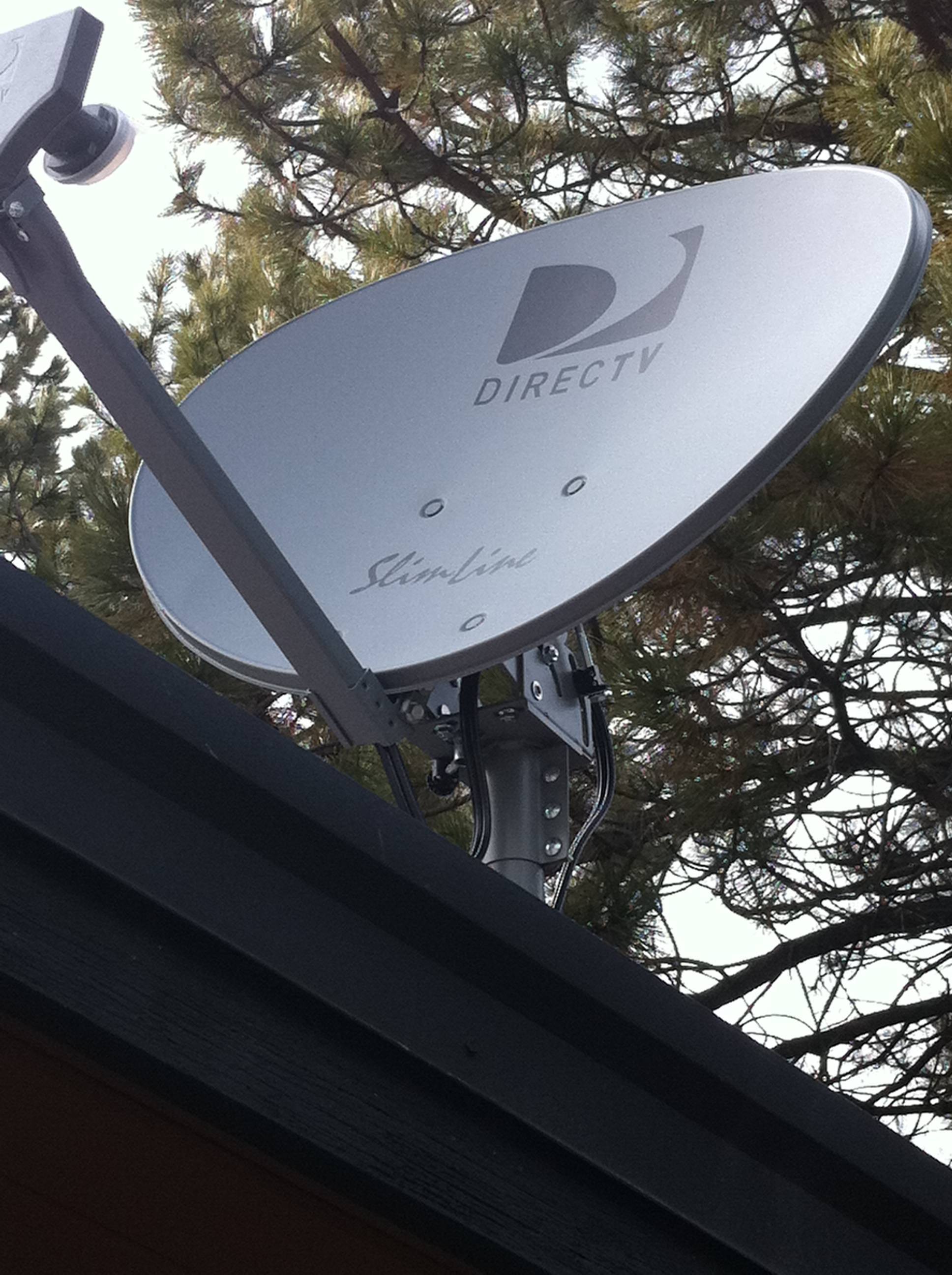

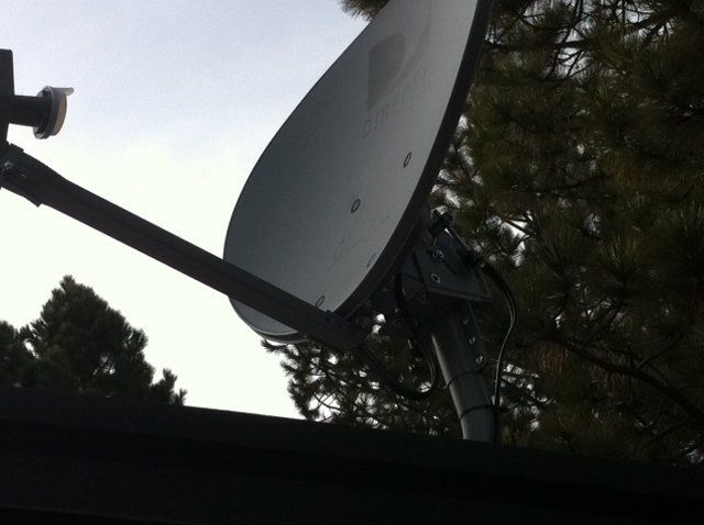

Here's a sl3 swim
Here's the older one non swim

Just double checked and it's the older non swm

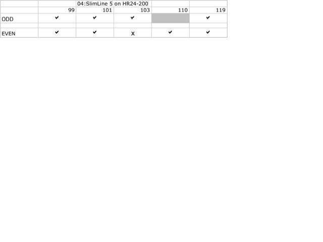

Ok, just got the HR24, it does not have an active access card, on set up for 04:SlimLine 5 the following satellites are showing, note the 110 degree Odd box has no symbol, just grey in color. 103 degree even is X all other boxes with the exception of 110 has check marks.
