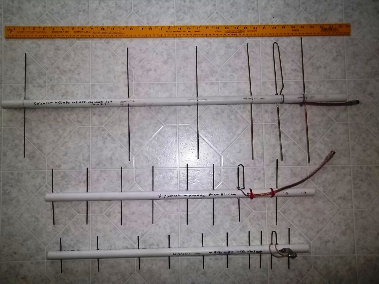

At work in my cubicle I have some home brew antennas and other electronics trinkets such as LNBs, tubes, old radio parts - the staff has written me off as the "weird radio guy." But when we have an emergency drill practice, they appoint me the radio communications officer and know they can count on me to get the job done.
OK, here are some small Yagis I made from plans in the ARRL handbook and from other sources, with a yardstick included in the pic to show the sizes. Top is a 450 MHz 6 el, middle is an 800 MHz 8 el (for 800 MHz police band), and a 950 MHz 10 el for misc. intercepts. Boom is 1/2 inch schedule 40 PVC and elements are made from welding rod. These work well indoors, but bet they would kick butt if outside on a rotor, could probably put all 3 on one mast they are so light.

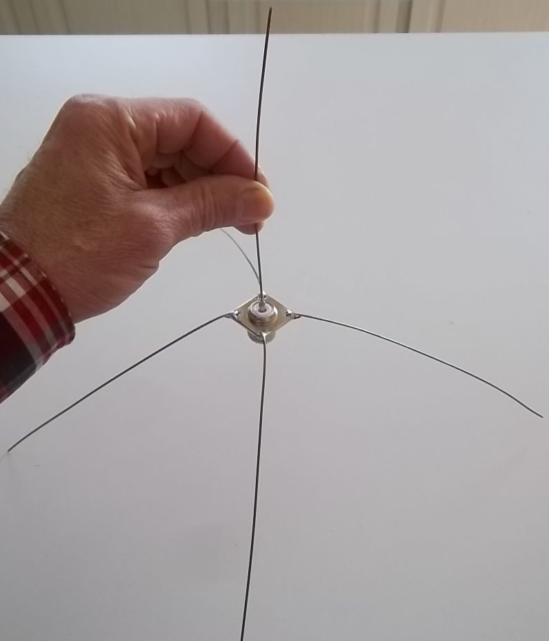

Okay, here's a neat little antenna made for around 465 MHz reception, using copper wire soldered to a chassis mount SO-239 connector. Made this a while back for work and used in the UHF band. Nice and small. You can attach a string to the radiator and hang from the ceiling.
Radiator = 150 mm
Radials = 165 mm

spongella, we call that a "twinky" antenna. :) It's a 1/4 wave vertical at the frequency it's cut for. Will work fine for both transmitting and receiving. You can add other bands to the antenna by soldering different 1/4 wavelength radiators to the center pin; say 150MHz (17") 460MHz (6") and 800MHz (3.5"). You can actually transmit on each band if you want, should match 50 ohms at the right frequency. The radials should be 1/4 wave of the lowest (longest) frequency plus about 3%. Gain is 0 compared to isotropic, but still works good and cost can be almost nill if you have feedline and a solder gun.
