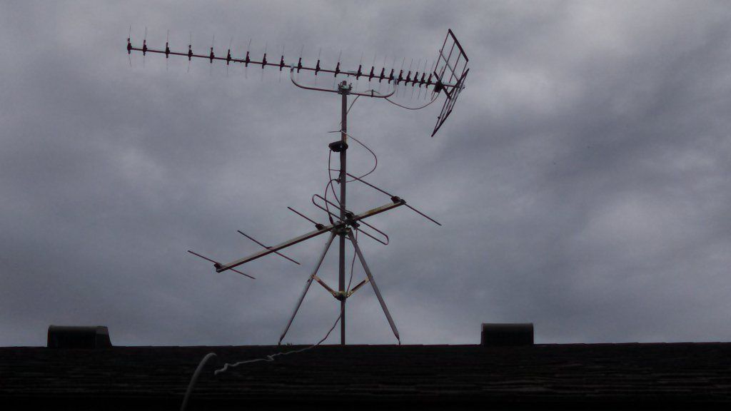

What I ended up doing was running the Digitenna antenna through a pair of FM traps, then to the pre-amp, then to a UHF/VHF combiner where I combine it with the NON-amplified VHF antenna. From there, I connected a cable from my attic that runs down to my basement and connects to a grounding block, then a power inserter for the pre-amp, then to an Antennas Direct distribution amplifier.
All tuners are working well now!
I think my biggest problem was the FM stations overloading the pre-amp, which has now been resolved by using the FM traps on the Digitenna and by not running the VHF antenna through the pre-amp at all. I do think there may also some amount of interaction occurring between the 2 antennas with them being so close together, but that doesn't appear to be negatively impacting anything with the way I have everything setup now so I'm not going to worry about it.
