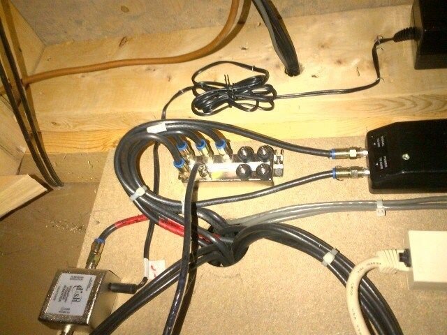

I see a lot of different answers/solutions on the web, it seems people have this setup so differently.
I'm including some attachments of pics so you can see exactly what I have to make this as easy as possible.
1 pic is my swm8 switch

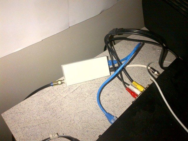

1 pic is the white deca adapter which has my feed from the swm8 and then gets plugged in to each reciever with ethernet.

You've got it right. Thats a wired CCK. It feeds the internet connection from the router into the Coax. EDIT: Wired, because it's connected to the router via an ethernet cable rather than wirelessly.
The DECA's that are connected to the receivers (they should each have one, if not, directv will send them to you for free), allow the receiver to pick up the network communications off the coax cables.
I'm guessing you have Whole Home service right now, which is why you have the DECA's (Whole Home allows the receivers to share recordings).
If you don't have everything to make DECA work, you can go the all-Ethernet route with a decent Ethernet switch.
DECA's biggest selling point is that it doesn't require DIRECTV's professional installers to possess a low-voltage networking license to install it.

Apparently you gathered the wrong information from this exchange. If you choose to go DECA, you MUST have a CCK to connect to your conventional LAN unless you have a Genie. DECA and Ethernet cannot be active on the receivers at the same time.
Since it was confirmed above that the wired CCK kit I gave a link for is the right model for my application, I figure it would just be the most efficient way to do this and would allow me to use the ethernet jack I have in my receiver rooms for something else.
With the exception of the Genie, connecting the receivers via DECA does NOT allow use of the Ethernet ports for other things. It is one or the other. With the HR24, the Ethernet port is literally disabled when DECA is active and using the second Ethernet port on models that have one has never been recommended.
Apparently you gathered the wrong information from this exchange. If you choose to go DECA, you MUST have a CCK to connect to your conventional LAN unless you have a Genie. DECA and Ethernet cannot be active on the receivers at the same time.With the exception of the Genie, connecting the receivers via DECA does NOT allow use of the Ethernet ports for other things. It is one or the other. With the HR24, the Ethernet port is literally disabled when DECA is active and using the second Ethernet port on models that have one has never been recommended.

By the way get rid of that old Dishpro adaptor in your one picture. No one wnats to see that here ... :)
They both do the same thing. I personally like the one on amazon better, just because it is not so convluted when you set it next to a router. The other one is just Directv being cheap so they only have that version now. Basically it's a receiver DECA with a power supply.
Thanks, I agree with your assesment and I ordered the older more router looking broadband connection kit. Although I do like the look of the newer Deca's, sleeker, smaller, black, compared to the white blocks. Anyhow nothing I would swamp my old ones out for, they are hidden anyways.
I'll have to remember to keep the dishpro switch out of any future pics!
