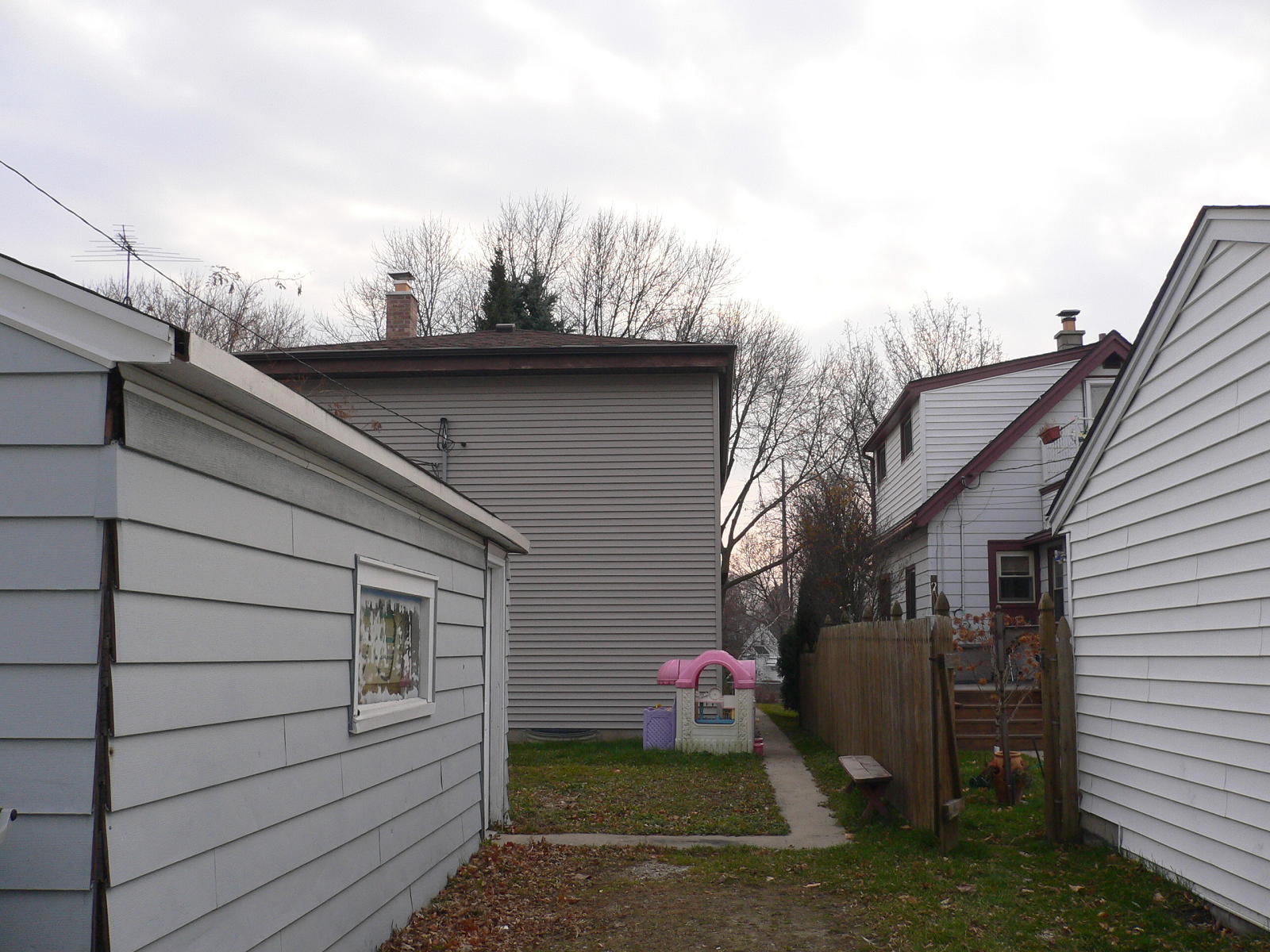

Wow thats one big satellite list, well 1 meter is great for Ku and somewhat affordable after a 90cm (because of shipping costs the best deal in my opinion).
If you can use a compass, you can get a general idea of where your dish will be pointing and please remember elevation, so nows the time to look for a good spot, lookout for trees or buildings that might be in the way, and if you can place in an accesible place just in case you have to fine tune your dish.
I know youre in Milwaukee, but where wauwatosa, west allis, if you can give a Zip Code that would help, then PSB (Moderator) can post a handy list with your correct pointing angles, Hispasat has been a bugger for many here but you should have no problems getting it with a motor as long as your LOS is good.
Is 100cm too small or is it big enough? Can I pick up C-band transmisions?
Yes, I have a compass, I think I know where I am going to install this small dish...
I am in Bay View my zip code is 53207, or about a mile west of Lake Michigan, or few blocks from Oklahoma avenue and Kinnikinnick avenue...

Ok, got a receiver, ordering FORTEC Ku-Band/C-Band Dish - 1.8 meter Prime Focus with polar mount ($239)…
Now does the satellite dish have to point in true south direction…and at what angle does it have to be inclined…I do not have a good place to install this dish…not much of a yard…I need to purchase a 3” o.d. pipe for the poll, not sure how high to make this dish in order to see above the house and trees? Install the dish by the corner of the garage? South is directly looking at the back of the house...and the Barbie house…
