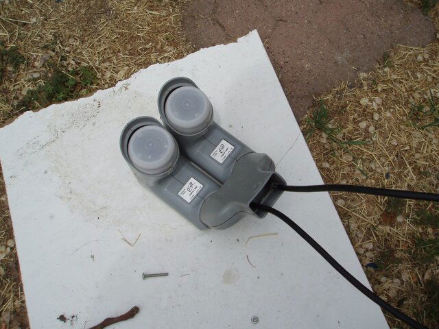

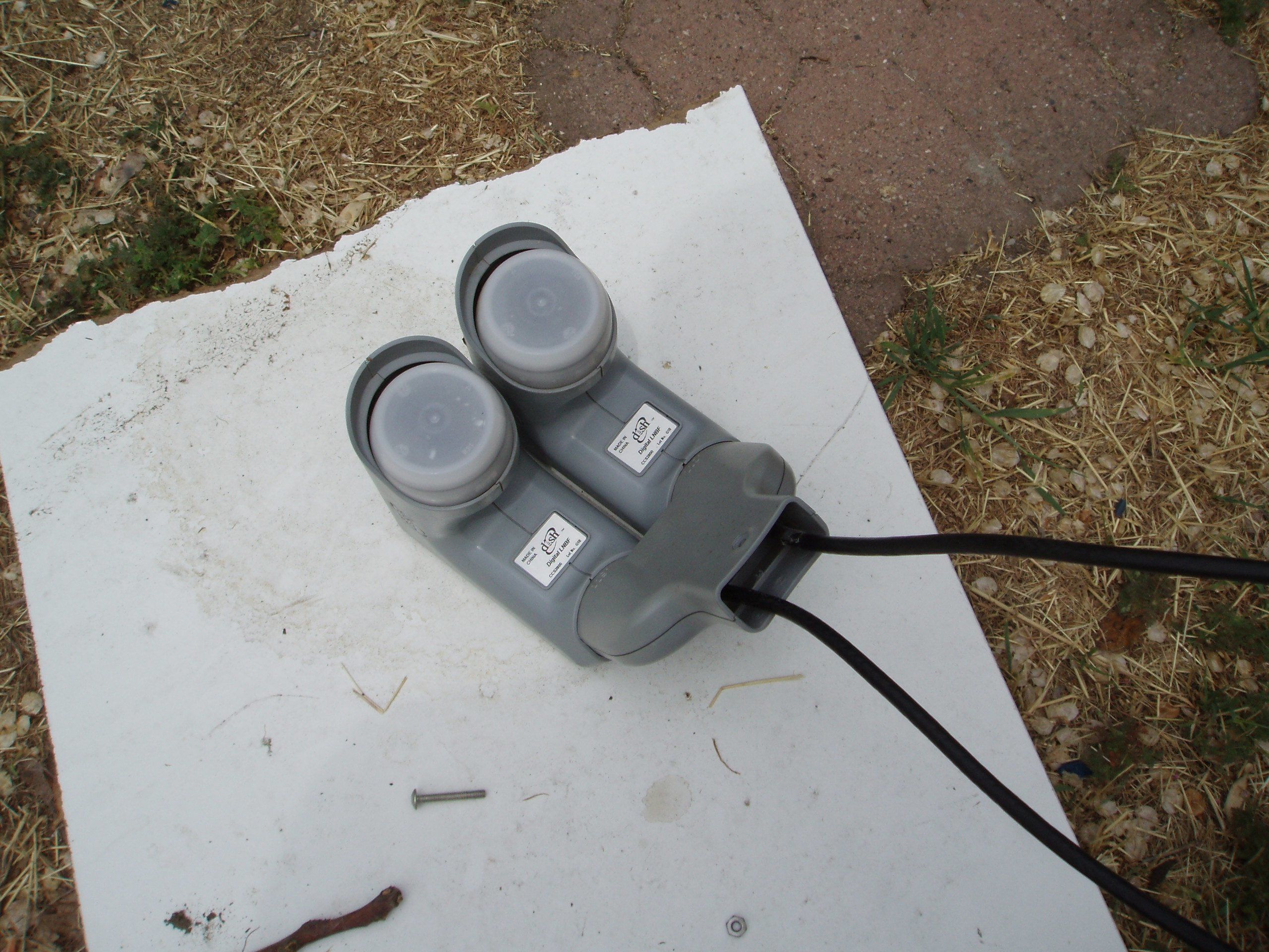

Well i have received my new lnb and guess what? It does the exact same thing that first one did. In other words the first one wasnt bad as you all assured me and now i have two of the same lnb that i cant get to work. The last time i tried this i tried to hit dish 110 just because it has a strong signal. This time i figured that i would try dish 119. This is because it is strong as well and at least has one fta channel that if i was lucky i would be able to see (NASA). Well, here are the pics from what i am trying to do.

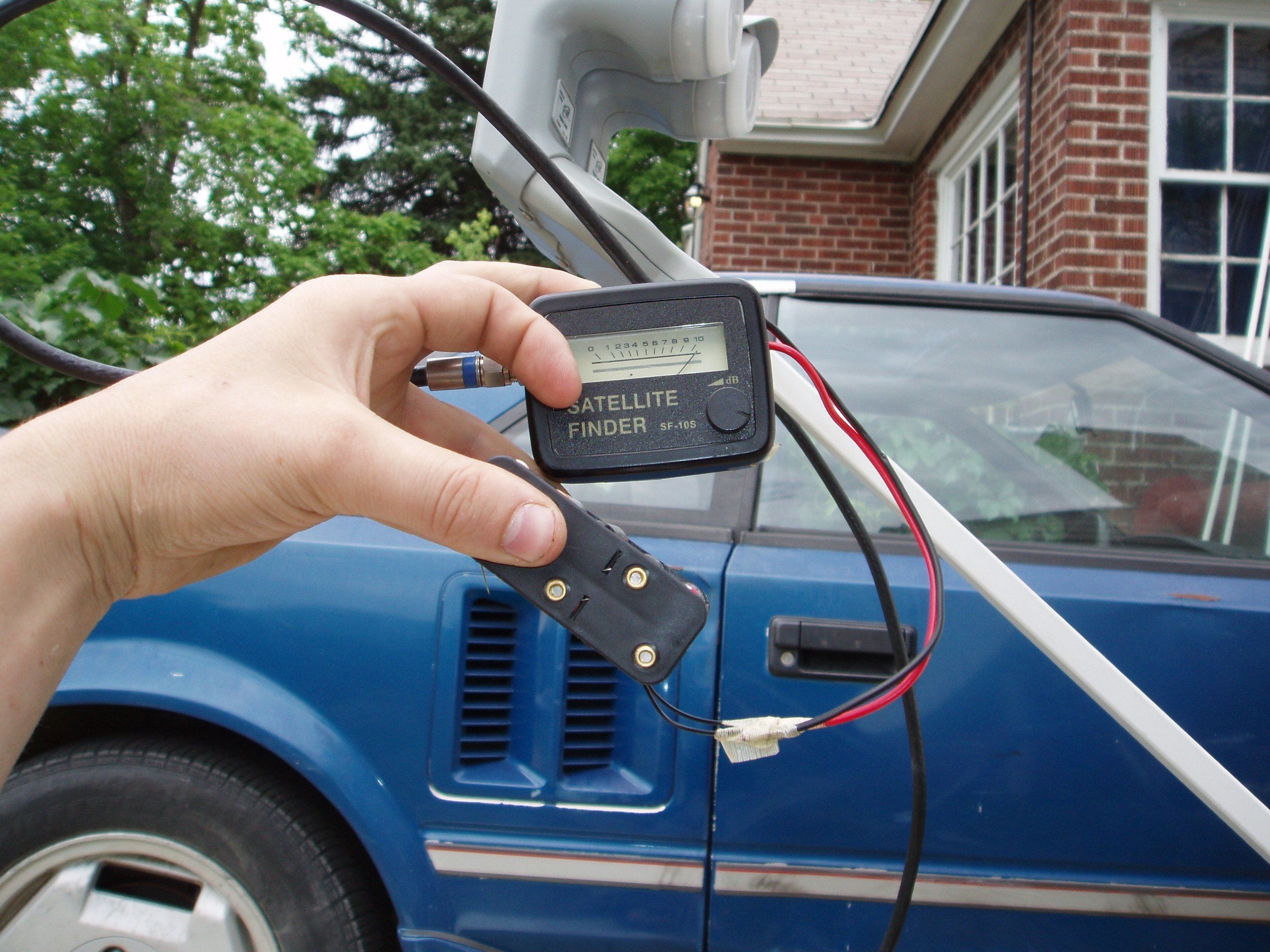

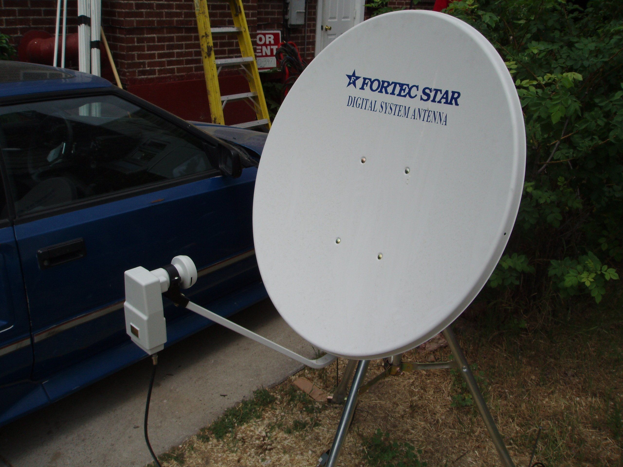

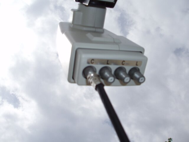

I first hooked up the invacom qph-031 to my dish. I the hooked up to the first circular input on the lnb. no switch or motor.

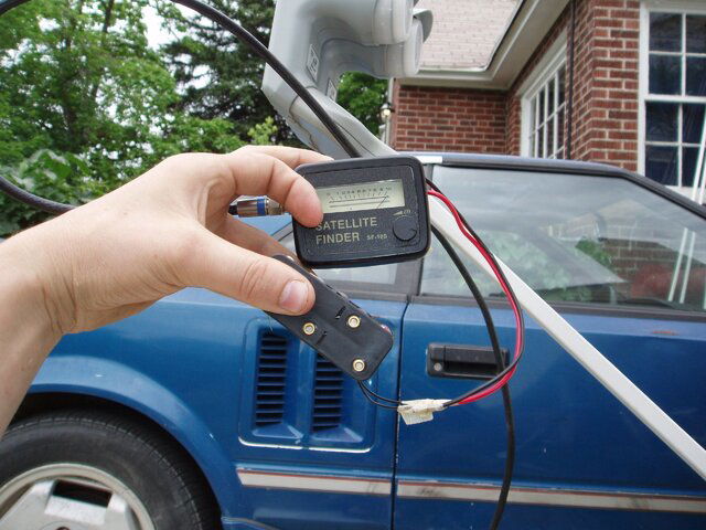

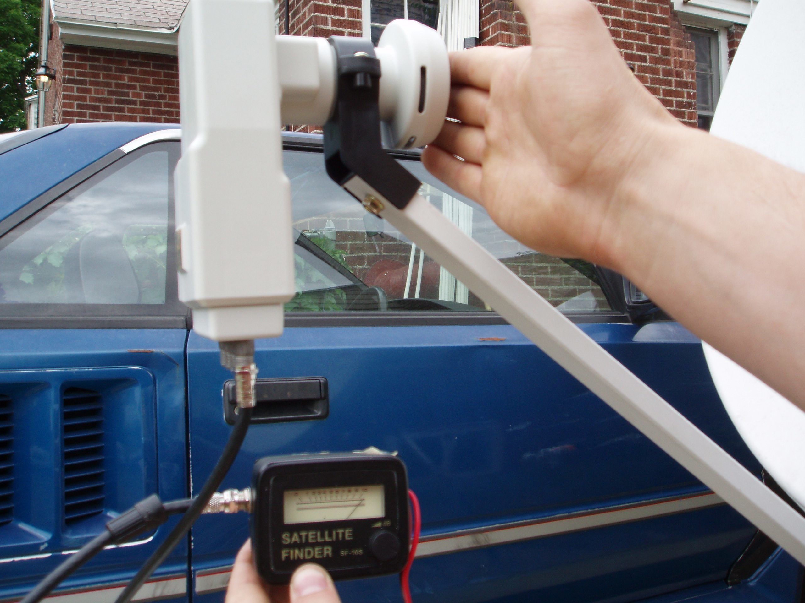

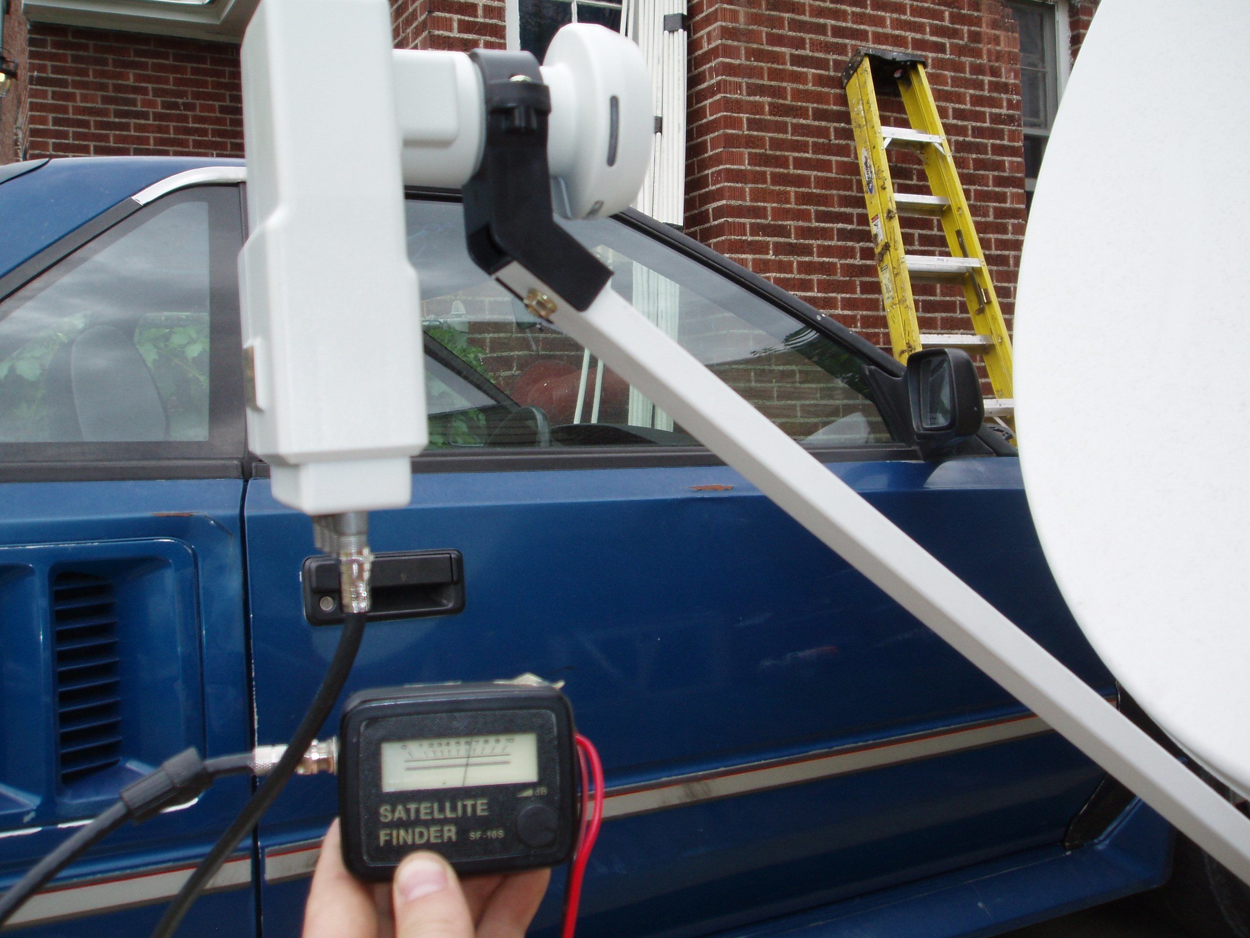

The dish has been previously aimed using some cheap dn lnb i found at a second hand store. When i hook the sat finder up to the lnb i get a constant signal of about 7. This is for any posistion. I can move the dish around like a crazy crazy man and the meter will stay at seven.
In fact the only time it i can get the meter to peak is when i place my hand in front of the feed horn. then it spikes to 10. This shouldnt happen!!!!

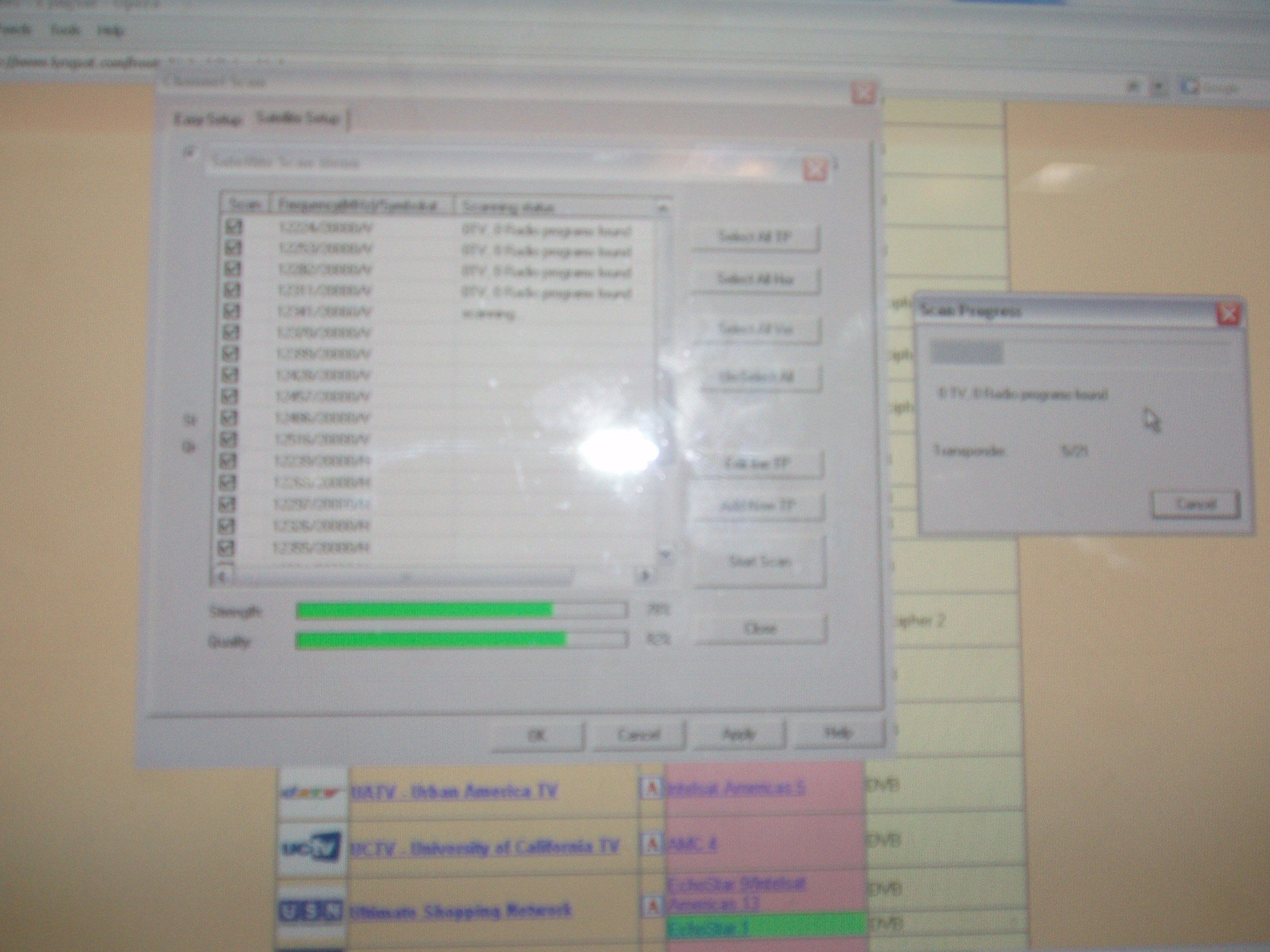

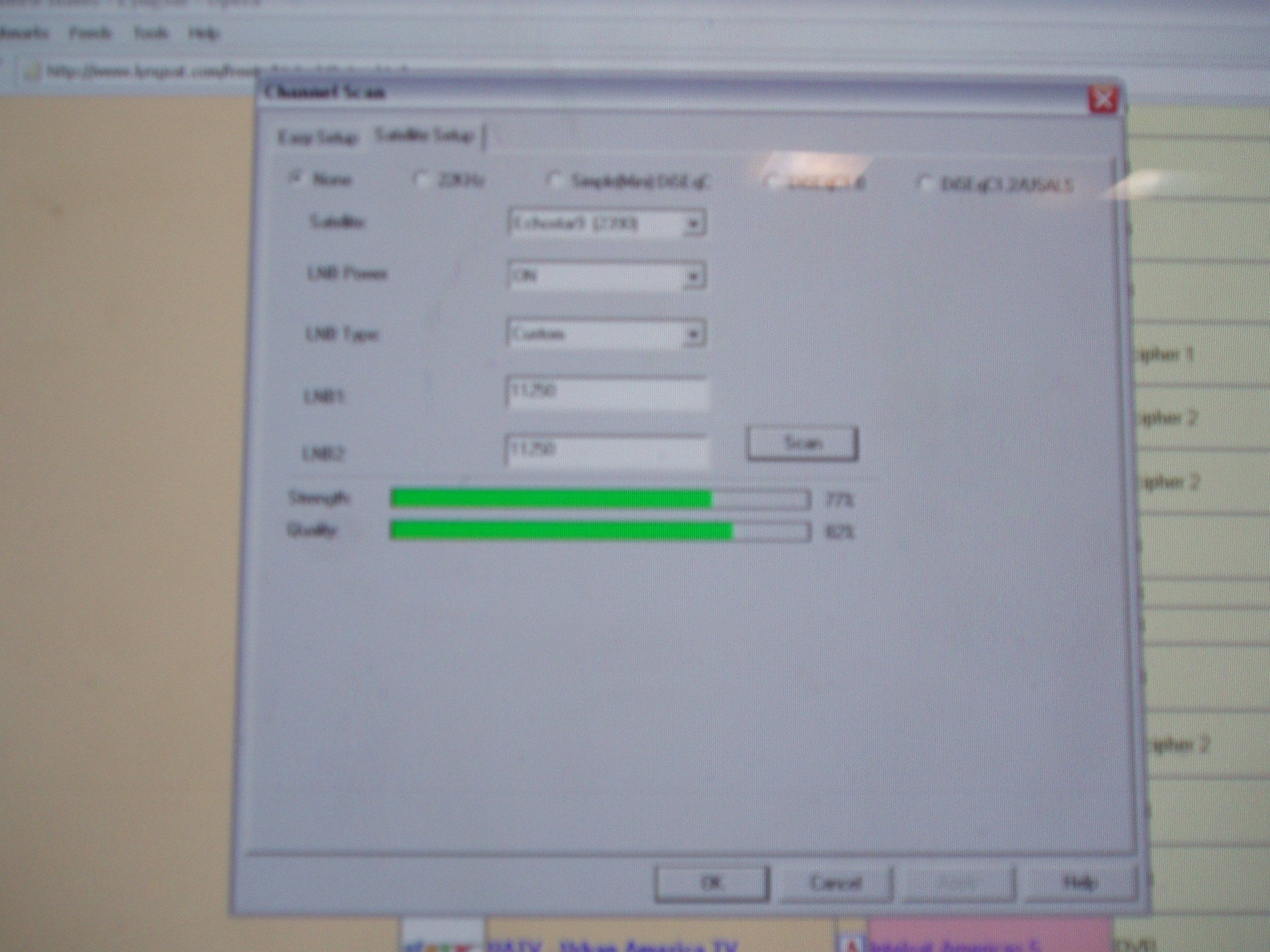

When i try to scan on the previously aimed dish i get nothing. just a bar that says signal strength at 70%. But when i hook up the dn lnb's the meter works and i can now scan.
I dont get anything. But at least i see green and not red. I dont think the twinhan software allows for circular polarity.
This why i am so frusturated! I was hoping to find some international sports feeds to see some world cup games, but to no avail i think that dream is ending. Please anyboy help!!!

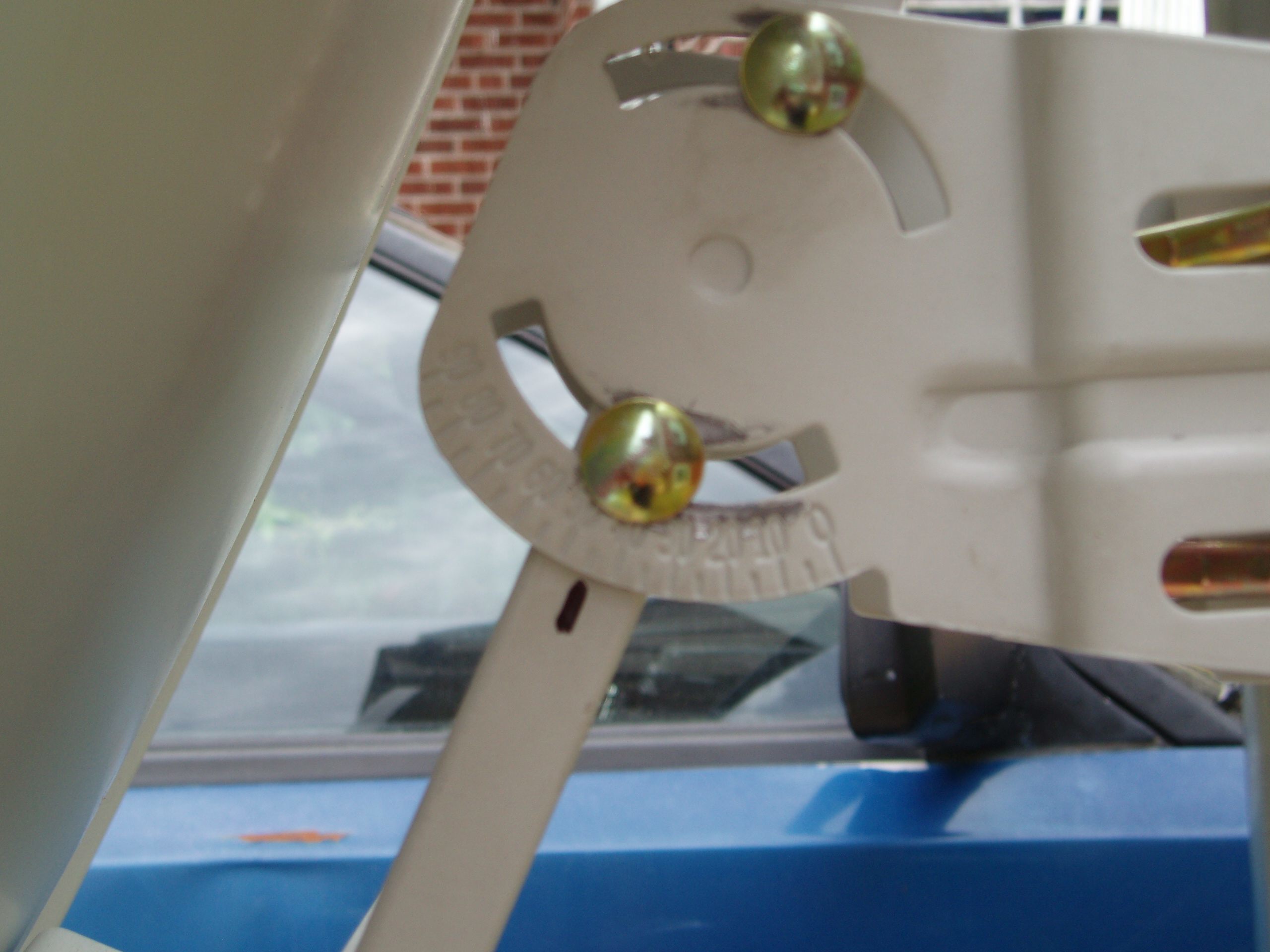

check your dish angle the fortec angle gauge is not accurate my dish angle was suppose to be 24 had to drop it to 19 to receive signal.:)
