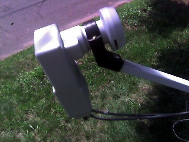

At the show the folks form SatelliteAV gave me a award winning (It won two awards at the Expo!) Invacom Quad Polar LNB's to try out. Now I really needed to have my FTA dish working.

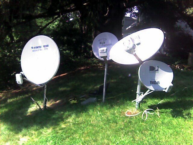

I got back home with it and was waiting to set it up, when the weather was clear I went out and gave it a shot. First I took and old DirecTV dish and mounted it to the base of my SuperDISH and now had a dedicated 61.5 dish.

This morning I contacted the folks from SatelliteAV and immediately got a reply back from Brent who asked me if I set the Linear LNB to STANDARD on the Fortec. I left work and came home and popped off the old LNB and popped the Invacom back on, took the Lifetime Ultra Receiver and my laptop which has a TV tuner outside, plugged it all in went to the setup screen and changed the setting from a Unversal LNB to a Standard and JOY OF JOY I had a GREAT signal off of IA5! I went from a 54 - 60 to a 71 - 80!

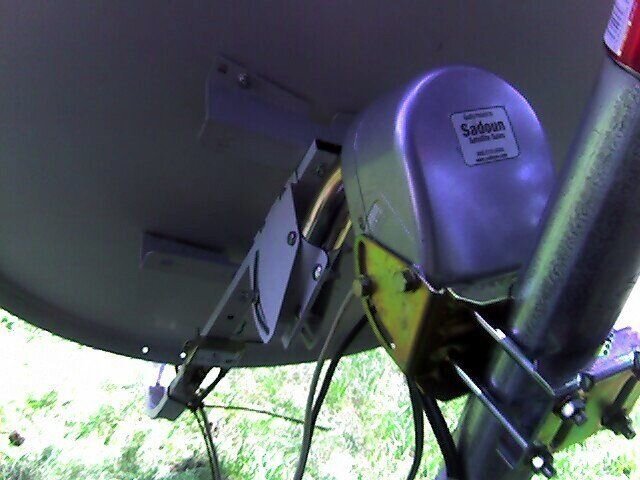

I thought I had it tightened down but the dish had play, so I got out the tools and REALLY tightened it down after I got the strongest signal possible on the satellite I was on. I mean I REALLY tightened it down, now there was no play in it at all.

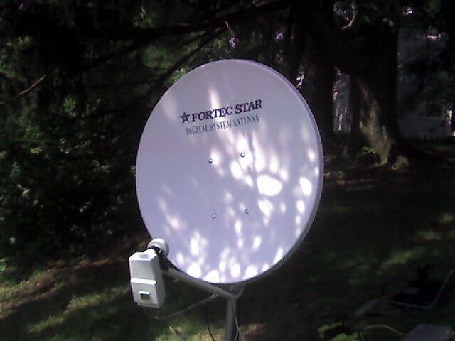

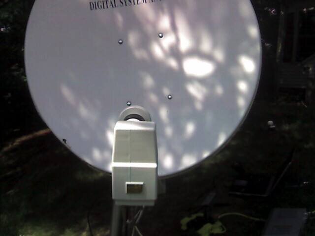

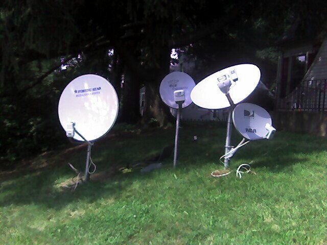

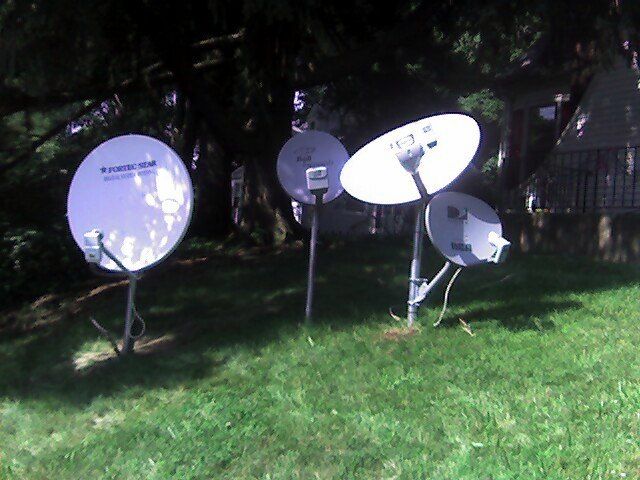

Below are some photos of the setup now with the Invacom LNB setup. You will notice that I have it set to use a Disecq switch. I am able to get the FTA channels off of Dish and ExpressVu. :)

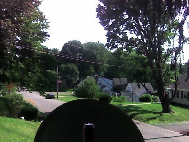

I am very surprised how much of the arc I can see considering whats in the way, I took a photo of the sky from behind the Dish so you could see my view.
Thanks to Pete (PSB) for the great setup and thanks to the guys at SatelliteAV.COM for the excellent LNB!

Nice work Scott! You just can't beat that feeling of accomplishment when you get it all done yourself, the sky is the limit now!
Great pictures of your dish farm!
I am seeing from 119 to 87 (And I didn't have time yesterday to see if I can get anything past 87)
I am wondering now however if I should screw around with the Dish and try getting G10R (at 123), as I really want to get the Tube. :) The problem is the way I am set now 119 is at the end of the motor, it does not move further then 119. Which means if I want to see it I need to spin the motor on the pole then adjust the elevation on the dish and find the arc again. I believe I may have a shot at 123 so I may go ahead and try it.
