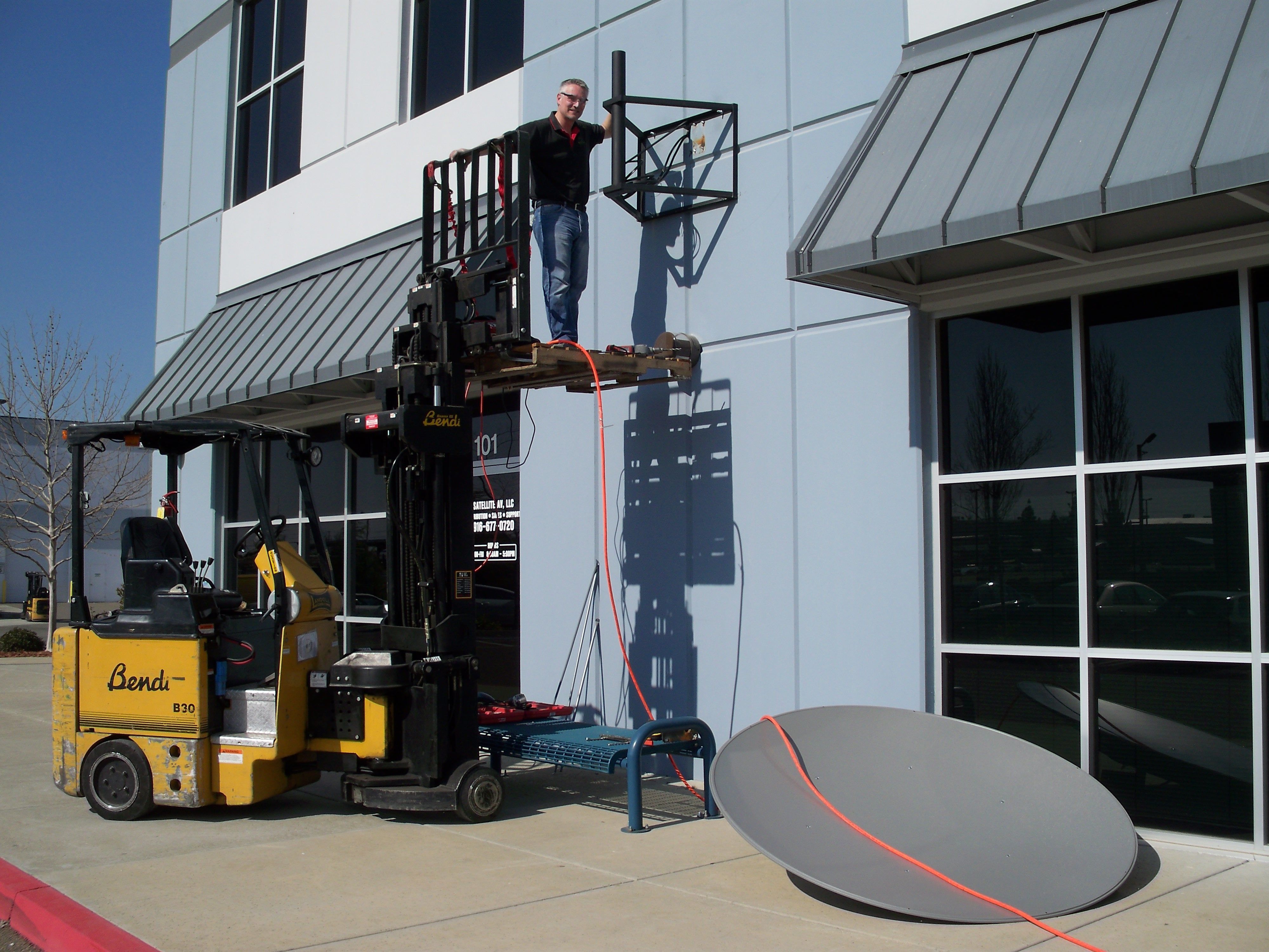

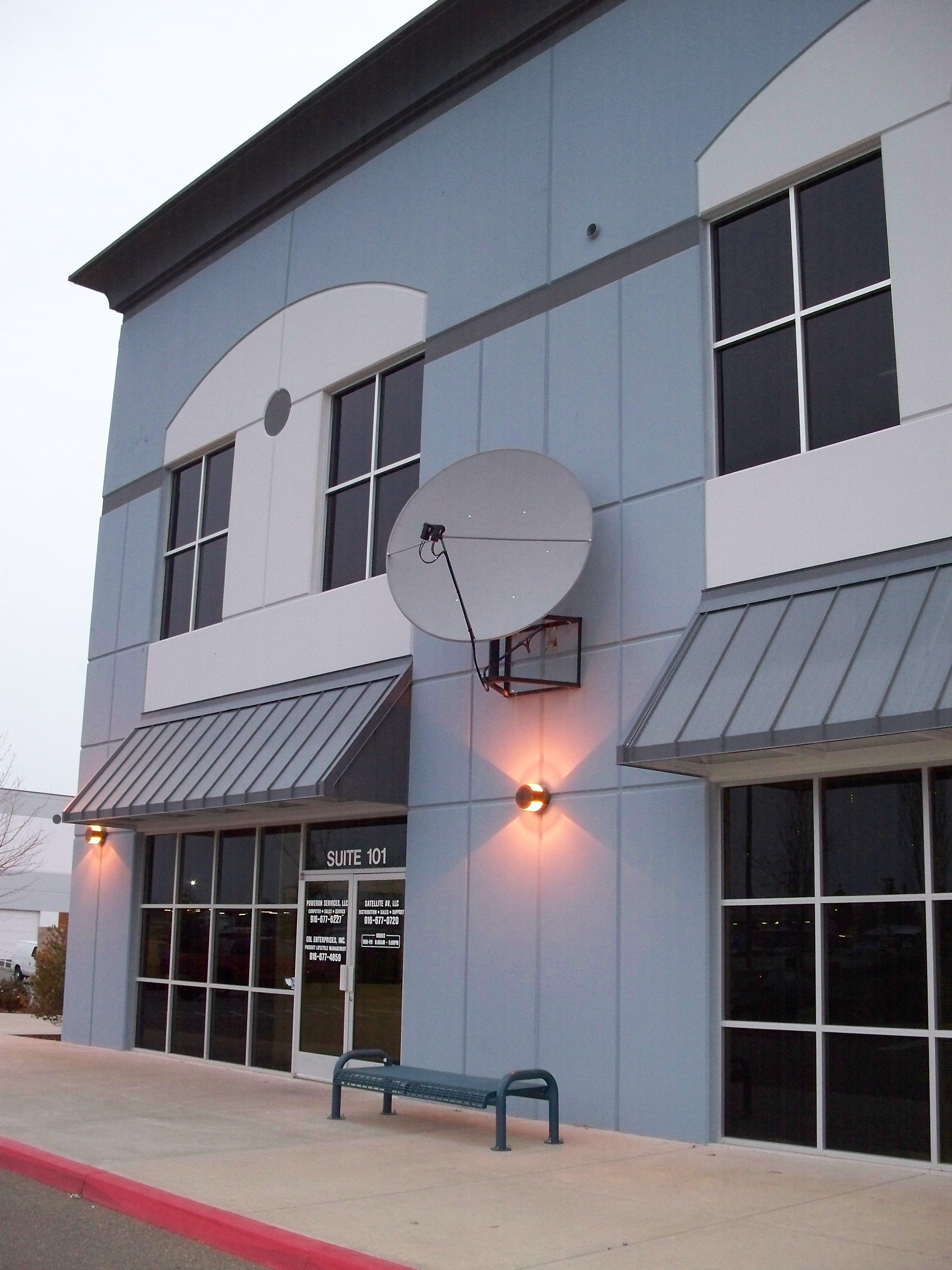

This is a 1.8M offset on the front of our building.
When I saw the first picture I said to me looks like 1.8 mts offset and then you are confirmed in your second picture..
I would like to know where you get and if those are on sale on your store?..it looks not heavier like older 1.8 offset antennas..
