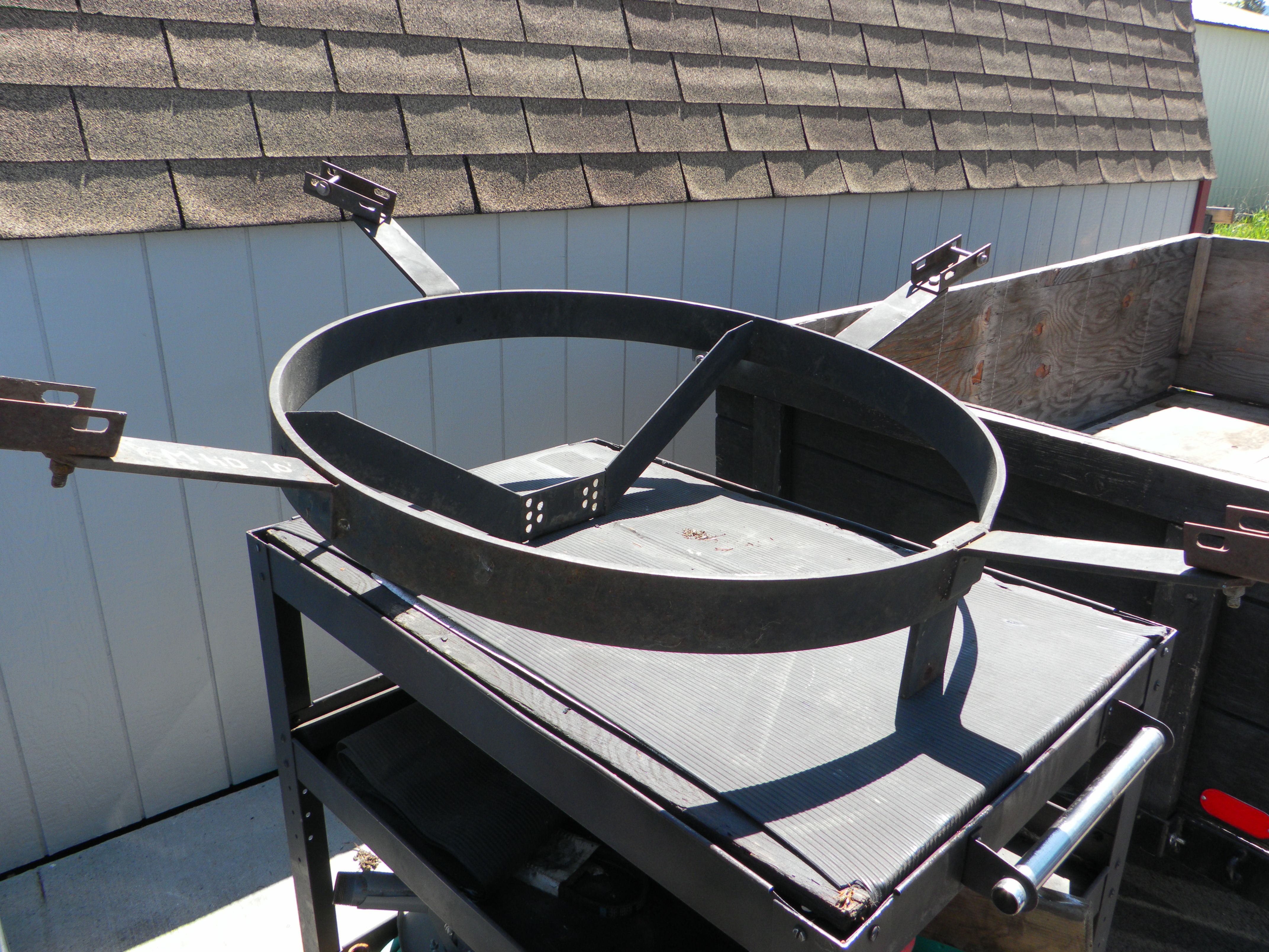

Get a length of u-channel and cut four pieces and drill a hole in the bottom of the channel to bolt to the tabs. Size the u-channel to fit over the assembled ribs of the dish. It will look like this dish ring from my Channel Master Quad Panel.
