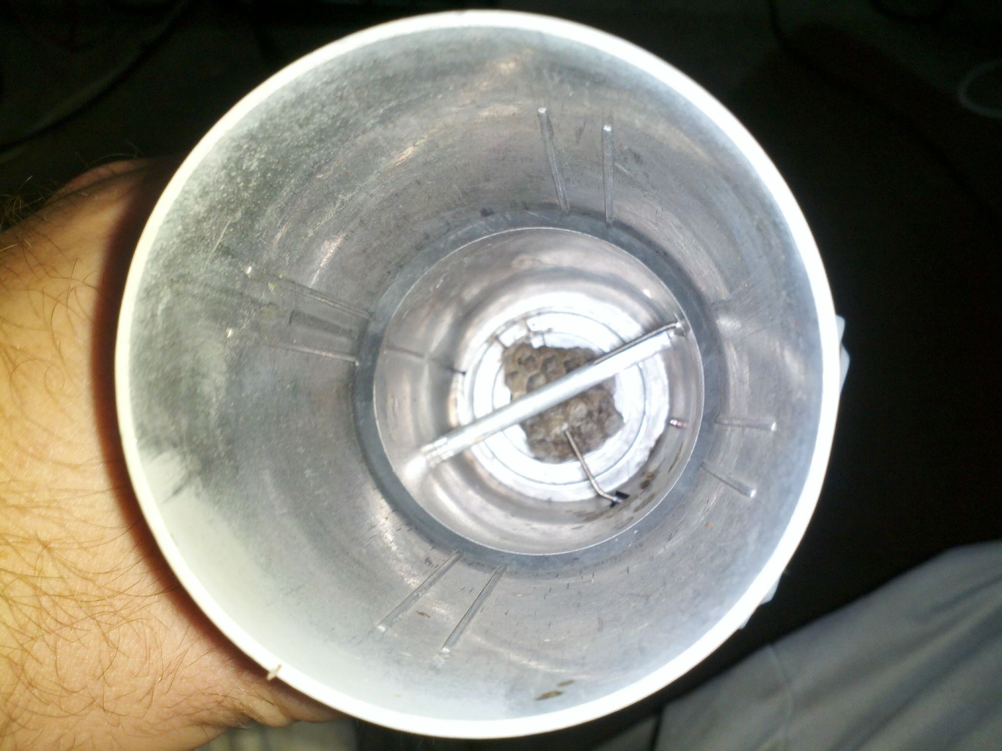

So, for about 2 weeks now my C-band reception has been horrible, and Ku non-existent. I assumed that the kids have been playing on or around my 8-foot dish again. I expected it to be bent, misaligned, or lord-knows-what else could have happened. I kept telling the misses that the kids need to leave the dishes alone.
Last night I decided to figure out what's actually wrong. I tried adjusting the alignment, skew, etc. Nothing seemed to help. I thought maybe the cable had been hit with the mower, but it looked just fine. Out of desperation I checked the feedhorn, thinking maybe they had pulled on the coax or something... suddenly I noticed that the cap was missing on the end of the feedhorn. I took it down, and here's what I found.
And, of course, this is about the time she came to check to see what I was doing. So she says "Hmm, I don't think you can blame the kids for THAT". Open mouth, insert foot.
Alas, I'm not allowed to blame the kids for things anymore. And I suppose this is going to cost me some jewelry.

Yep, those are some opportunistic buggers. Anything left open that is out of the weather will soon be turned into lodging.
I have seen hornets nests on satellite lnb's before. The customer did not even know about it and I told them.

If your cap is damaged a piece of nylon stocking (hose) and some plastic ties will work until to you can replace it. I guess they do come in handy sometimes.

I lost Ku on my Bud this spring, and it was the same thing. Blasted them out with a water hose.

Plastic caps can eventually crack and fall off, I'm always checking them because that's easier to fix than battle those stinging insects. Wasps are really bad this year, they've tried sticking those little nests every place you can think of, and lots of places you wouldn't imagine. Like under the steps of my 6' ladder, propped up beside my garage, lol, learned never to just grab up the ladder and start walking before looking!
