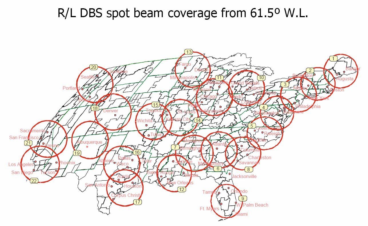

The holdup is the third downlink which serves a particularly dense area of the NE. It can only downlink on TPs 1,3,7,15,17, 19 and 23.
So, they would need 17, 19 and 23 in spotbeam mode. Remember if they want to do service from an Eastern Arc they would need all the locals, the standard def ones too on the spot. So a DMA like NYC would need probably 1 for the HD and 1 TP for the standard def locals.

FYI
01: 1, 3, 7, 15, 17
02: 5, 9, 11, 13, 21
03: 1, 3, 7, 15, 17, 19, 23
04: 5, 9, 11, 13, 21
05: 1, 3, 7, 15, 17, 19, 23
06: 1, 3, 7, 15, 17, 19, 23
07: 5, 9, 11, 13, 21
08: 5, 9, 11, 13
09: 1, 3, 7, 9, 15, 17, 19, 23
10: 1, 3, 7, 15, 17, 19, 23
11: 5, 9, 11, 13, 21
12: 1, 3, 7, 15, 17, 19, 23
13: 1, 3, 7, 15, 17, 19, 23
14: 1, 3, 7, 15, 17, 19, 23
15: 5, 11, 13, 21
16: 1, 3, 7, 15, 17, 19, 23
17: 5, 9, 11, 13, 21
18: 1, 3, 7, 9, 15, 17, 19, 23
19: 5, 11, 13, 21
20: 5, 11, 13, 17, 21
21: 1, 3, 7, 15, 17, 19, 23
22: 5, 9, 11, 13, 21
So if 17, 19, 21, & 23 do not go spot beam a lot of the spots lose 30-40% capacity.
FYI
Please forgive these nOOb questions. Let me see if I understand this, using Spot Beam 17 as an example...
All the transponders in the list for spot beam 17 can be seen equally within the area of the spot. But each transponder broadcasts a different set of channels (i.e. Austin's HD locals are only on TP 5, Houston's HD locals are uplinked on TP 13 etc.). So by losing "30-40% capacity" you mean that fewer channels can be broadcast by that spot beam.
And by inference, the extra capacity freed up on the Sky Angel TPs is likely going to be used for SD (and HD) locals required to implement a 'single dish Eastern Arc' that does not include 110, 119.
Is that correct?
TIA - Talon Dancer
Yep, you got it. Each beam has the capability to transmit on the transponder frequencies listed above. If the corresponding CONUS beam is not cut off then each spotbeam can not re-use the frequency across the US. Basically part of the spotbeam will be "dark".
Typically we are seeing each DMA market on one transponder. So if a beam is missing two frequencies then that's two DMA martkets that it could be transmitting on. Now, that's if they have the retransmission agreements, OTA signals, backhaul, and uplink ready to go.
Very nice rollup of what's really going on, Mike. Thanks. This afternoon I was wasting valuable time at work looking for that list, without success. (Don't tell Uncle Sam...)
What is amazing is just how powerful the R1 satellite is in spot beam mode.
TP01 reused 12 times
TP03 12x
TP05 10x
TP07 12x
TP09 9x
TP11 10x
TP13 10x
TP15 12x
TP17 13x
TP19 11x
TP21 9x
TP23 11x
119 spot TPs. That is a lot of potential capacity.
