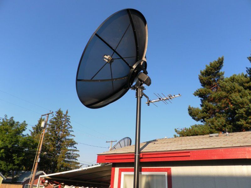

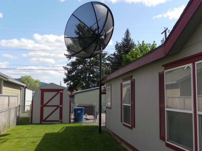

Yes, interesting solutions indeed. I have found the distance from the dish and the amount of RG6 used can be almost unrelated though. For instance, this Winegard dish equipped with a Bullseye II feed is about 30 feet from the multi-switch and receiver. The receiver is just inside the window on the right side of this picture. There is an OTA antenna included in this installation. That makes 5 coax runs from the dish and it was about 350 feet of RG6 used. It is 75 feet from the LNBs to the multi-switch.
Magic what do you mean by an OTA included? Is their a separate antenna for the OTA on the other side of the house? You have me wondering if it integrated into the dish some how. As something like that would be interesting to me to learn as well. My OTA is okay but I half to go out and turn the mast for this or that. The old channel master on top hasn't worked in a long time. it could be something simple to it. IDK but would be really nice to fix as I get all my other stuff set up.
