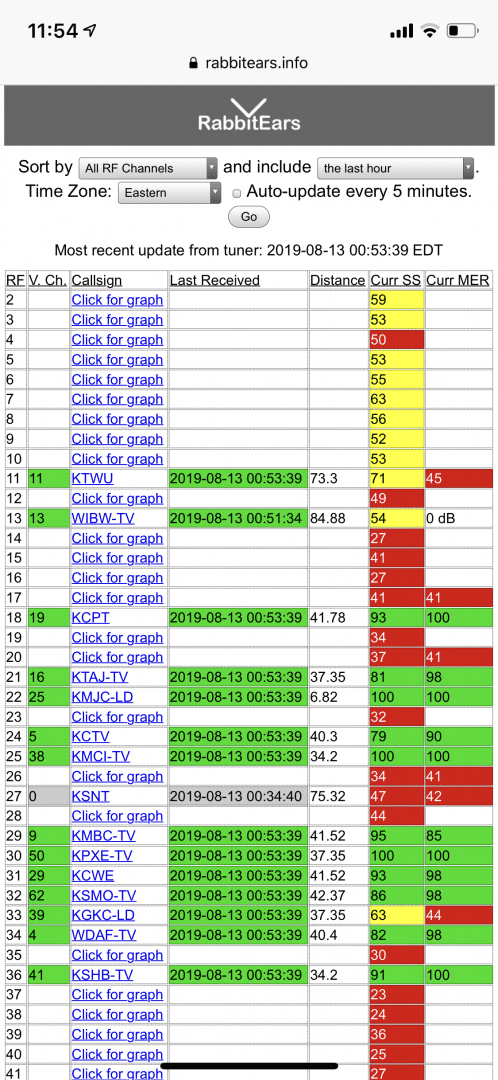

I have an RCA ANT751R in the attic. Combined with a Channel Master CM-7777HD preamp, I regularly tune two VHF-HI channels at ~83 miles.
Aside from that, and the occasional ducting event, 45-60 miles is the best I have done to reliably tune OTA channels.
Here's a look at what I'm receiving currently:

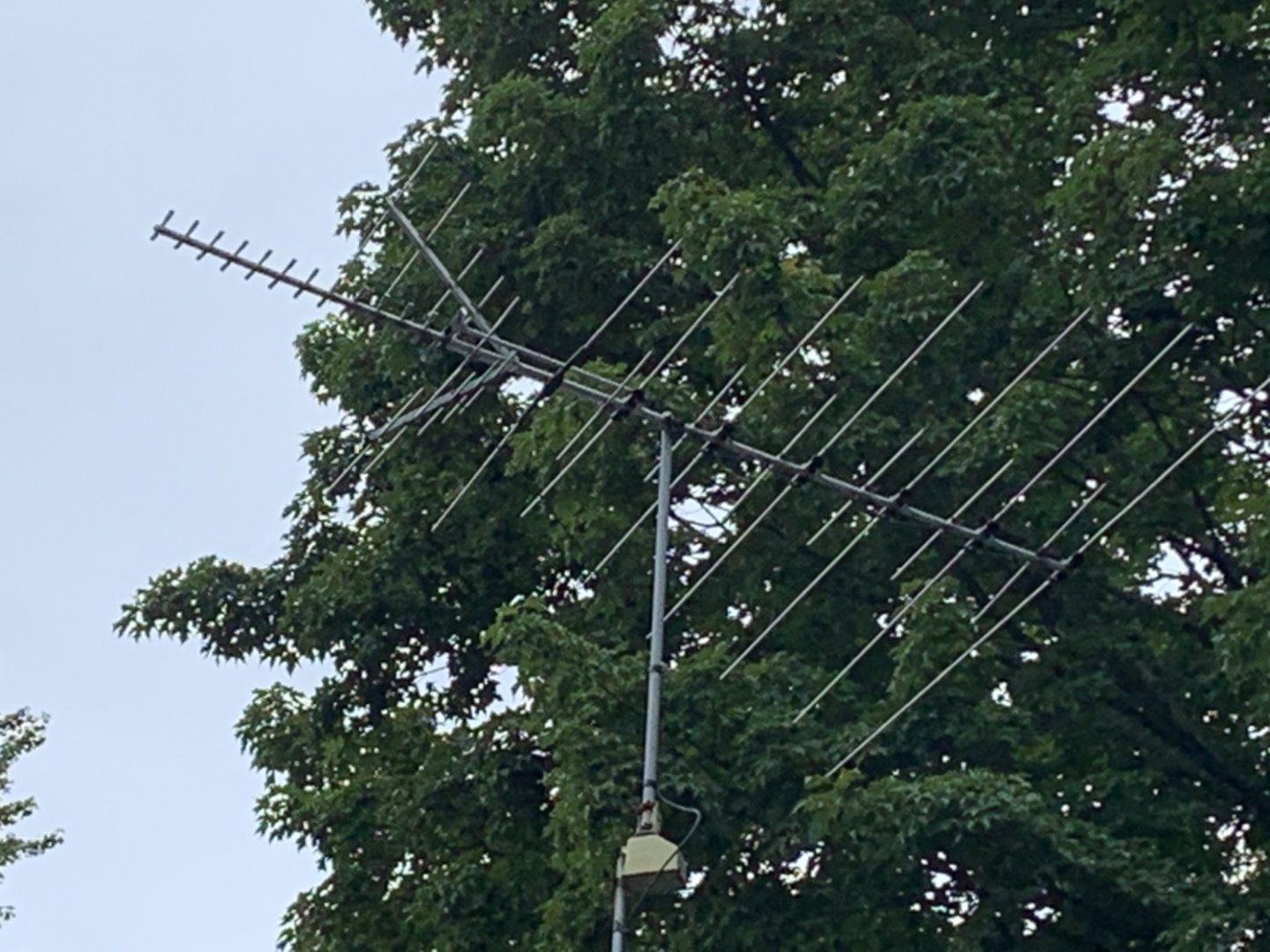

True with analog but with digital broadcasting a regular large UHF/VHF rooftop antenna will receive equally front to back. My antenna not only pulls in everything due south from the Philly area but also everything due north from the Scranton/Wilkes-Barre area. It also pulls in everything from the Allentown/Bethlehem transmitters about 30 degrees SSE, all without using the rotor. My most recent rescan, due to the ever ongoing repack, I locked 73 channels.

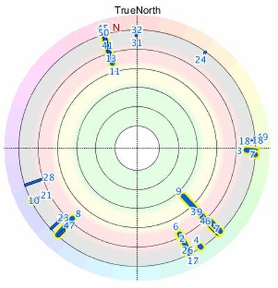

Here's the TVFool image. My house is dead center. Draw a line from NNW to SSE and you'll see it's nearly a straight line from the SWB transmitters to the Philly transmitters and with my antenna pointed directly at Philly I pull in all the SWB channels on the back side of the antenna. Even using the rotor I could not do that when it was still analog. This isn't theory, it's real life fact.
Front side actual range distance = 77 miles (Phila)
Backside actual range distance = 53 miles (SWB)
Total channels locked = 73

Digital signals are received at the antenna exactly as analog ones were.
The only difference is how the receiver treats them, not the antenna.
That's incorrect. Analog signals consisted of a continuously variable amplitude signal while digital is a bitstream. The continuously variable signal required the antenna to be designed in such a way as to capture that signal as efficiently as possible and that efficient design made the antenna very directional. A bitstream has no such limitations. If that hunk of aluminum picks up those ones and zeros from any direction they will be captured perfectly.
The content rides on a carrier either way. With NTSC, there was an AM carrier for video and an FM carrier for audio. What does your experience tell you about AM versus FM at the same frequency?
Philly is a peculiar vortex for TV signals. You may be receiving reflections rather than the direct signal.
