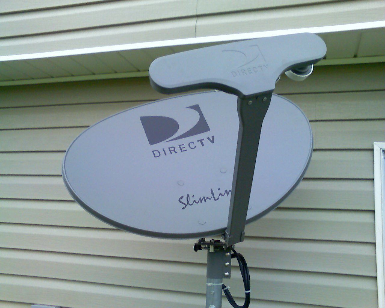

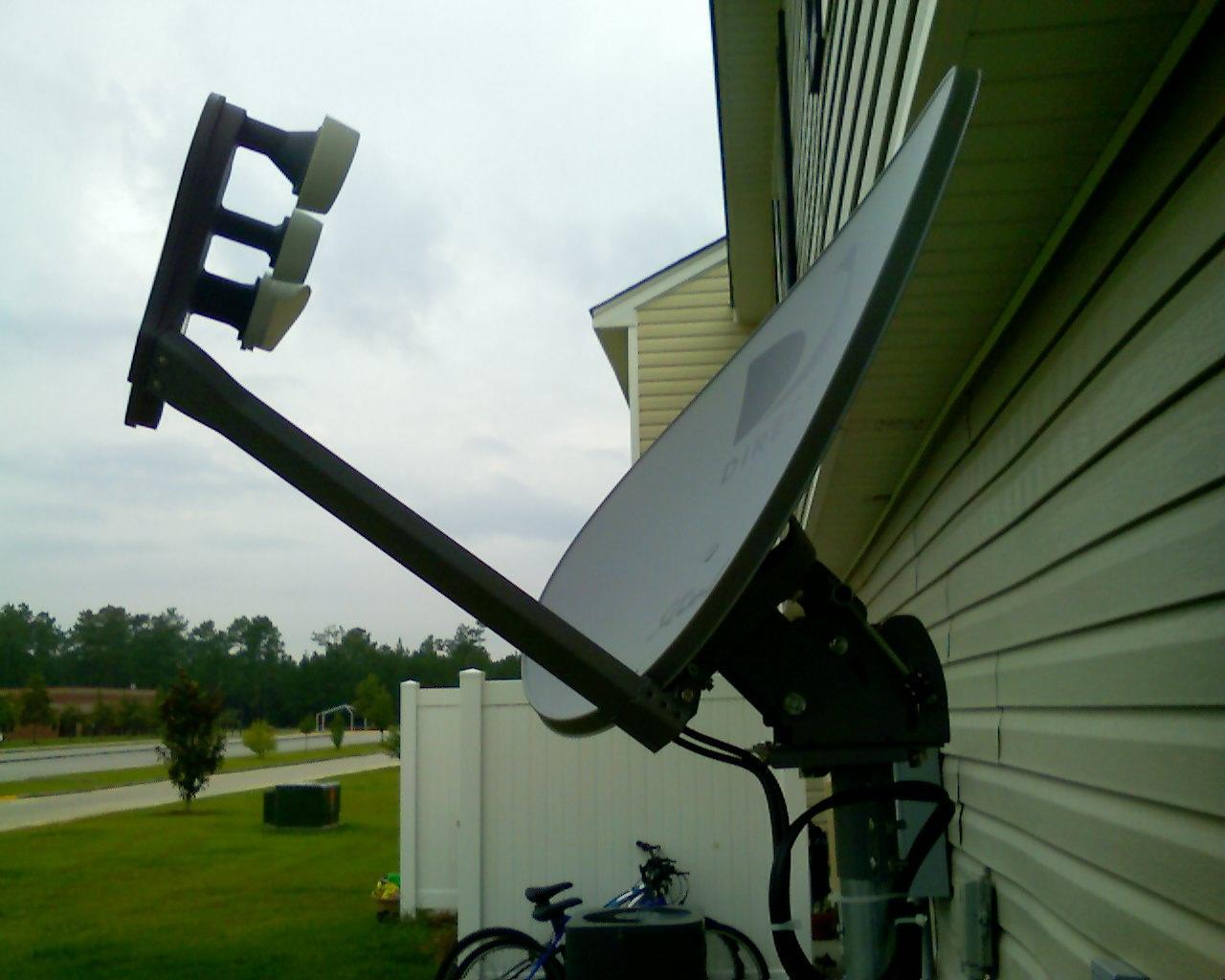

Thanks. I set the elev and tilt via the hr20, then turned the dish slowly into the right AZ.
Once I hit those numbers I tightened it all up and left it.
It can't be that easy! You must have done something wrong. :D
It took me longer to put the darn thing together.

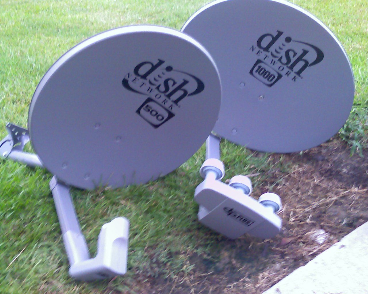

I was surprised, easier than setting up a Dish 1000.2 on 110/119 and a D500 on 129 for sure.
here's some pics of the old and new

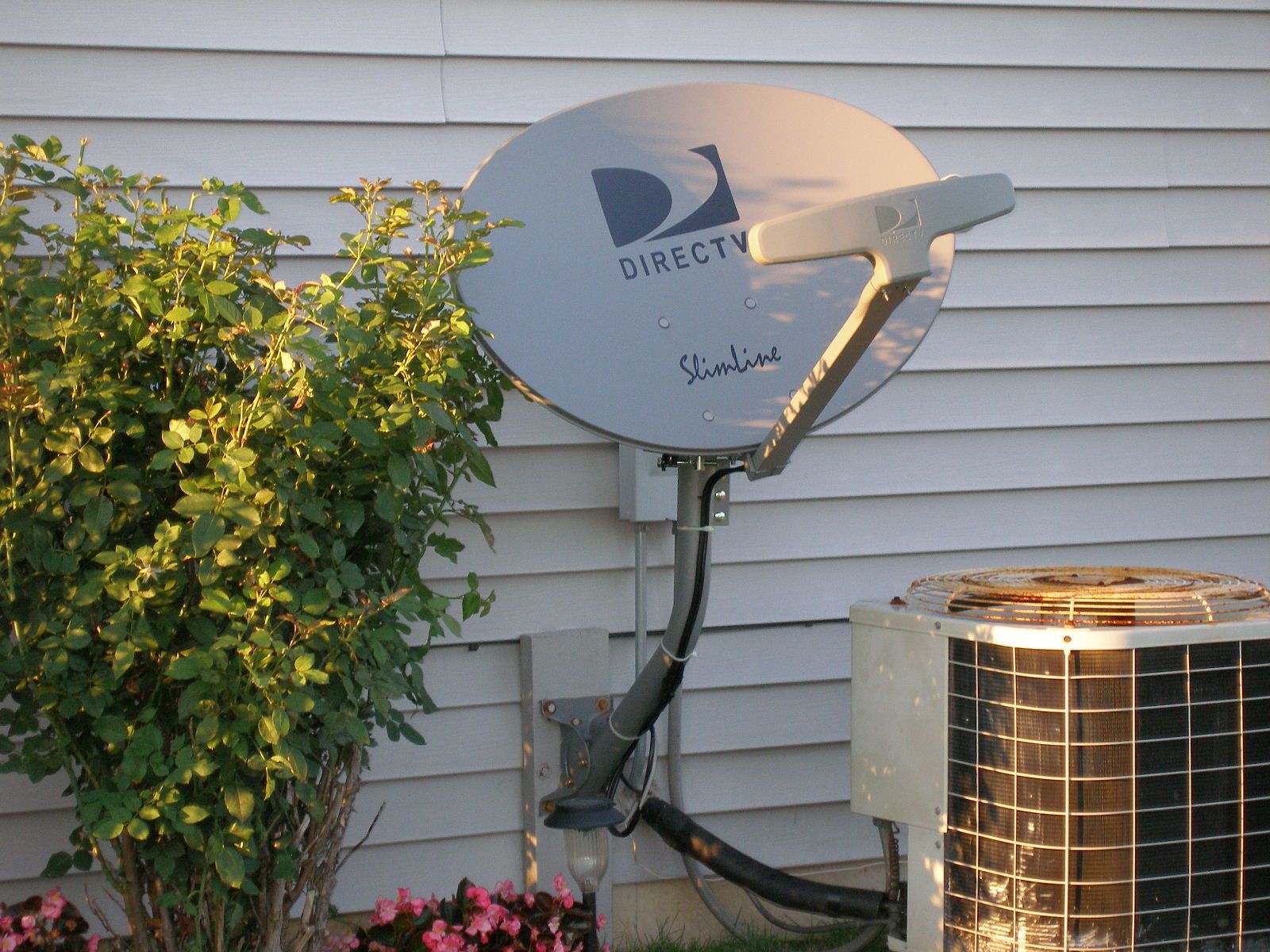

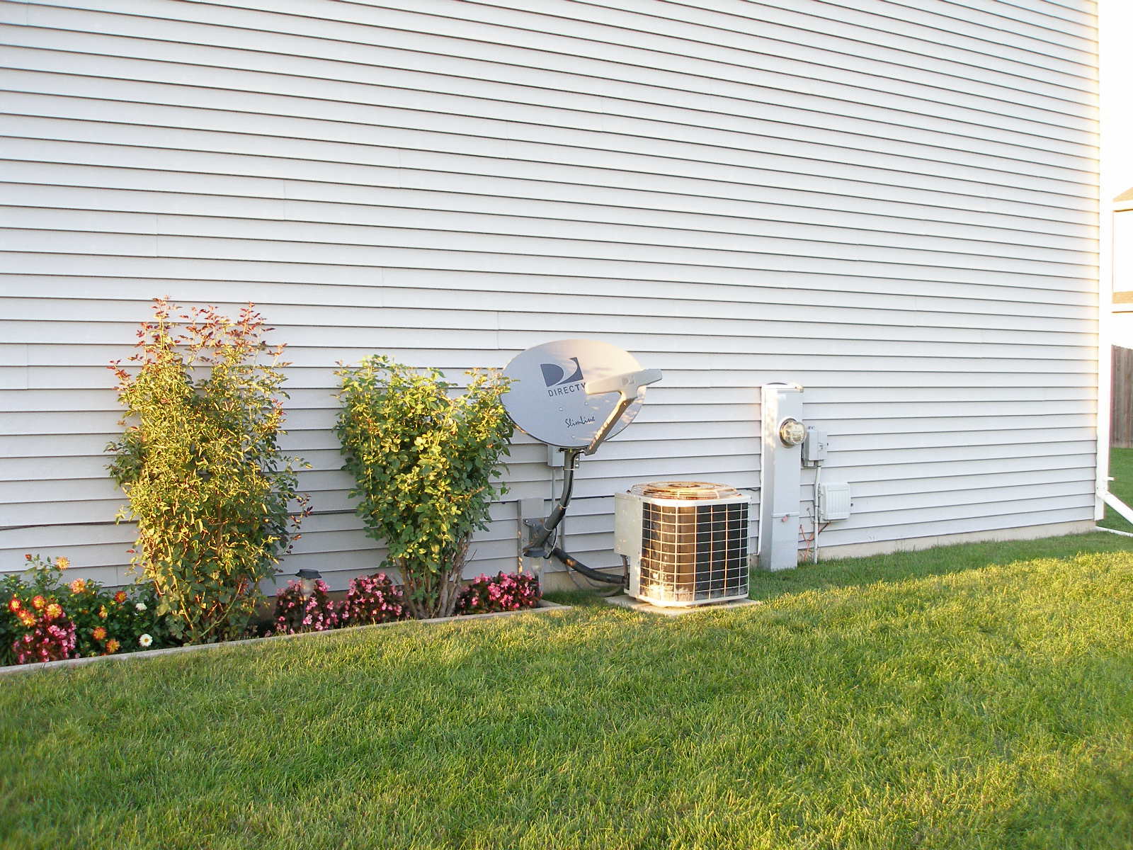

Here is what I'm getting in the Chicago area:
99 (b) 74 94 74 96 80 96
103 (a) 96 0 96 0 96 0 0
Used an Acutrac 22 pro that I borrowed for alignment.

Be careful! If you didn't dither the signal correctly, you might be missing out on the new sats once they're operational. KA bands are extremely narrow and are easy to miss.
