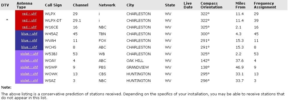

I used 25301 as my test zip code and you are not looking great in the digital OTA realm too me. (see attached) * and DT indicate digital channels as last reported in that area. The call signs that mix alpha and numeric are translators (repeaters) and that is not usually a good thing. You must be in some very hilly and forrest type topography.

His market has WQCW-TV (WB...CW in September) channel 30, licensed to Portsmouth, OH to the west. Their digital is WQCW-DT channel 17 with only a 50,000 watt signal. Wish him luck!
