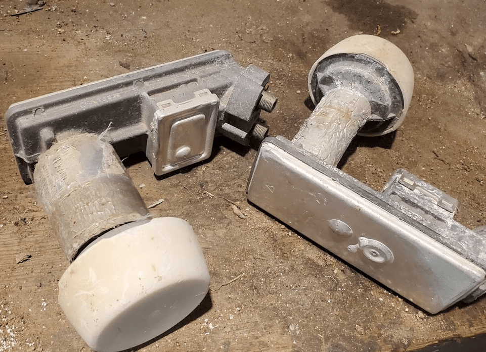

Looking at your big dish, it likely clamps around the throat.
Rip the back plastic casing off the lnb. The aluminum throat between horn and electronics will be undersized. I wrap mine with either duct tape or aluminum tape to build up the diameter to fit the lnb throat clamp..

Dish Pro dual lnb with case removed and barrel diameter increased with tape to match the lnb mount.
