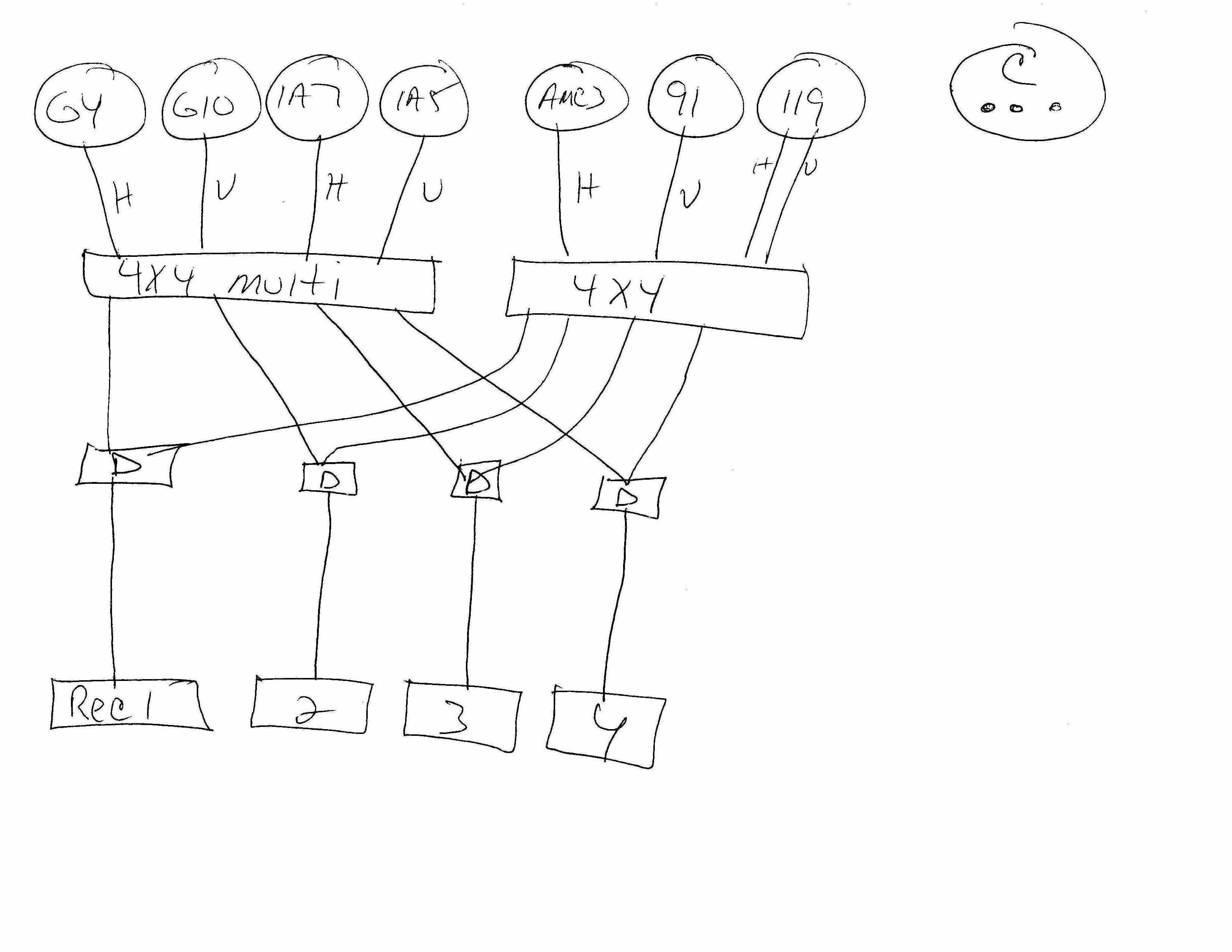

Well here would be a setup using what you have written above :)
one 4x4 multiswitch would have
-G4 H
-G10 V
-IA7 H
-IA5 V
second 4x4 would have
-AMC3 H
-BOTH from 119
-V from 91
one output from each 4x4 goes into a 4 way Diseqc switch. I didnt deal with the C-Band (its on the side) but you have 2 empty ports on the Diseqc switches for 2 lines form the C-Band LNB's...if you go 3 you can put a 22k switch on 2 of those C-Band cables :)
D-Diseqc switch...

WOW, cool, that looks like the setup I will try. Looks like it will work fine, I just have to figure out where to put my g12 lnb :0)

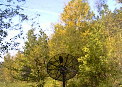

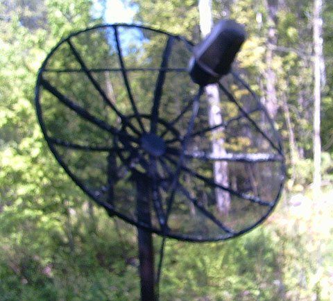

Took a day off today and decided to spend some time playing with my 6' BUD. I leveled the pole, ran an extension cord out to the dish and hooked up a 2700 and sat finder to the lnb.
I didnt bother to hook up the actuator, the old one was toast, and I havent put my spare thompson saginaw on the dish yet. I also havent hooked up the polorator yet.
I loosed the bolts on the mount so i could swing the dish around and figure out where it had been pointed at last. After about 2 minutes of playing around i had a good strong signal on the meter. Not knowing where I was pointing, or what polarity the polarotor was on, I decided to do a blind scan. After scanning I had 4 FTA channels, on fr. 3947 sym 9400.
I checked lyngsat and low and behold, I was on g4 (the sat i wanted that dish pointed at) :D Signal quality is at 65% without really peaking the dish ( I cant peak skew without the polarotor hooked up. WOOOO HOOOOO.

Here are a couple of pics of my 6' BUD, If you look close at the second pic you will see the 10' BUD in the background.
