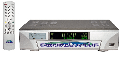

Gotta have 4:2:2 like the Quali-TV and make it have OTA ATSC Digital Terrestrial HDTV kinda like the Diamond 9000 HD, and all the other bells and whistles we guys would love to have in a STB! Woo Hoo, Spread it on! :D
Maybe have a VBox Positioner built in for us C-Banders and have an analog quality meter (Needle Type Meter or could be LCD Bar Graph) in the front so we could see the signal all the time! Little things like that! Hey, I can wish can’t I!
