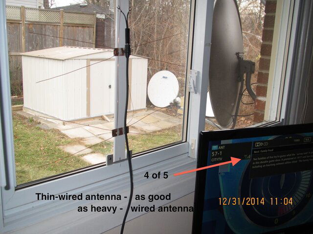

The best signal strength (5 of 5) was after disconnecting the rails from the 2 bottom "V" probes (so only 3 pairs of probes worked).
Finally, I re-soldered the rails as they should be - with top and bottom probes reversed. Signal was still 5 of 5, with bridging wire joining the rails.
Other TV programs (with stronger transmitters) were 5 of 5 all the time.
I agree with DVB-S2 statement that my TV's signal indicator is imprecise, using only 5 steps.

Got some unexpected results...
Partial "shorting" the "V" probes with small loops of wire improves reception. Shorting the top probes definitely spoils reception. So far, I got no idea why. In these frequencies, there is really no "short", as semi-circle of wire has certain inductance.
Finally, I figured out that my 24" Toshiba TV has decent signal meter, not only the 5 small bars shown when changing channels...
Annotated pictures show more
