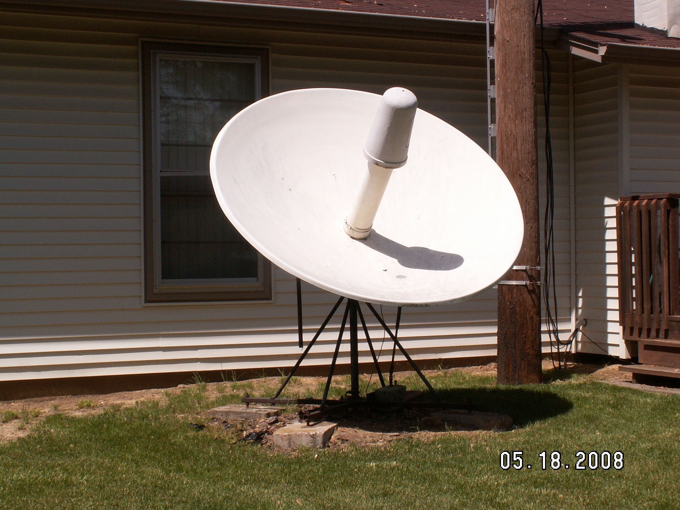

Well here is a possibility of a new dish for me to play with.
I am waiting on the guy to call me back, and I might run down and pick it up this evening. :)
It is a little small for C-Band, but might work out real well for Ku.
Here is the guys description from two different emails:
Thanks for response...I remembered this as 7', however, as best as I can measure I get 78" in diameter. The dish is solid metalized reflecting surface in fiberglass. There is no "manufacturer" I designed the system as well as the tracking mechanism. I am a retired biomedical engineer and extra class amateur radio operator and will attempt to answer any technical questions you may have. The attached picture pretty much says it all.
Second email:
Hello again..
Dish was used as prime focus with LNA at focal point in the weather cover. I used it for C-band and had reasonably good success before things started getting scrambled. I have all of my notes for design as well as numerous articles from that time. Sorry photo did not make it, however, I'm attaching to this note.
Here is the pic:
If it works well with Ku, it might be a nice dish.
What do you guys think? :cool:

This dish just intrigued me. I thought what the heck, it might accidentally be a great performer. It looks to be very flat which might work out well. Maybe even turn it into an off-set dish. :eek:

The guy said that he didn't make the dish, he only made the mount and tracking mechanism. The dish was commercially made. I asked if it was mesh inside, and he said that it was solid metal encased in fiberglass.
Don't know who would have made a dish like that, but I guess I'll find out. :eek:

Either way, it's a nice looking dish. I can't help but wonder how that huge pipe running up the middle will effect the LNB, whether C-Band or Ku-Band. It almost looks like a Cassegrain (spelling?), but I'm sure it's not?
I was thinking about that, too.
You know, a radome on an airplane passes RF just fine.
So, maybe this is some sort of plastic, fiberglass, or other non-metallic tube.
Could we make our own out of a cardboard carpet roll? :rolleyes:

I also thought it might be a Cassegrain too, but almost certain it isn't.
I don't know about the tube, but I am sure it passes RF or he couldn't have used it. It seems to me there must be a better way to mount the feed-horn, but who knows. :)
Well I have the dish home. :)
The diameter from the tip of the outer edge to the other outer edge is 6 foot 4 inches.
I put the string test on it, and it is perfect as far as not being warped.
What the guy said was true because the paint has peeled off a small area exposing the solid aluminum sheet on the reflector side with fiberglass on the back side for stability.
He only bought the reflector part from some manufacturer, and hand made the mount, the elevation and declination adjustments, the motor drive, and the electronic positioner wired through a calculator with display on the front. Pretty smart guy, but I will probably just hook up his motor drive to a GBox.
The online calculations show it to have a Focal distance of 25.7 inches, and an F/D ration of 0.34, so it is almost average as far as depth. I will have pictures a little later. My wife just got back with the camera, and I'll have to off-load all of their pictures before I can use it.
The Feed-horn support is made out of schedule 40 PVC pipe, and after studying it a while, I think it might not be a bad way to make one. I will need to figure out a way to adjust the height unless he has it right on the money.
I think it is going to be fun to play with, and might be a secondary Ku testing unit on the parking lot out front.
His polar mount is very simplistic in the way he designed it, and the mover design is a hoot. :eek:
But hey, if it works, I will not complain.
