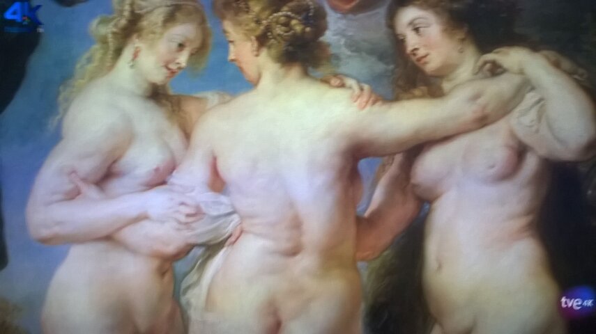

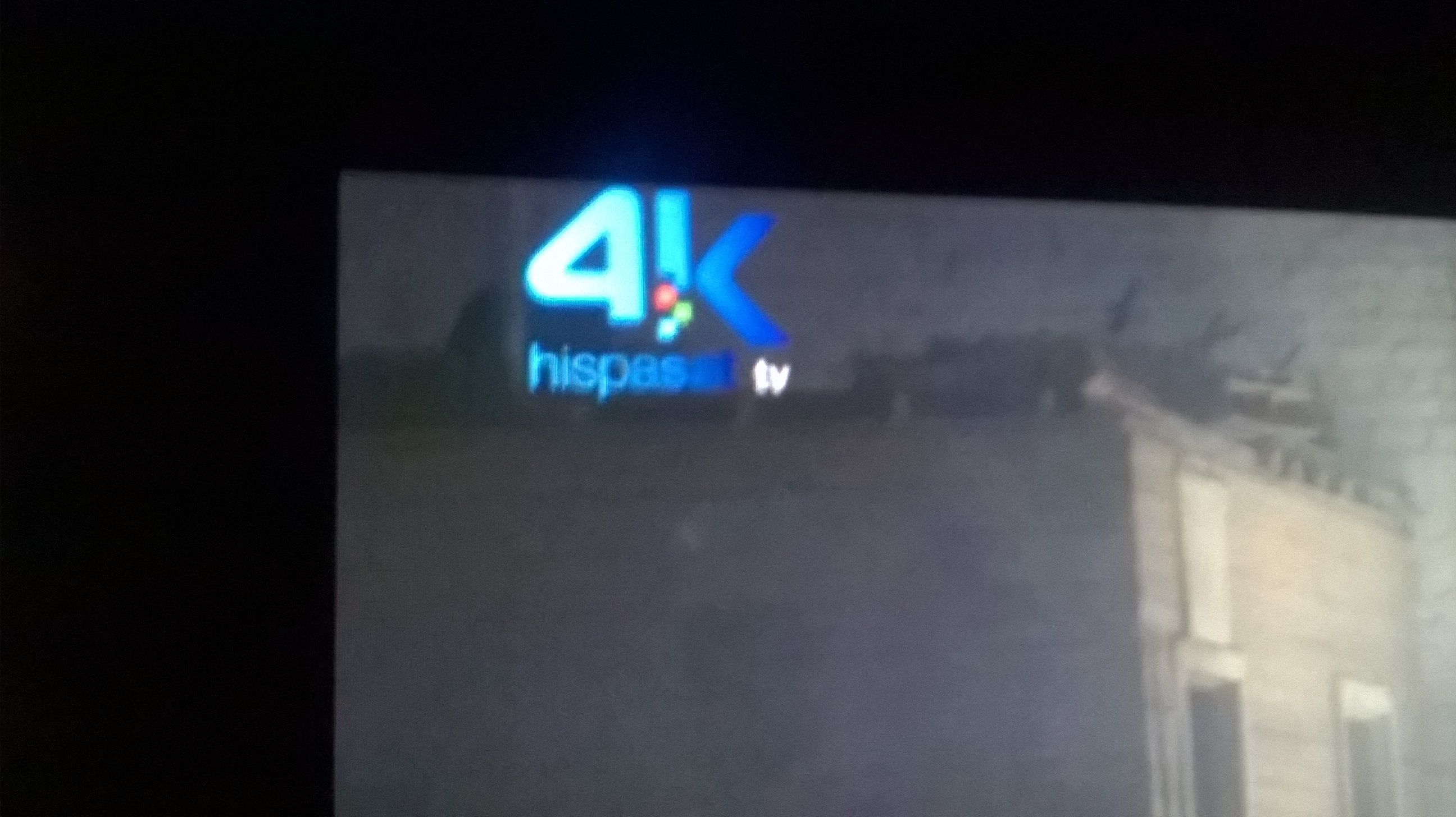

heres a small recording & 2 pics of my tv. a quick update. since vlc didn't want to play h.265 content for me even though it claims to I am using dvb dream 2.6 now with LAV codecs. most programs wont play .h265 UHDTV files so don't be surprised if yours doesn't. I had to rename it so it would show up on my pc & upload here. (I don't have a file converter). some of the content is from rtve & hispasat & red bull. there are short 3 min clips of skateboarders,skiiers, flowers & animals, a tour of an art museum in Barcelona, European train station, motorcross riders that kinda stuff.
