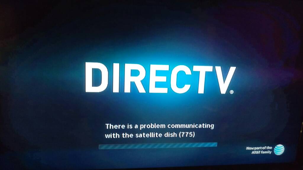

Everything just came from the cabin, and it all worked up there. The lnb is brand new. I ordered it t from Amazon and put it into a slimline dish
Then it's most likely that you aren't pointed at the 101 satellite yet. It can take some patience to get it the first time.
Which error exactly are you getting right now? 775 or 771. If you are getting 775 that needs to be fix first before you can fix 771.
I'm getting the775

Until you fix the 775 issue, nothing else is relevant.
The 775 could be caused by almost anything because it indicates the receiver is not seeing the SWM LNB. If you think the various pieces have been working, check all the cables/connectors, that's where the problem's most likely to be..
Sweeping the dish does nothing as that deals with 771 and NOT 775. You need to make sure power is getting to the LNB from the PI and tat the receiver is seeing the LNB.
