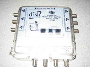

Does the "splitter" look like this one?

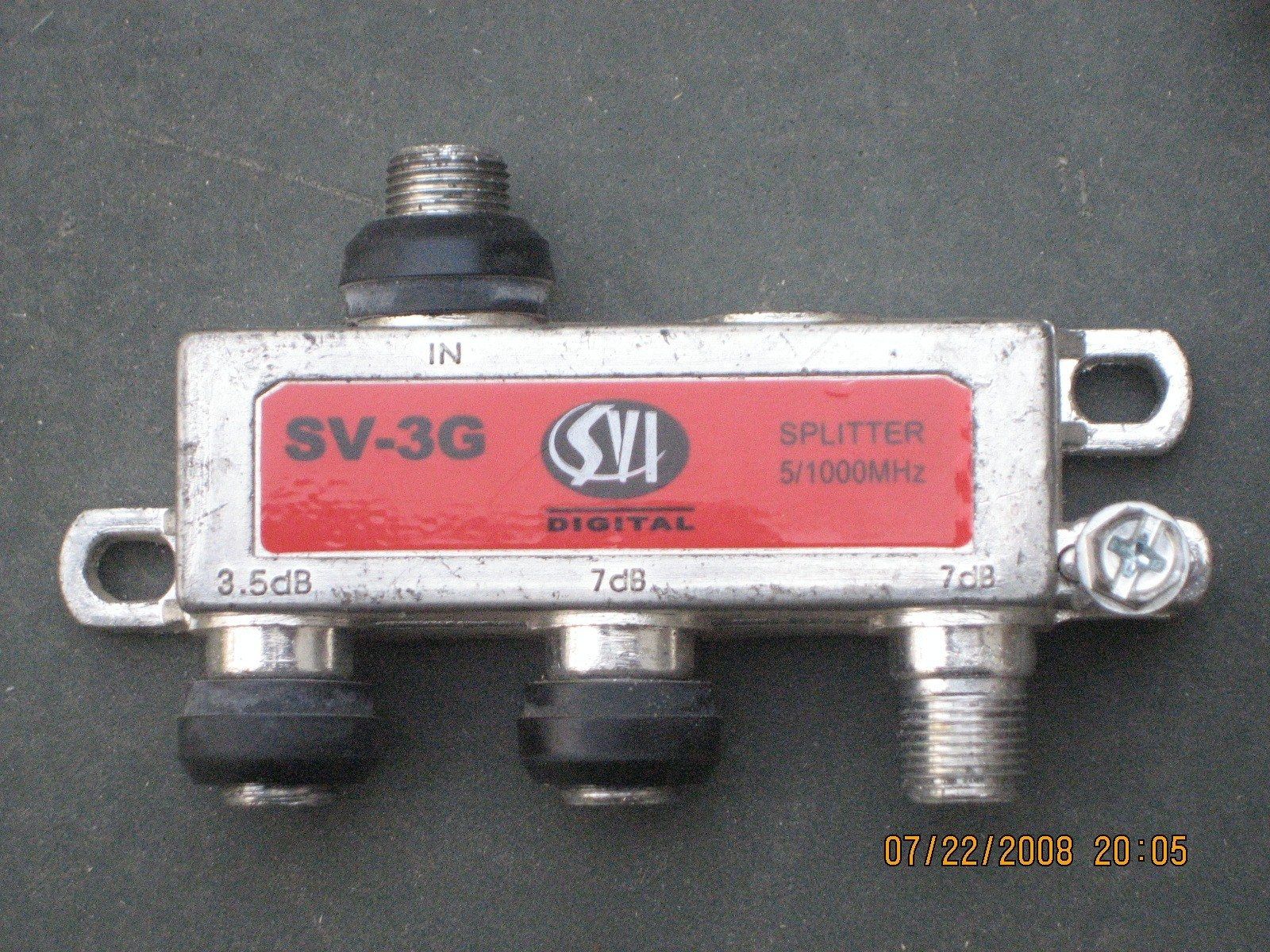

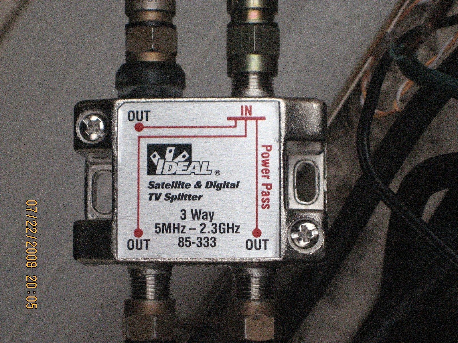

I stopped at Home Depot on the way home, picked up the Ideal 3way with power pass on one of the outs, this worked. So I think eventually if I get another Sat Box I will need power pass on all three outs. One thing I failed to mention in my previous post, before the split is a Diplex for OTA antenna, I noticed a drop in a few channels when I don't use the power pass port on the OTA box as well, seems that the OTA suffers a little. In the pics, is the old splitter with no power pass through, VisionSat box gets no signal on this splitter.
Marco - that splitter you pictured is not suitable for your application.
Please re-read what Tron posted above.

The old SVI is a CATV splitter with a maximum frequency pass of 1000 mhz. The reason the new Ideal splitter worked to a degree is that it passes up to 2.3 ghz. What a splitter won't do is properly switch polarities for you. You will be stuck on whatever polarity the 'master' receiver is switched to (the master receiver being the one hooked up to the power pass port). If the master is turned off, no other receiver will be able to power your LNBF (or therefore switch polarities). DON'T use a splitter with all-port power pass, as your receivers can be damaged if more than one is trying to power the LNBF or switch polarities at the same time.
