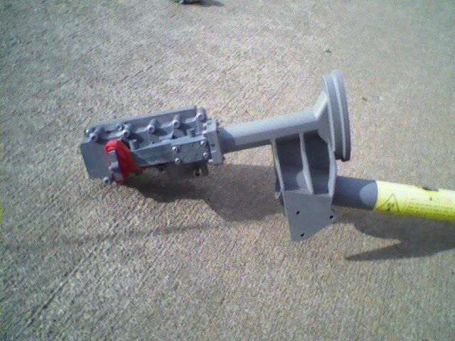

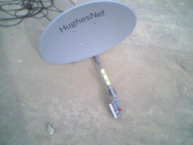

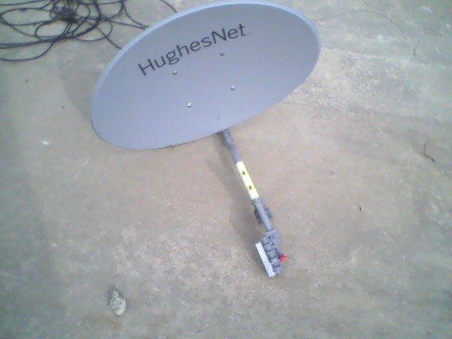

Hmm. Couldn't get any signal off the Hughes LNB/dish.. Had settings at:

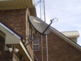

Single, LNB Power ON, 10750, No 220khz.. I got frustrated and put up my P* in the cold rain, got it lined up on G18 in no time. The P* are really some of the best antenna systems I've seen. The manual elevation adjustment is a dream. I know they are still around, but can you buy them new at all?
On the off chance I have a bad LNB, I changed the Hughes.net branded LNB with an older Direcway branded LNB (same) but no joy.. It was cold out yesterday, so I suppose I could have just been overshooting with my ground level pole jig I have.. ( kid's old basketball goal, filled with sand, welded with schedule 20).
I've included a couple of pics, both of the Direcway/Hughes LNB and my P* install from yesterday. I can't tell, but it looks like my LNB is different from Anole's pictures, but it could be the LNB cover..
Appreciate any advice, I was hoping to use the Hughes dish on White Springs.

Yep that's different, newer dish, with the HughesNet name on it. I put mine back up earlier today while it wasn't raining, took about 30min. With the lnbf that came on it..first signal I got was 74 so that's where I left it. 75/75 signal on ONN, works even better than I remember.
So the settings are right, and I"m just being heavy handed you think? Didn't have any problem finding G18 with the P*... and that Hughes LNB weighs as much as the entire dish..
Possibly, this direcway dish is pretty touchy when it comes to aiming. I compared it to jacking up a tank with a car jack lol. But it stays set when you do find the signal and lock the bolts tight. I used my traxis 3500 aiming it today, didn't take long at all to find H2.
