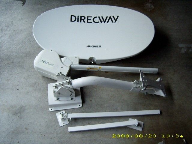

Here's the dish I got Whitesprings with a while back.
Their conservative error correction lets you dig their signal out of the mud just fine.
edit: oh, I see Iceberg looked it up. Well, regardless, it's just fine as is.

A while back, some other vendor had the same thing for sale on eBay.
He even had the Invacoms with two outputs... and I kicked myself for not getting some for future uses.
Well, it's been a few months or a year, and I have come to the conclusion that the inexpensive Hughes or the nearly-free Dish Network LNBs would be just dandy.
As a matter of fact, I'm negotiating right now, with someone who's going to send me a similar dish.
(see below)
I have no plans at all, to change-out the LNB!

By the way the DirectWay dish is the Exact Same dish as The DirectPC dish that I mod'ed. I hope you are pleased with it! I hope the LNB is Okay, the one I have is toasted...

Still have mine, same exact one that Anole's picture shows, and it was used for 3yrs for internet, until dsl finally made it to my area. It was the first dish I had to use for fta, and on top of the house. It was pointed at Satmex5, and you can imagine what kind of fun a greenhorn had trying to point it at 123 and get a signal. Took me a couple of days I think, finally dragging a small tv and extension cord up the ladder with me. That dish has a great pointing mechanism, but its hard to aim at some sats.
The whole thing is heavy, even with the transmitter removed.
