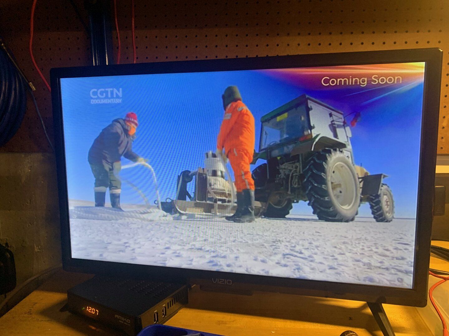

OK. I seem to be on Galaxy 3C now... Based on the transponder values, and I have pretty decent picture. Oddly, I can catch this with the LNB Set to 10600 or 10750, but the transponder numbers when it detects the channel are wrong for some reason. The Symbol numbers seem to be more accurate.
Reactions: FTA4PA
How much are the frequencies off, when using 10600 (or 10750)?
Then add or subtract that number to 10600 (or 10750), and you should be spot on on all frequencies (or, as discussed above, just 1 or 2 off).
