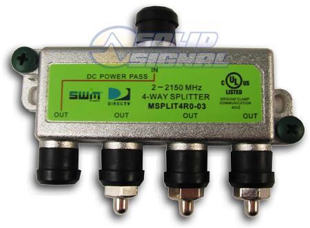

Ok so you need two DECA adapters, one for the router and one for the receiver. As far as the PI for the SWM lnb, it needs to be on the port that has power passing. They're usually labeled with red so you can see it. What type of splitter do you have?
Does it look like the one I posted? Notice port 1 is labeled in red.

Yes, the splitter looks exactly like the one you posted. There is an existing PI behind my HR21 700 which is correctly installed from the powered outlet of the splitter. So if I understand correctly, the PI can go anywhere in the system from the splitter and before the first receiver's DECA. So it will end up being the Dish LNB to the Splitter to the PI to DECA #! to receiver #1. Then from one of the other splitter outputs will be one RG6 cable to DECA #2 to receiver #2. Then from another splitter output will be one RG6 cable to DECA #3 (with its own PI) to my router. If that is the correct configuration, I think I understand what I need. Thank you.
