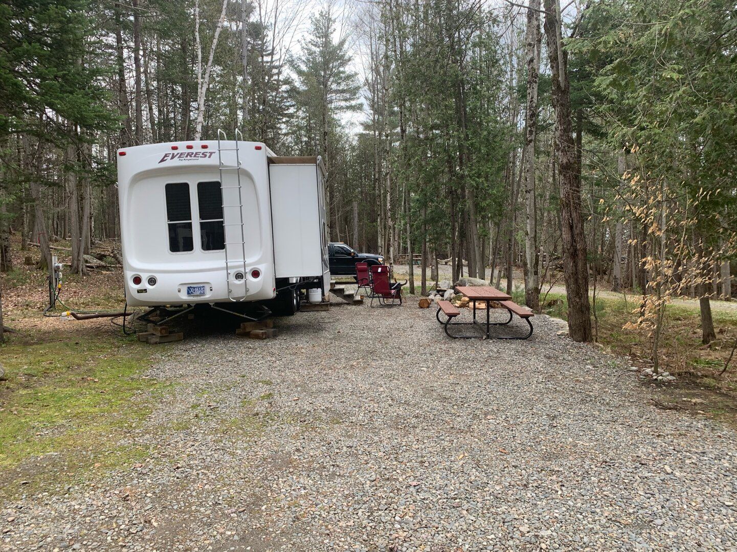

I just picked up an EA LNB local for free, going to try to get those this weekend when I go up, but I do beleive they are blocked heavily with trees...this pic is the direction of the eastern arc, it's possible I might be able to setup on top of my camper though.
Yeah you're in a pretty heavy tree covered area..Are you using a app like satellite pointer to locate the satellite?I prefer eastern arc since I don't use locals and only 2 satellites to hit in your situation.. I've had times where I could only hit the 61° satellite but it has most all of the channels we wanted.. better than nothing
