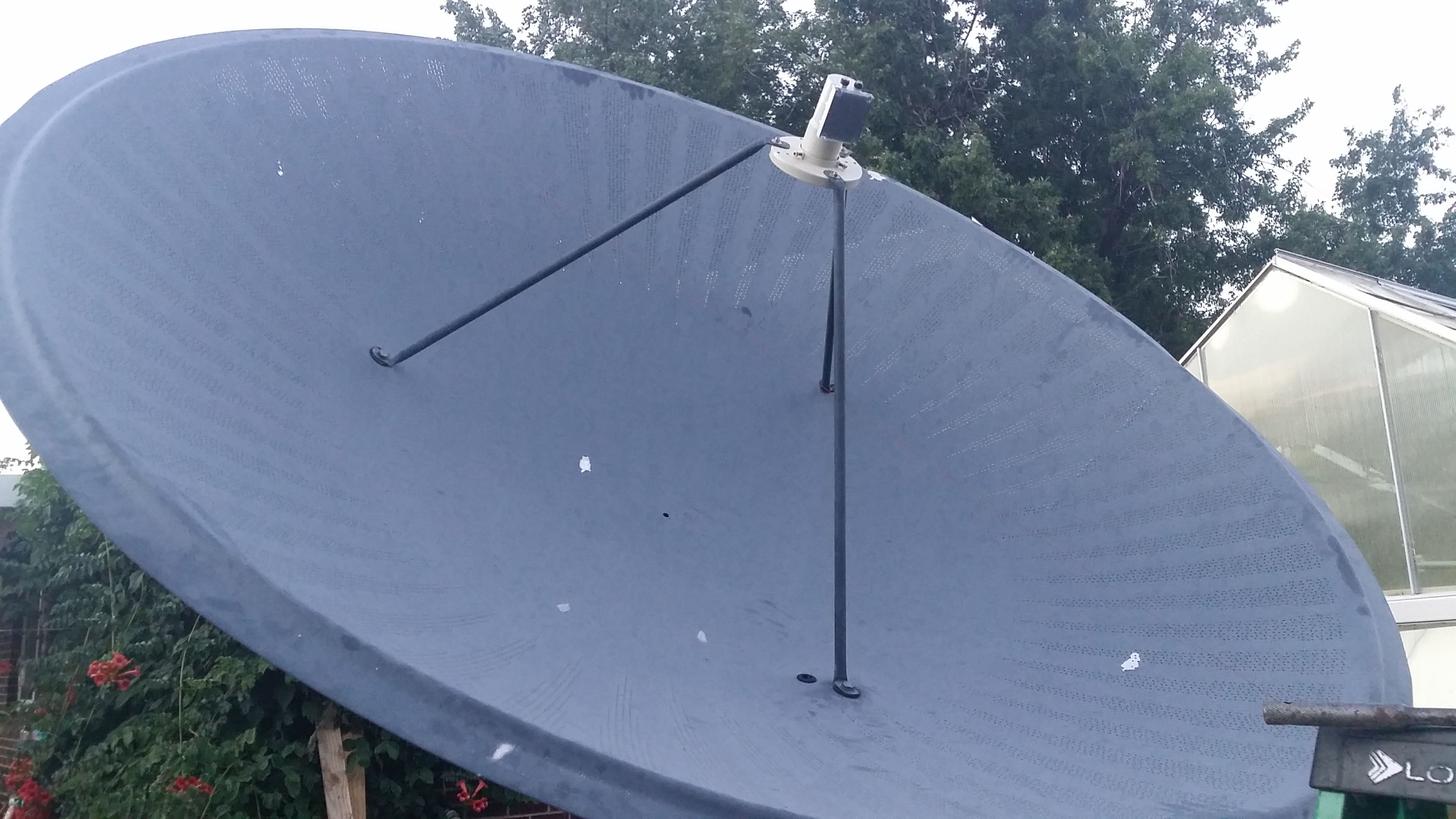

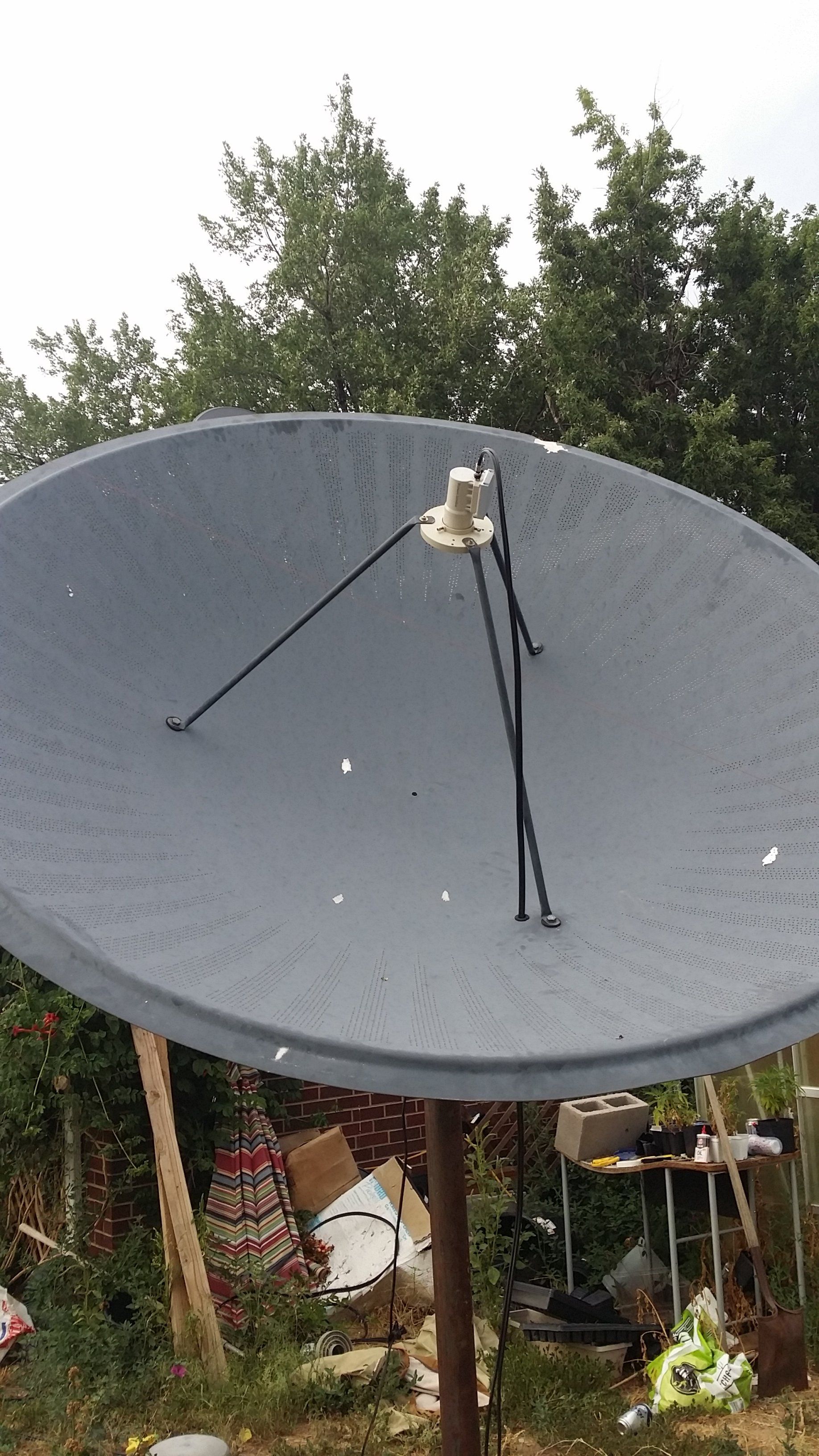

That's not a mesh dish, as you mention in a previous post, Or is this a different dish altogether?
This one is a perforated. As in Paraclipse Perf(orated) Nice Dish, and rescue!
HtoH mount to boot! Double Nice.

Yes just got this today. New rescue dish

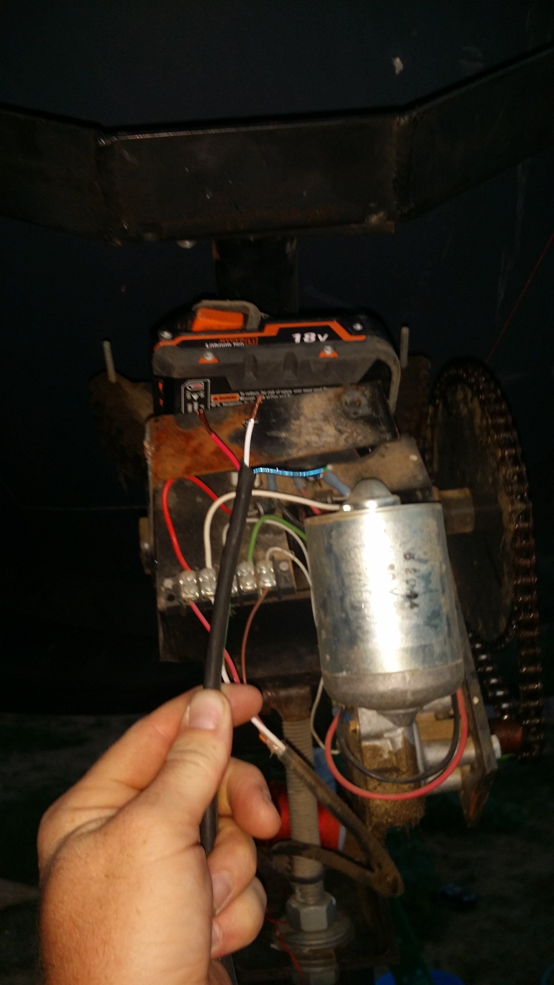

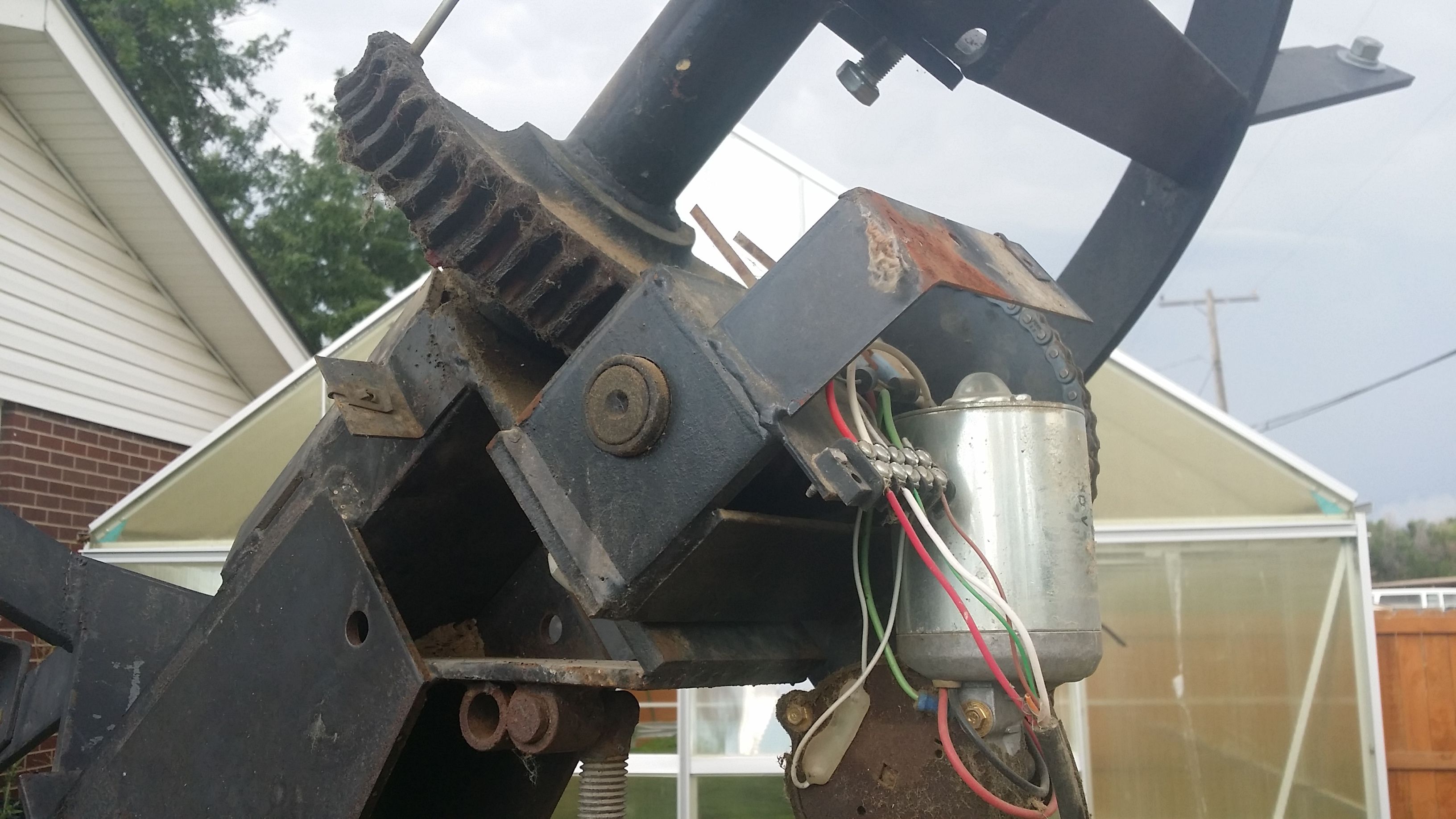

And it gets even better!

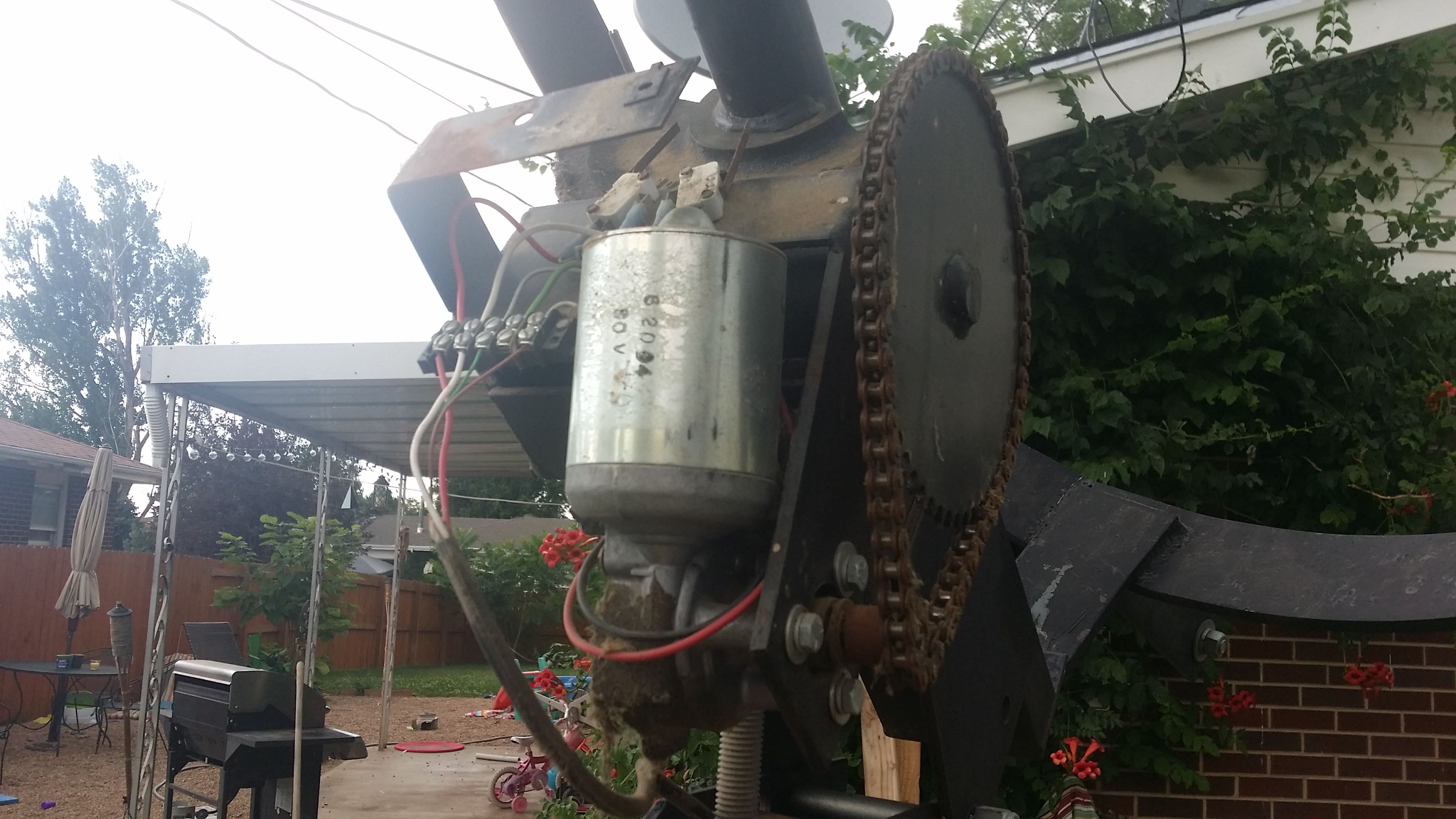

Look at the guts. In WONDERFUL shape!
Why can't I be so lucky???
I don't think there's an HtoH mount within many hundred miles.
Reason, My Von Weiss actuator is starting to show it's age.
That would be 30 next month.
Looks like the only thing to do with that HtoH mount is soak the chain in oil for a day. That's so minor it makes me want to (deleted- don't need to make anyone else sick here) Any way,
I knew the day would come, that mine would develop 'symptoms, so have been keeping an eye out for an HtoH for quite a while.
Enjoy your new found beauty there, I know I sure would if I were so lucky.

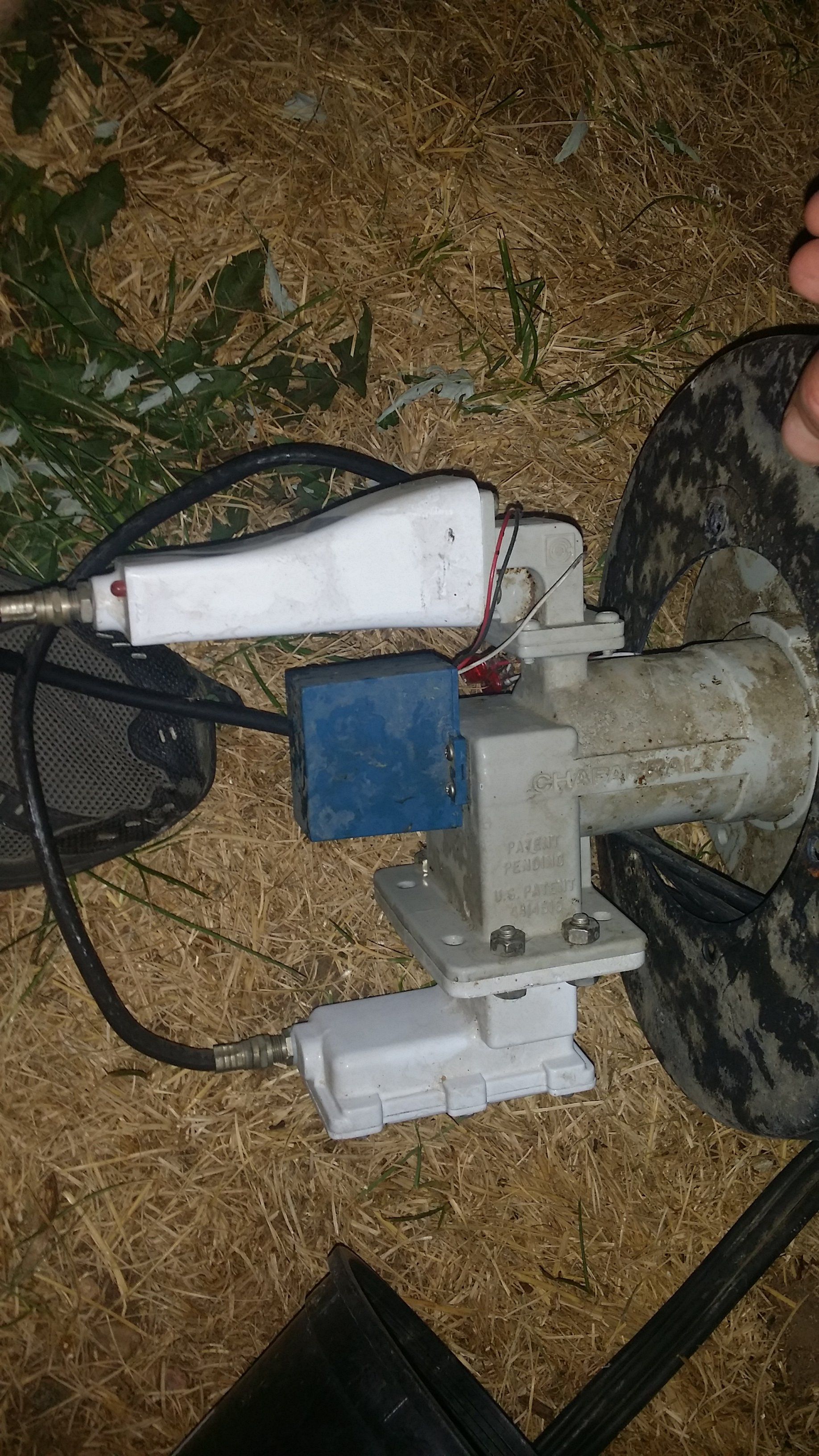

After looking at the LNBF its a C band KU combo.
Cool!
I'll still be using my C2W-PLL.
Now if we can talk Brian into coming out with a dual port KU/C band LNBF....
Come down to Colorado. I know there are more. I'll save one for you lol.
The picture of the chain makes it look worse then it is. Little oil there and a bit of grease on the pivot point and shes good as new.
The grease on the chain is still red. One little issue, not sure the impact on performance, where the dish mounts to the ring it is dented in a bit.
If she wont say popped out I figure a large washer should hold her down.

Anyone have an easy way for me to move the motor center so I can nail the 97w tomorrow?
Thanks
I've used anything battery wise that are 12 to 28 volts. Marine, car, portable drill, whatever is 'handy'. Sure , they're slow with only 12 volts, but it gets the job done. Couple of time even wired two 12 volt batteries in series for 24 volts.
Note, they may draw more than normal current at 12 volts. so monitor the motor temp with your hand. Warm is fine, burn, let it cool.

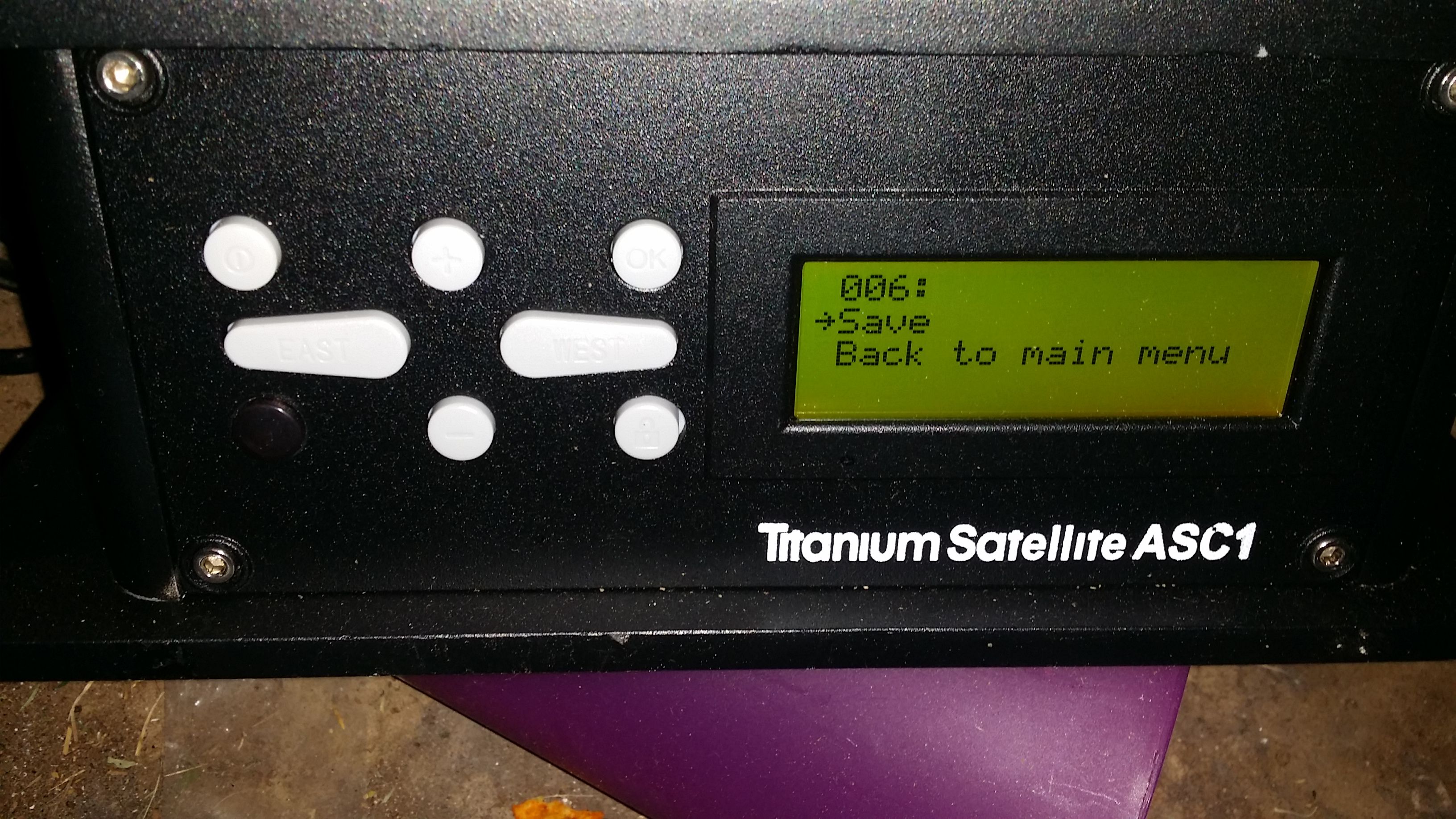

OK I'm dicking around with my ASC1 and slowly getting this thing figureed out.
have loaded
116.8
113
105
103
101
Any faster way of loading these things? Seems I cant come up with an idea of how many clicks per degree.
Also any better way of finding a strong transponder then looking at satsignature.com
and sathint.com?
Thanks

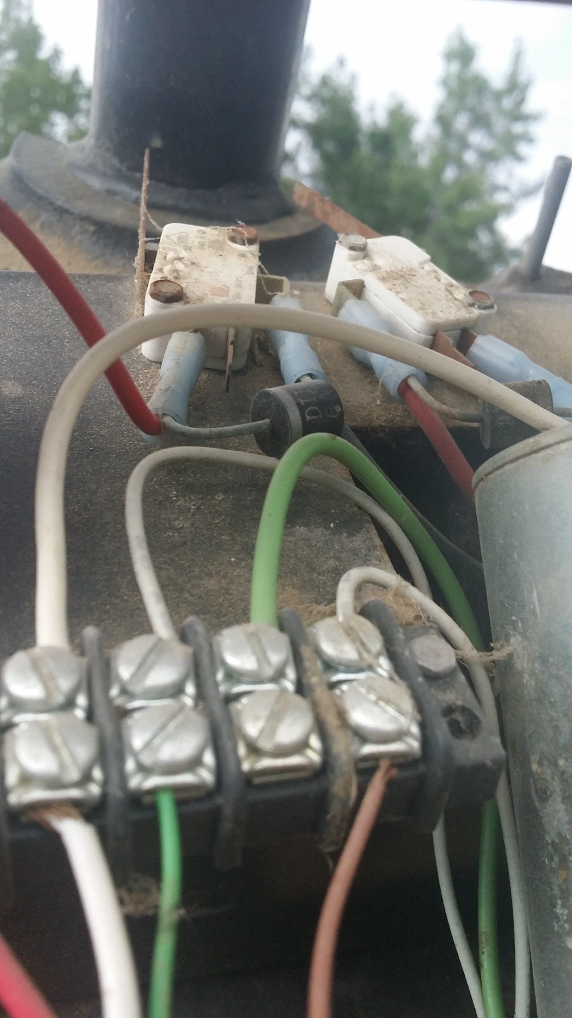

For some reason I can not go anymore then 101W to the east. No 99 no 97.
Any ideas?
Dish is not perfectly tuned, 3715V 4775 I am getting about 62% on the 101W, she is working and should be well enough to program my ASC1.
Thanks

What do you mean? Are you saying if you try and go farther than 101 you get an error?
If this is the case than, I would check the motor to see if the physical (Hard) east limit is set at this point.
You may need to adjust it so you can go farther East.
Reactions: hank123
oh no I can go all the way east and west no problem. It hits the hardware limiters without issue.
I cant seem to find any satellites to the east of 101w. I have tried several times on the 97w and 99w. Cant tune them in.
Not sure if the declination is off, I pick this thing up about 40-50 miles dead south of me, seems to track ok to the west. Have not hit 139w yet.
Oh, ok I got ya. :)
Yep, tuning is still off somewhere. I would say that unless it was wrong before you got it, the declination is ok.

Hank, do you by any chance know what brand of dish the big grey one is? I sold a lot of dishes in my day, but I don't think I've seen one like that one. It resembles a UFI in a way, but the pattern on the face of the dish is unusual. I saw some "foam" dishes several years ago that looked similar to that one, but never used them. I kind of stuck with UFI, Kaultronics, Unimesh, Winegard, Paraclipse and Perfect 10.
It is a Paraclips with a Ajax motor.

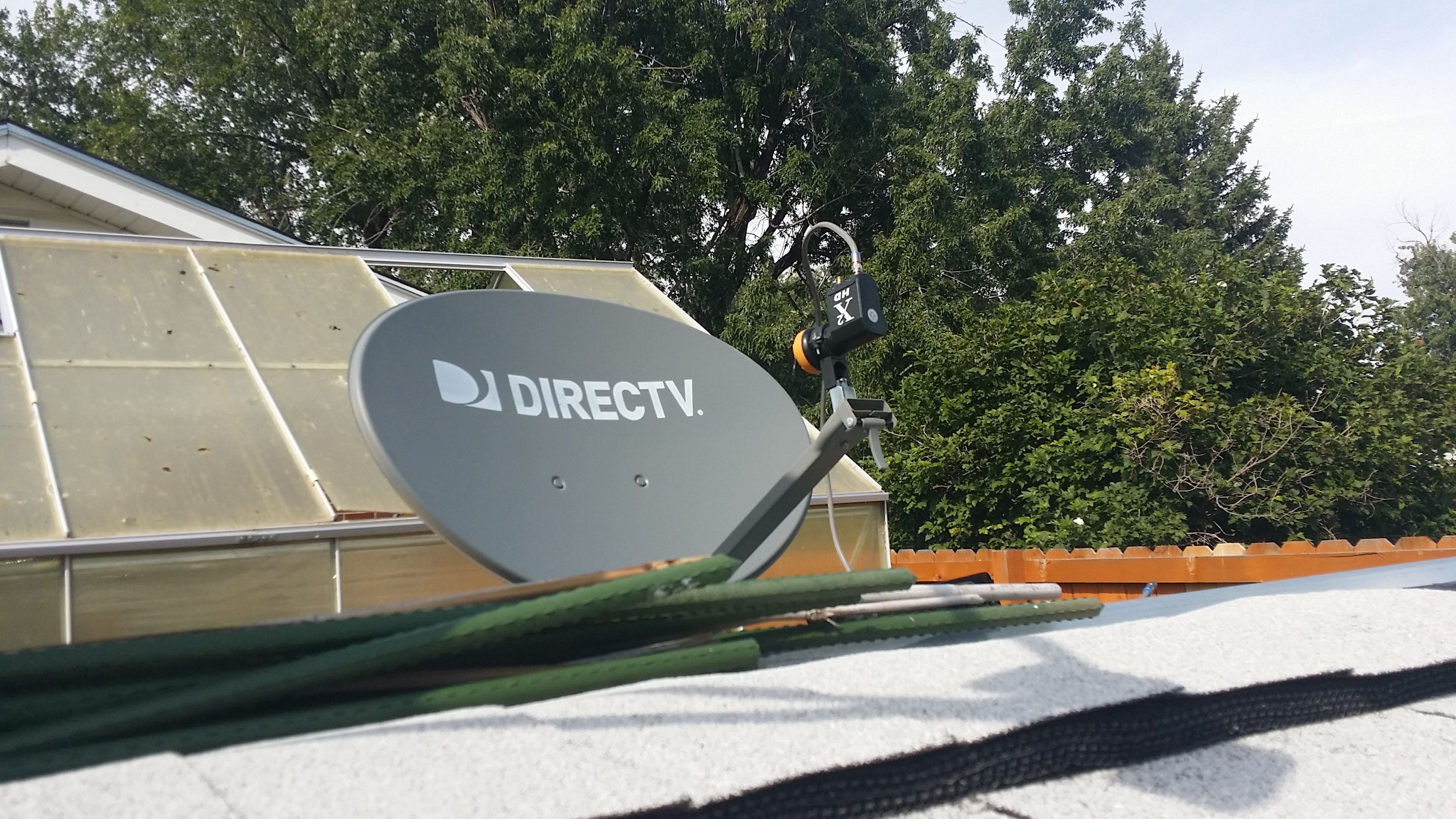

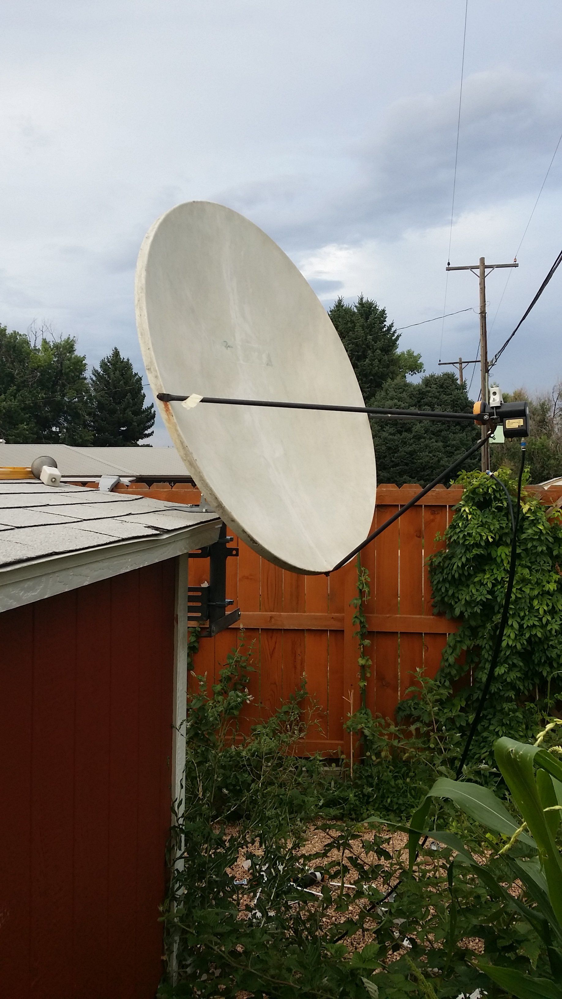

I am starting to stack KU sats. Used a Directv Slimline today for the 97W and it is smashing!

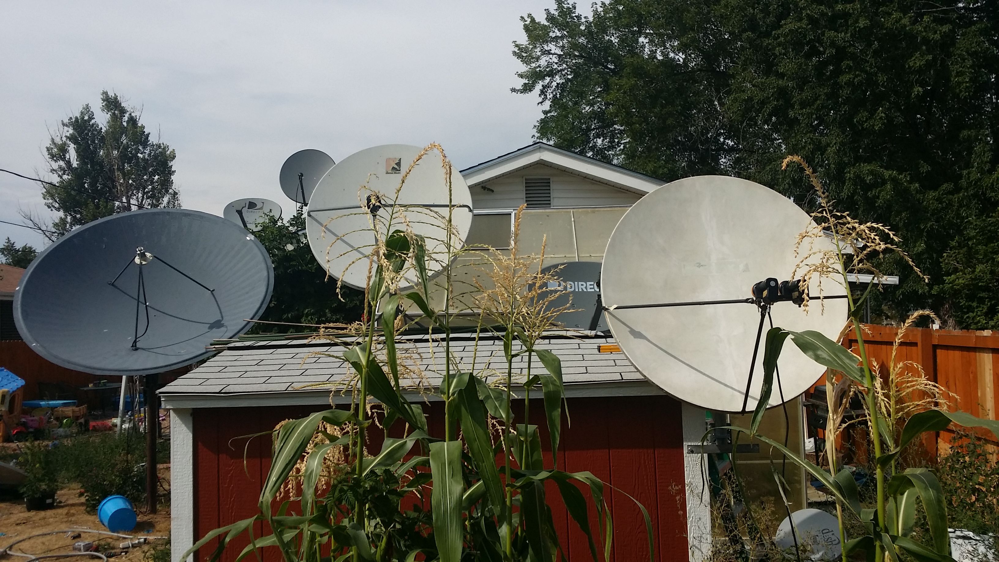

Nice job on your dish farm there. Why is your X2 ku lnb upside down hank?
Thanks its been a work in progress.
Because right side up and the coax will not clear the arm. Could cut off part of the arm... The other option is to have the lnbf sitting almost the right way and adjust the skew on the dish to zero her out. Not sure how this would perform.
The slimline hits well, ill have her hit other stuff as well to see the performance. Its great having fine tuning.
Works for now.
Still have to build to the farm. More to hit in the sky.
