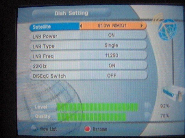

make sure to power off the reciever on the back before inserting a switch as to not do damage to the switch.
Hook one dish to port 1 of the diseqc switch and the other to port 2
IN the menu setup go under "dish setup" and at the bottom of the list it says "diseqc setup". Change it to correspond to the right dish.
So (example) if you have a dish at G10 on port 1 and a dish at IA5 (G25) on port 2, the settings would be diseqc 1 for G10 and 2 for IA5

Iceberg, Thanks for the reply and the pic.
Since the post, I found if I use ports 2 and 4 it works fine.
