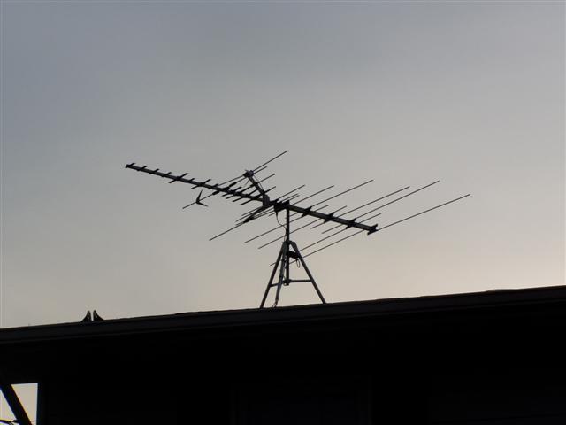

Just installed the hd7082P combo for the parents. see picture below. do not need to mount real high. if you get a bad storm you take it down temporarily.

here is a few photos of my nearly 20 year old winegard antenna that i was talking about. have you seen this model before?
I am not familiar with that antenna.

Jim5506 said:
Do you have a ceiling mounted projector? 'Cause that antenna looks upside down!!
Hey Jim
i have to agree with you,that antenna does look like it's upside down.
