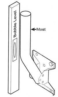

Here's what everyone is recommending you correct, the mast/pole that the dish is attached to must be plumb/level.

Also the pole where the dish mounts is not the original one that came with the dish. I had to use a shorter one because the other was damaged. Can this offset my elevation?
As long as the diameter is the same** it should be no problem.
**to hold the mount 'square' to the pole.

Hey guys. thanks for all your help I was able to get a the quality to about 50%. I look again at the pole again and it did not look right. It was too small for the dish and it was sitting too low. I fixed the original pole that was damaged and remounted it. After this, I was able to get about 30% quality. I did some tweaks and only got it to about 50% which is good i guess. Did an auto scan and found 28 channels, then did a blind scan and found 42. There is one channel though that does not have any video, which is " Canal Havana ". Any ideas why?? But the main two I wanted to watch are perfect!! Thanks for all your help!!
