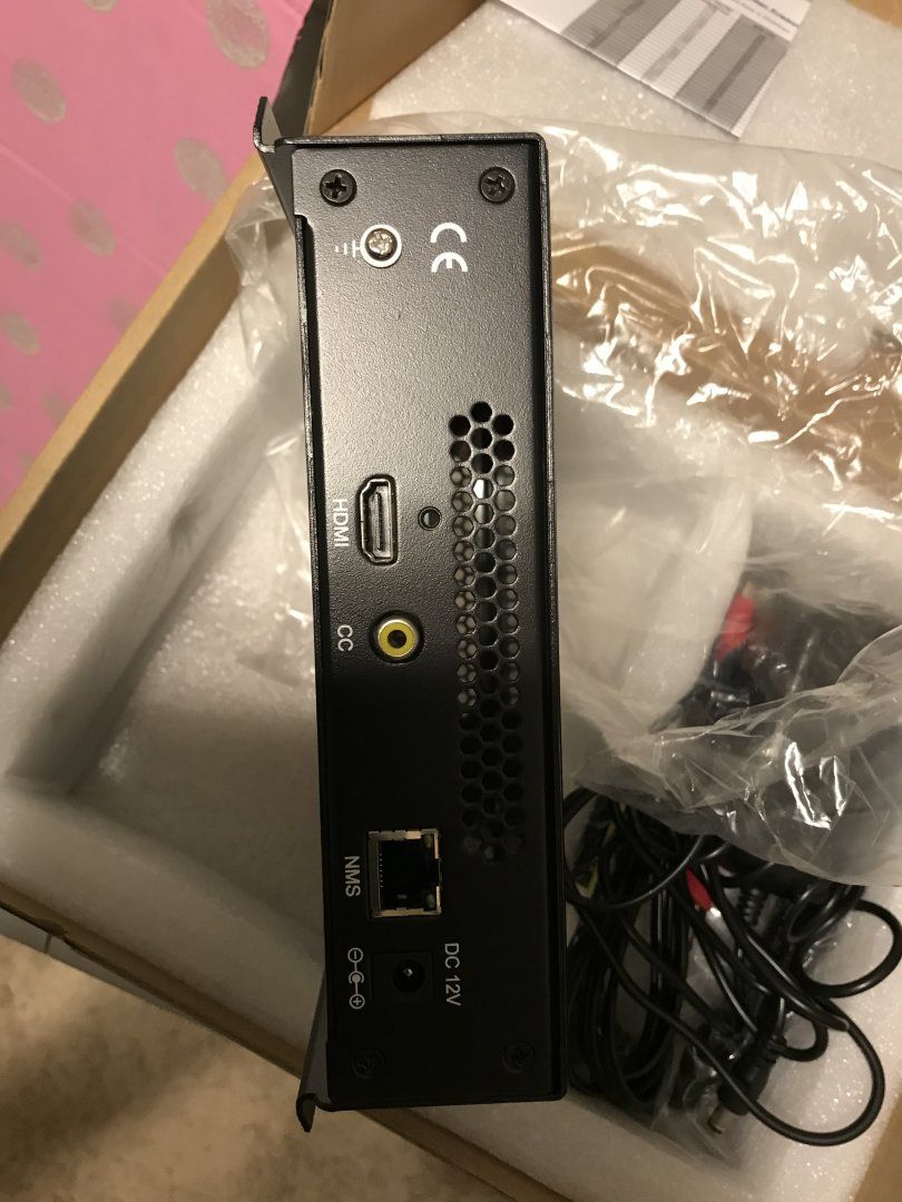

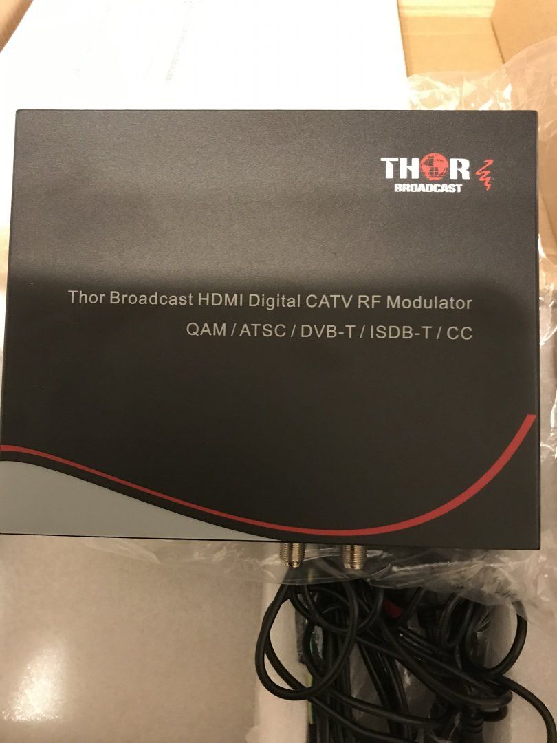

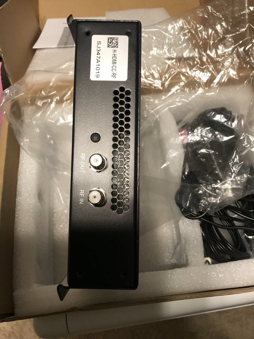

If you're interested I would sell the two Thor Broadcast modulators I bought last year. After this discussion I decided to pull them out this weekend and give setting one of them up a shot. As soon as I plugged it in the wife immediately vetoed it going where it needs to go to access the TV cables because it makes noise. It does have a fan (it isn't unreasonably loud, but it is noticeable when it is running). I guess if I ever get around to actually setting something up I'll have to buy the fanless versions.

Would ya shoot a photo of one over, front and back for grins?

Here are some photos I took tonight. I sent you both a PM with some other links too, but for some reason you can't "attach" in a PM. If you're interested just make me an offer. I bought these as a Black Friday Special, so I didn't pay the website price you likely see online for these.
