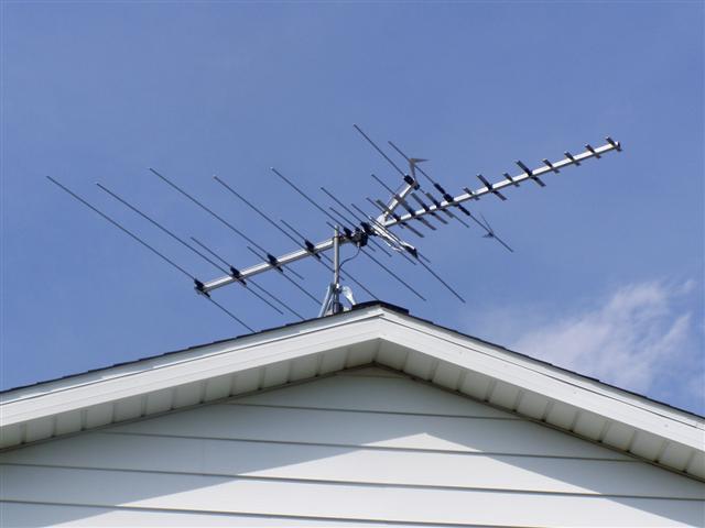

the cm4228 will work for ch 12 but not as good as with a vhf/uhf antenna. We have a ch 12 locally and tested the cm4228 for it. the signal level on my meter favored the hd7082p vs cm4228 for those interested. The cm4228 perfomed better on uhf but not much better. They have a ton of hills (foothills of the adirondacks) around them and the cm4228 did a LOUSY TERRIBLE job with the multipath. The hd7082p tamed it nicely and minimized the ghosting on analog.
winegard hd7082p for vhf/uhf with the hdp269 winegard preamp.
the cm 7777 will overload with towers 16 miles away.
below is a pic of the winegard hd7082p with hdp-269 installed this past friday at the parent's home distributed to 5 tvs and no distribution amp. Was a beautiful day 75 degrees.
Mom freaked alittle..."what are the neighbors going to say...take it down! Its too big!"
